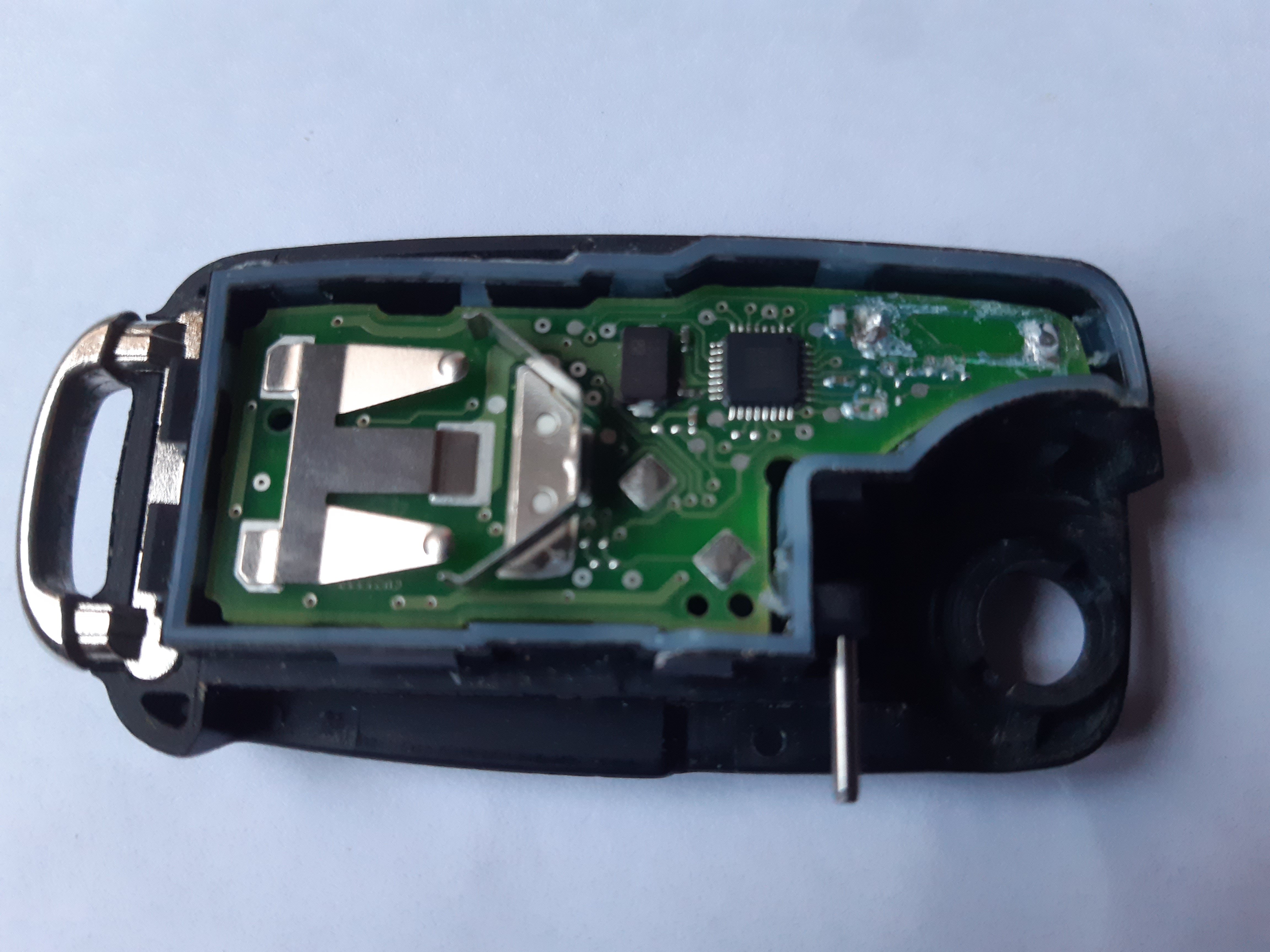

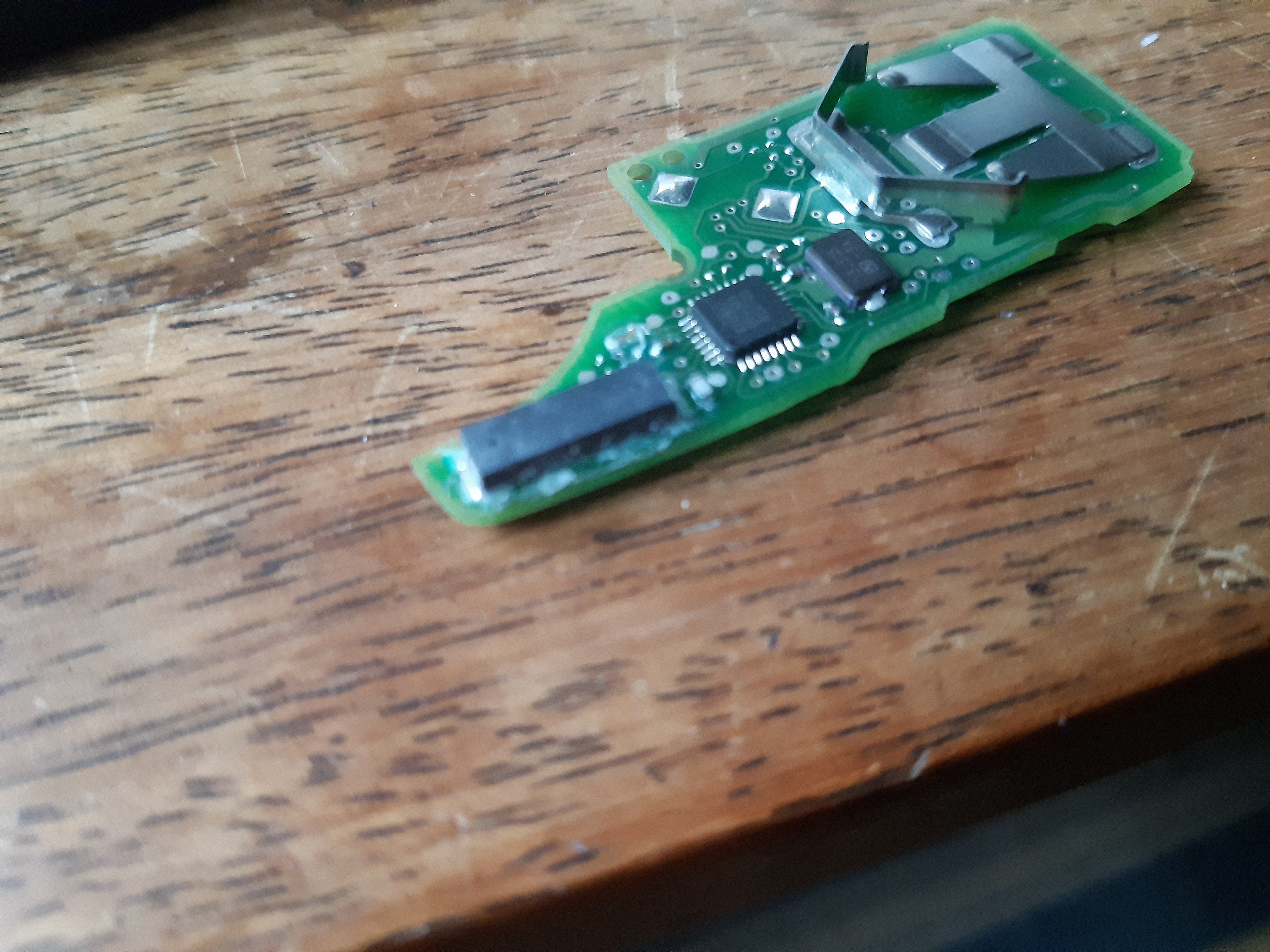

I only got one key with my 2012 Superb. I've bought a couple of 2nd hand flip key fobs and had new blades cut. I've programed the fobs to the car with VCDS so I have keyless entry.
I've removed the original transponder chips from the PCB's but not sure which glass transponder chips I need to replace the originals with? To clone my existing key, ID48 TP24 ? Though I'm not sure if this the correct chip? Depending on where I look they are described as being for cars pre dating mine.

The key number is 3T0 837 202 H on all 3 flip keys I have. I just want the correct transponder chips. There seems to be quite a few different ID48 transponder chips.
