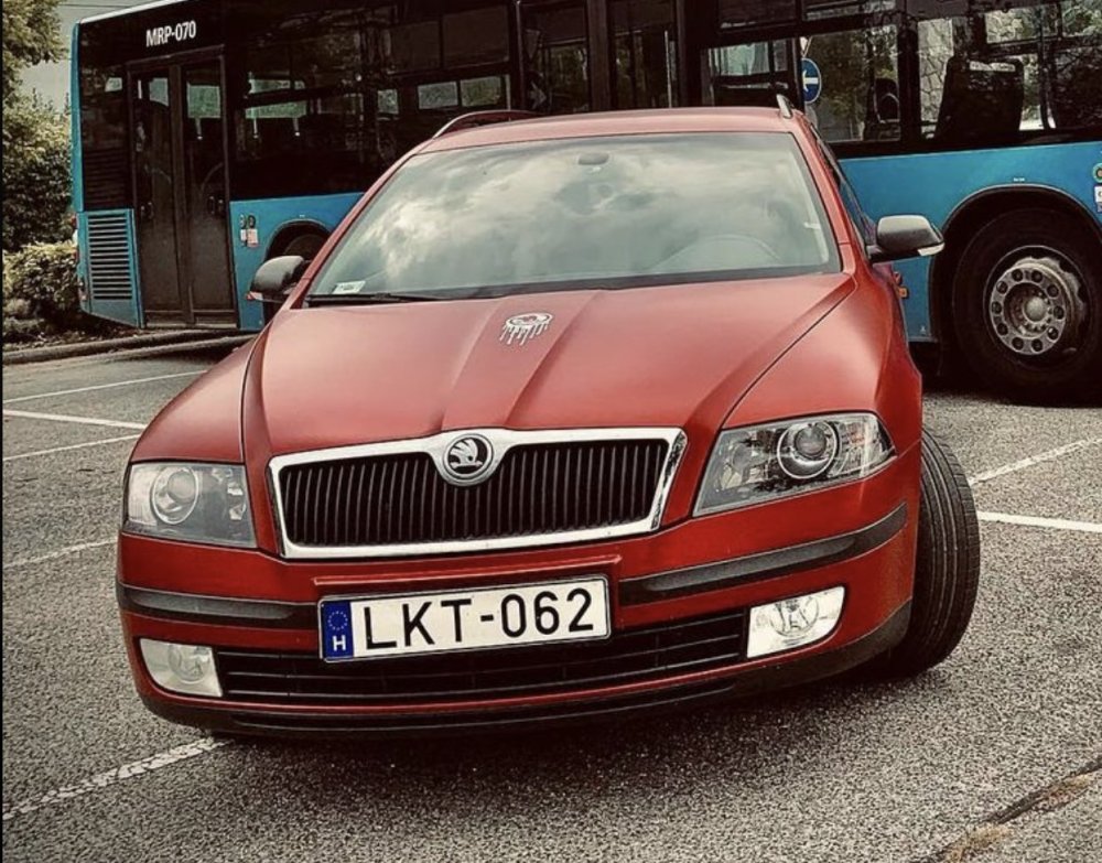

I moved to the UK from Hungary in November and my Octy is following me this Saturday. I'm importing it, of course. My following questions are:
1. Am I able to swap the LHD headlights with UK RHD ones, so that I don't have to use those uggo stickers?
2. Is it possible to replace the EU instrument cluster with a UK one?
  1. That depends on your headlights. Some models can be adapted from wrong hand to left hand dipping but others need replacing.
  2. UK law demands that your speedo displays in mph. I'm not sure that you can do the adaption with a sticker.
You will, at minimum, have to have the car UK MoT tested, so why not talk to an MoT centre that suits you about the requirements?
If you are determined to import and retain your cherished car, I would swap the headlights and not bother with the instrument cluster, just be aware or mark off UK speed limits or equivalent Kmh on your speedometer.
If you have the maxidot cluster then you can enable the second speed display and it will show a digital MPH.
Headlights are dead simple to swap and very cheap, its a shame because until quite recently I had my old RHD pair from where I converted my Octavia é, my last car, to LHD headlights, I sold the land my garage stood on so they went to the dump together with a lot of other stuff, no point in bringing them over to France with my tools etc.
