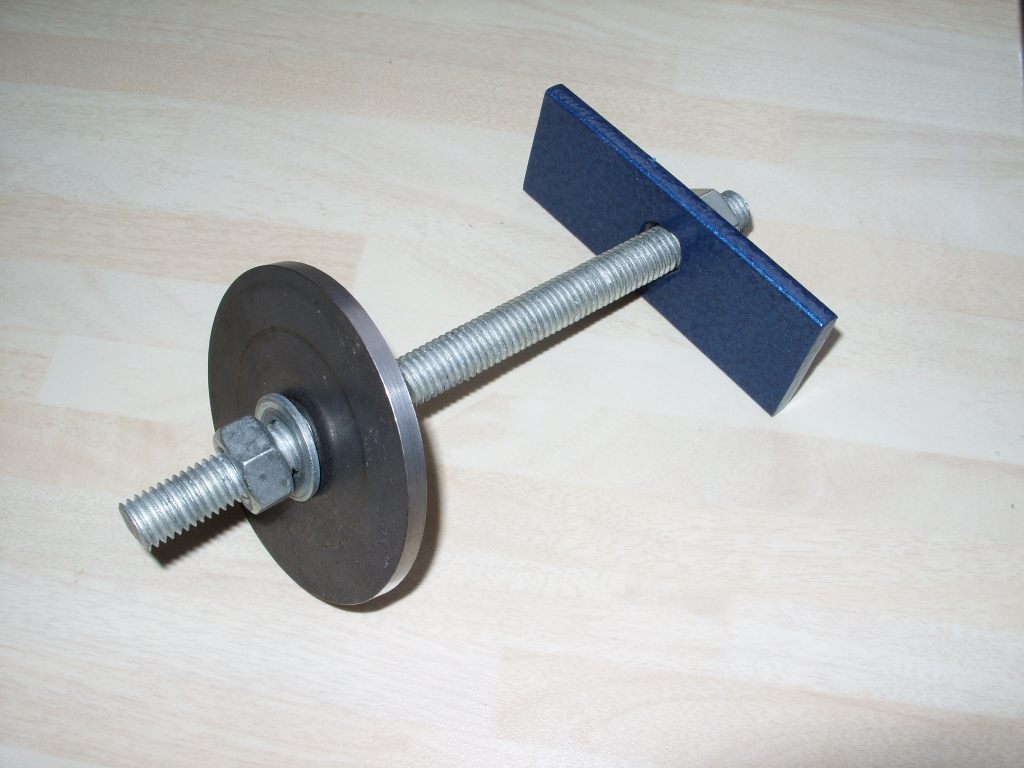

I made my own tool to install them...
Edited by TMB
