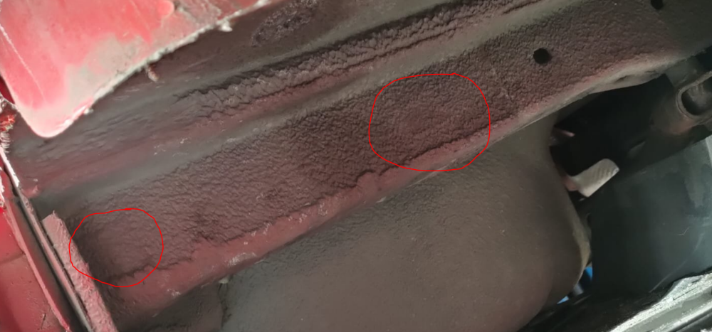

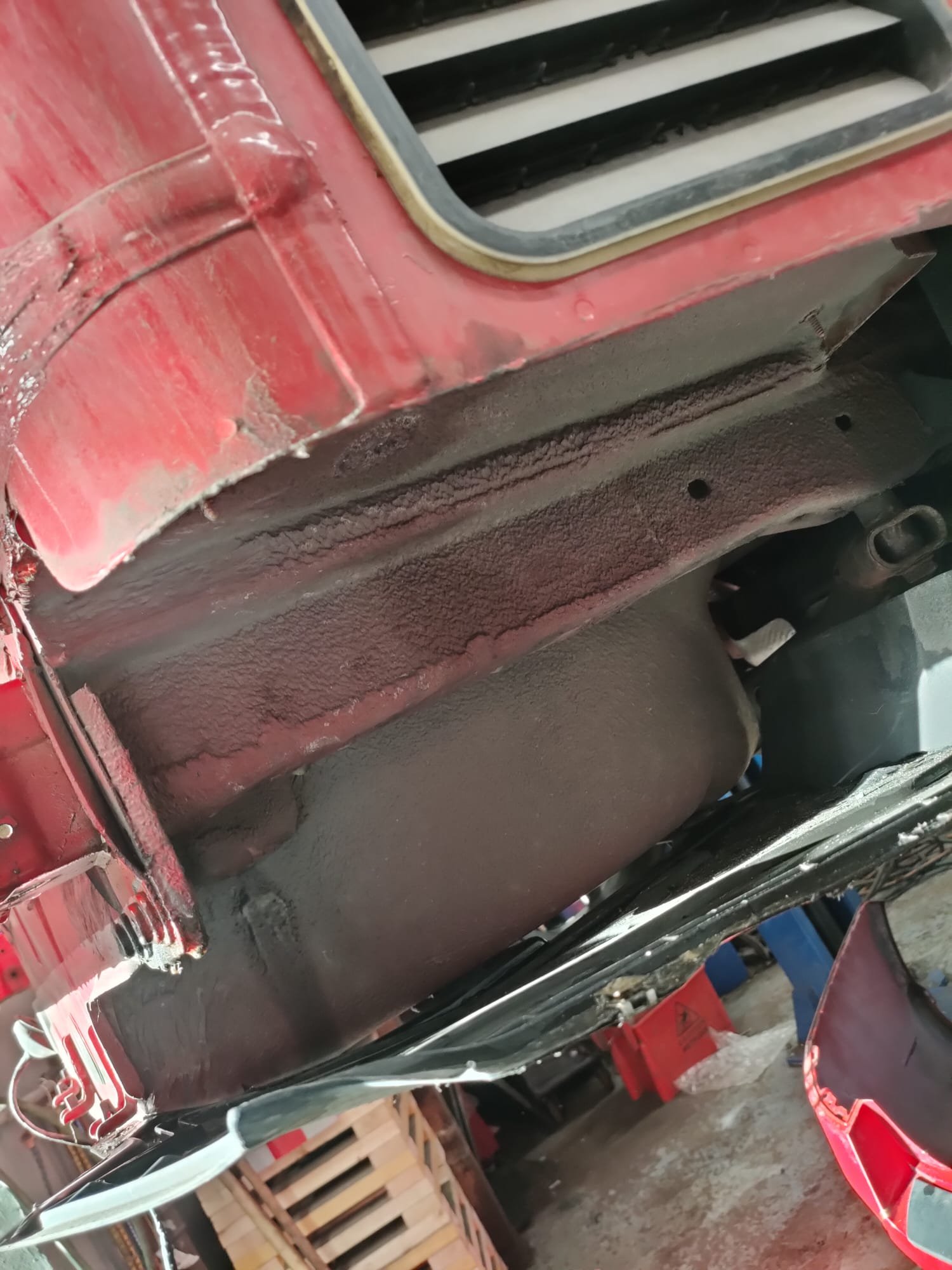

Hi im having problems getting a tower fitted to my 2014 vrs octavia estate .
I have a wWesfalia tow bar part no 317312  which is the correct one for my year car. I have checked and triple checked.
my mechanic removed bumper and put tow bar inlace but I don't have the pre drilled holes to screw through to the tow bar .
is my mechanic doing something wrong , he was looking to screw strait through from the side into the tow bar . but as I am looking at the tow bar
im I right in thinking the screws would come through from the other side ? any help guides or photos would be much appreciated .
doesn't have to be from a vrs just from a mk3 octavia.
here is a photo of were it should attach
Edited by martinpix
I don't know if this is correct but have a vague recollection that the pre-drilled holes are covered with tape and then sprayed over with underseal and paint at the factory - si they are probably there, just covered up and need to be found...
This thread should help:
Edited by skomaz
skomaz has it right.  The holes are there - just cunningly camouflaged.
The holes are there, shine a torch down the inside and you will see them.
They are hidden by square stickers and covered with the underseal, there are some promising looking patches on your photo. I know they are well hidden, I fitted the OEM bar to my vrs last year.
Edited by simion_levi
Same as all the VAG platform, small stickers are placed over the holes before painting, just need to find them and peel them away. I was stumped at first too :D
