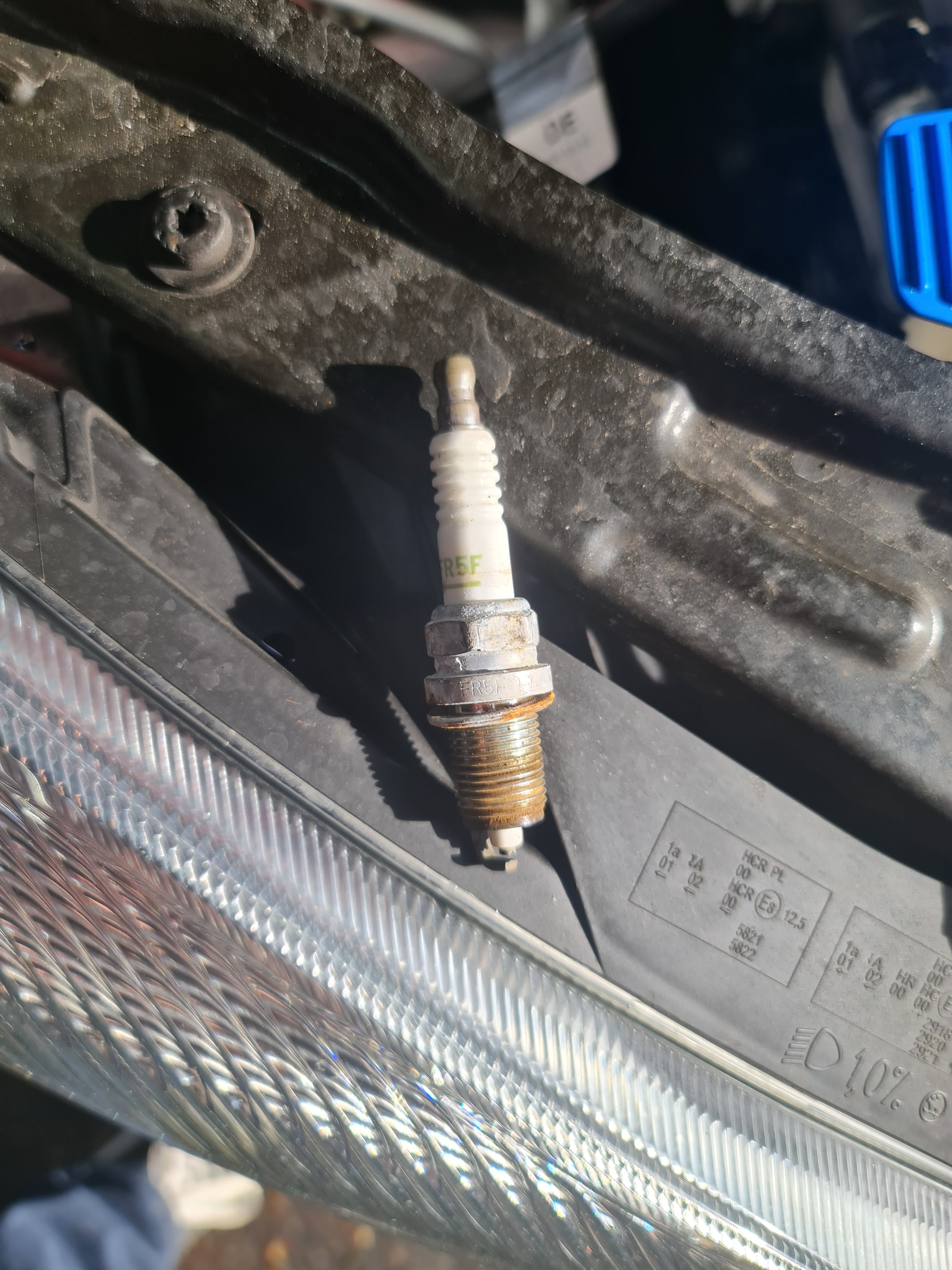

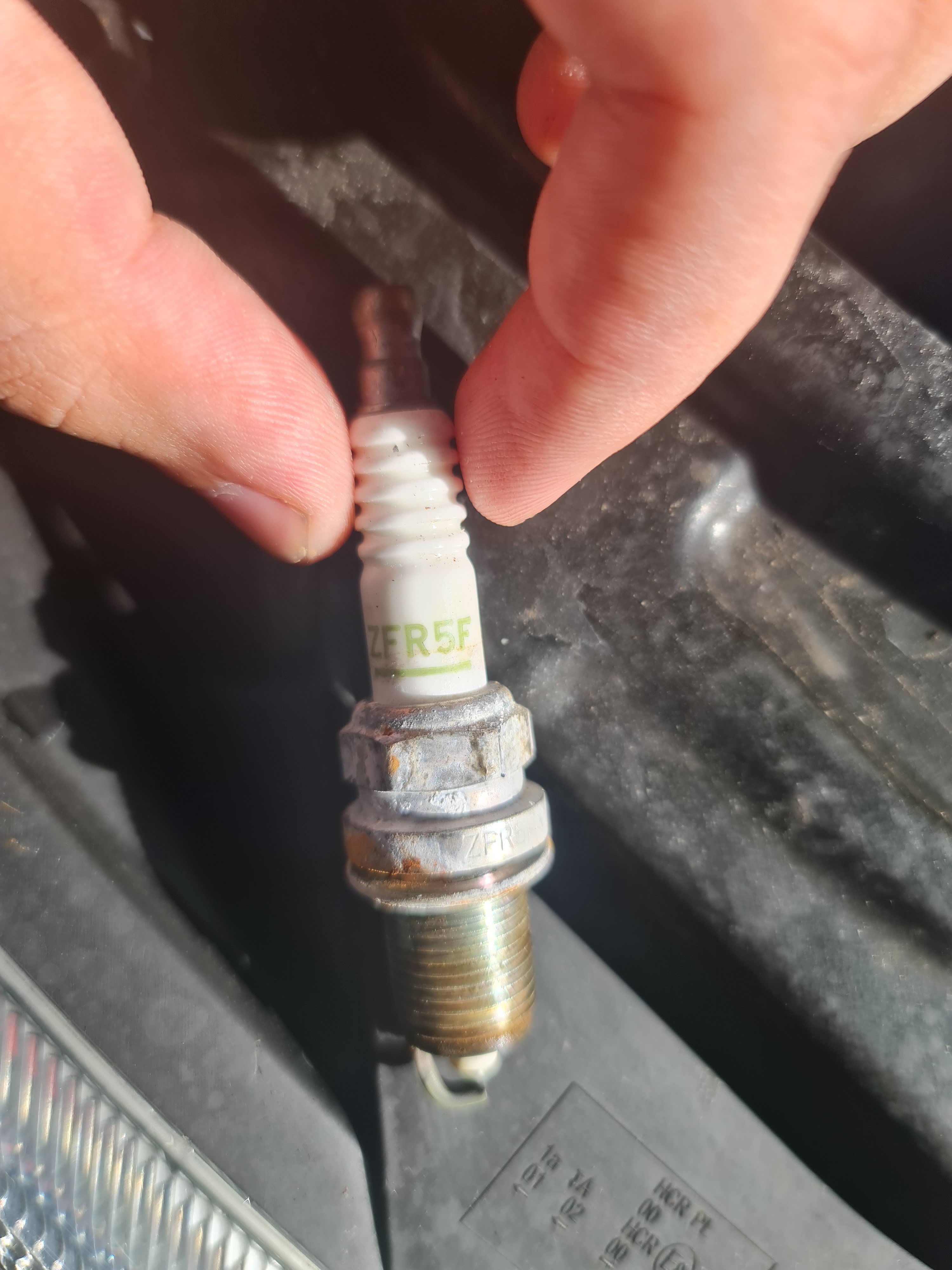

Update for anyone following this specific juddering issue:
Changed the spark plugs to what eurocarparts gave me in the ngk label, went to the only shop open on sunday and 20 minutes later no more juddering! Straight to the first A13 ramp in 7'th to stress test them, and until today i still can't wipe the smile off my face.
The old fitted spark plugs had the thread and overall length about 3mm shorter and some carbon electrode. Looking for the serial number, they seem common on vauxhalls, hondas, mazda, really general purpose plugs that somehow managed to work on my car too.
Shop was a tyre repair place in plaistow, one man band mechanic over there, really nice old man. Wanted £15 for the job, gave him £30 and told him i'll come back for tyres soon.

It's the IZFR6P7 plugs. Really the only ngk choice when the number plate is on there. Completely forgot to take pictures comparing them side by side. Longer thread and total length, sharper electrode, nice and shiny
ZFR5F is a totally wrong and unsuitable plug for a 2013 1.2tsi. In addition to being too short, they are also the wrong heat range. Hopefully the cylinder head threads arent damaged at the bottom end. Whoever fitted them was a fwit.
Correct plugs are
NGK IZFR6P7
BOSCH FR 6 HI 332
Skoda/VAG 03F 905 600 A
They are an iridium alloy fine tip centre electrode with a platinum insert in the ground electrode. Ultra hard wearing plug needed for TSI and the waste spark ignition system which wears the plugs much faster than individual coil packs.
Glad you got the car sorted, a good lesson to others not to jump to conclusions about their DSG without eliminating other simpler causes, in your case the duff spark plugs causing juddering which confused the DSG.
Well done
Thanks!
I did run it like this for a while, and presumably plenty of unburned petrol found it's way to the cat and into the oil, but as long as there is no measurable oil consumption and no funny noises (besides the dashboard rattles, of course), i guess it's undamaged.
I assume whoever prepared the car to be sold did the change without any care for what the car needs, topped up the oil until just over the highest mark, changed *one* front tyre to whatever spare size was in the garage and signed it off as the next guy's problem
