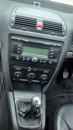

I own a Skoda Octavia mk2( in India its called Skoda Laura Type-1)
It had the default STREAM audio( green display)

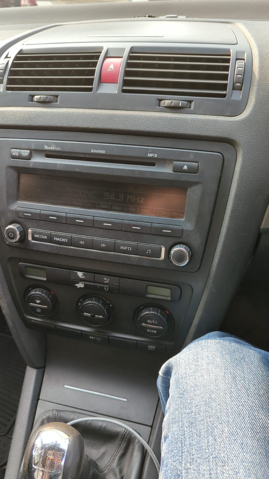

Now I have replaced it with the new SWING audio system
1857323084_WhatsAppImage2022-01-07at3_40_39PM.thumb.jpeg.86ae76f66a73b9ac3a41c2e84d00cf72.jpeg
 Earlier when I used to engage the reverse geat the diplay used to show the car symbol and I used to get the parking snsor signal bars and beeps.
Now, after installing the SWING audio, when I engage the reverse gear nothing happens.
I hear a BEEP when engaged, follow by a long beep(around 2-3 seconds), no car icon on the display. But I sometimes get a LONG park sensor BEEP when close to the object.
Please take a look at the atached video to undertand the problem. Help me find a solution to this, thank you all in advance.
