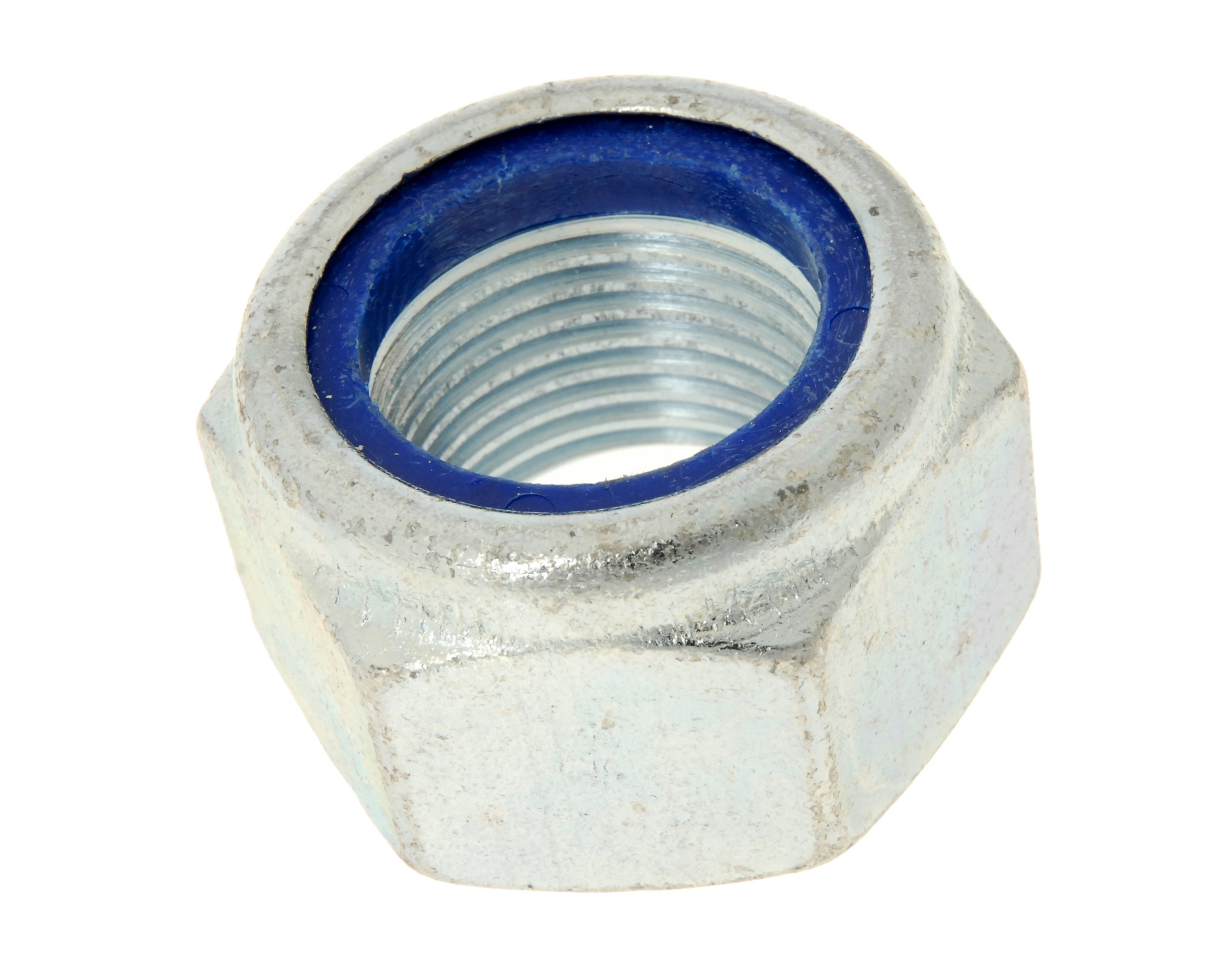

Alternatively, replace original nut with a Nyloc nut. (as shown below)
A2 Stainless Steel Nyloc Nuts DIN 985 M3 To M30 - M24
Hi Alan
It's hard to tell from a photo, but the original nut might be the type that relies on being slightly deformed to an oval shape ("stiff nut"), or it might be peened on with a punch.  Neither of these is as good once movement has happened, either accidentally or deliberately
I agree with Carlo diesel, and recommend replacing it with a nyloc type, making sure that the thread goes all the way through the nylon insert.  A dab of paint or nail varnish will then act as a tell-tale for any unwanted loosening

The double-nut or replacement nut idea seems like a good one, but I am paranoid about removing that nut now just in case the collar slips and I lose the gear alignment again. Also, silly question I know, but how do these Nyloc nuts work? I have never fitted one before so what causes them to lock in place, and how easily can they be removed once locked?
A nylon insert that tightens on the thread.
