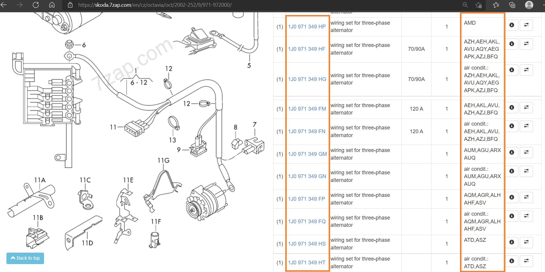

Has the melting compromised any of the smaller wires, or just the fuse end of the thick one?  If just that, I'd be tempted to get a replacement made just for that. 25mm² conductor area cable, not much longer than the original, and I suspect a 6mm ring crimp at fuse end, 8mm at alt end (**check these**).  Needs a good/appropriate crimp tool, so probably better to get one made for you at a good motor factors or via ebay (e.g. 170 Amp 25mm² Battery Power Cable Starter Earth Custom Made Car Auto Connection | eBay).
Can just disconnect and tie off the original at both ends, and strap the new wire to the old loom with tyraps.
New whole loom may be unavailable or expensive; 2nd-hand may be degraded.
There's probably a part number on a label on the loom somewhere?
If not you could work it out from here, by finding out your engine code (see right hand highlighted column) and reading off the appropriate part number in the other highlighted column.
173766593_Screenshot2022-01-2015_27_29.thumb.png.52e18e409ae193ef1b3e1b15d16add74.png

thanks for the info, it looks like I need 1JO 971 349 FQ
