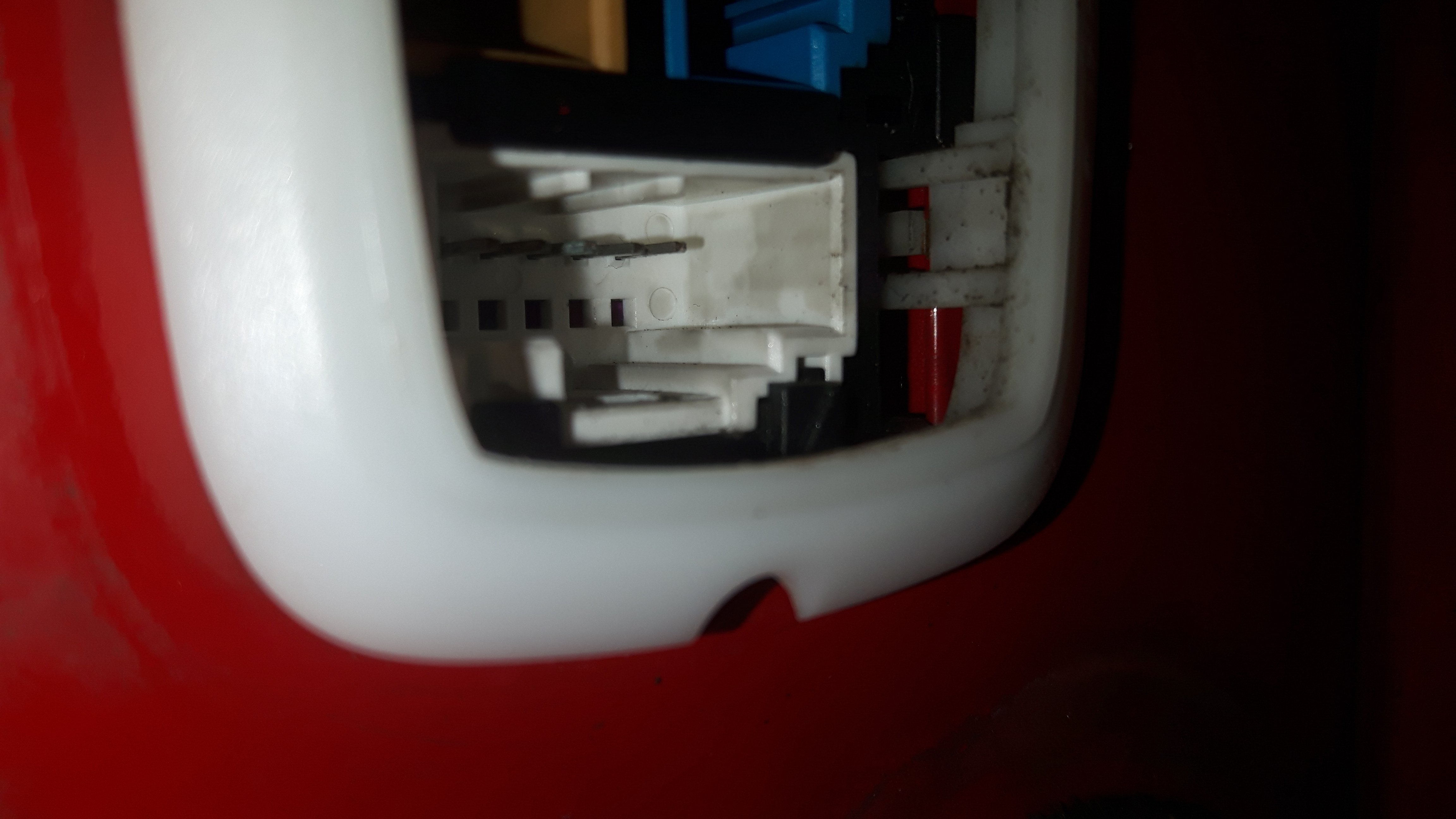

There are a few connectors, but you probably don't need to undo them for a looksee.
The effort-saving trick is to pull the rubber boot off  the a-pillar with the white plastic frame it fits to.  (I've failed to do this in the photo below).
You do this by squeezing front and back vertical edges inwards; ideally simultaneously, but if that's not achievable, focus on getting the front (nearest front of car) edge free first, as then the rear (nearest back of car) edge is relatively accessible and easy.
If the rubber boot comes away from that frame, be sure to get the frame out before refitting things, as it's much easier to refit boot to frame out of situ, rather than in situ.
The frame has four catches, two each side, you can see one on the right side of this photo:
