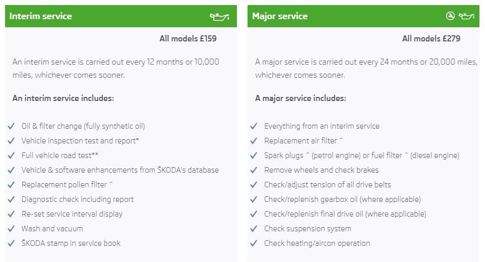

Is there a Pollen Filter change included Year 2?
An Air Filter at 4 years / 40,000.     Spark Plugs, DSG Oil change.
What about missed stuff due at year 3 if no Service then.
If a Petrol TSI or Diesel TDI then it does just need 2 oil changes in 4 years if under 40,000 miles is covered.
IF LEFT SET ON VARIABLE SERVICING AS YOUR HAS BEEN.
(A Hybrid needs more like 4 oil changes in 40,000 miles.)
Not much done year 2 or 4, but you would want the Year 3 stuff doing.
So it it servicing in your plan year 2 & 4  or just year 1 /9,400-10,000 miles and year 2 /18,000-20,000 miles.
So does the Service Plan not just show 2 fixed service services, year 1 & 2.
    Oil & Inspection services?
even,
Just a Oil & Filter Service & an Oil & Inspection Service.
1168293554_37335614_Screenshot2021-09-14at07_38_18(3).webp.ee5b8a609f78b3b2f42441d7532010fa.webp
Thanks for the info :)
I got the details of the Service Plan in the post today.  It just says my plan includes 1 x Oil and Inspection Service and 1 x Oil and Inspection Extended Scope.  It says contact my local Skoda retailer to book in a service when its due.
So it looks like Year 3 i'm due a brake fluid change at the same time as MOT and then year 4 is the 2nd free service plus spark plugs and pollen filter.

The new Fixed regime is Fixed with Extended Scope year 3.     Variable / Flexible you need to ask about as nothing is clear to see but stuff needs doing & 3 years in the UK, pre Warranty Expiring for many, pre-MOT.
The Brake Fluid is @ year 3 if you want then.
If you are going 2 years to the first service then the Pollen Filter is due then.

Its a NEW car, it had 10 miles on the clock when i collected it.  I bought the service plan which gives me the first two services for £199.  The service intervals look to be variable / flexible as the Skoda Connect app is telling me 707 days for Service Inspection.  Oil change says "Not Found", i'm assuming i haven't done enough miles yet for it to work out when the oil change is due.
Simplest is ask the Dealership Dealer Principle by email if the Service Plan you bought for £199 requires the car to be on a Fixed Service Regime & then the reply will be in writing and from a member of staff that should know and that later the Dealers Owners can not say we got rid of them, they were new here.  Even if they do.
The cars service schedule indicator will be date or mileage (whichever comes first).  It might be set to variable (max 2 years) but you might reach a mileage limit first.
The actual mileage will change depending on how you drive, I think the brochure says can be anything from 9000 to 20000 miles
However bear in mind that most service plans are designed for certain mileages, and if what you have been sold is inconsistent with your expected mileage, then possibly mid-sold so need to get a remedy from seller.   (Take a look at chart posted earlier, does your plan fit with what is due on that, if not you have been sold wrong plan, as going to have to pay for what isn’t covered, but needed.

Capture.JPG.d4b3472c9719ddab217821602b0a27a5.jpeg.45cadeaf036a2c68451c80af540d363a.jpeg
1221833257_Screenshot2020-10-03at13_19_19.jpg.c743b2191e0cb186e97d46c7df84c5cf.jpg.13ba07661c3c8cb4ea7010a9dfafa032 (1).jpg
