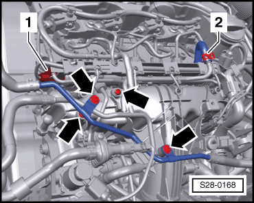

where would i find the fuel pressure sensor G247?
thanks for that, i'll look tomorrow!!

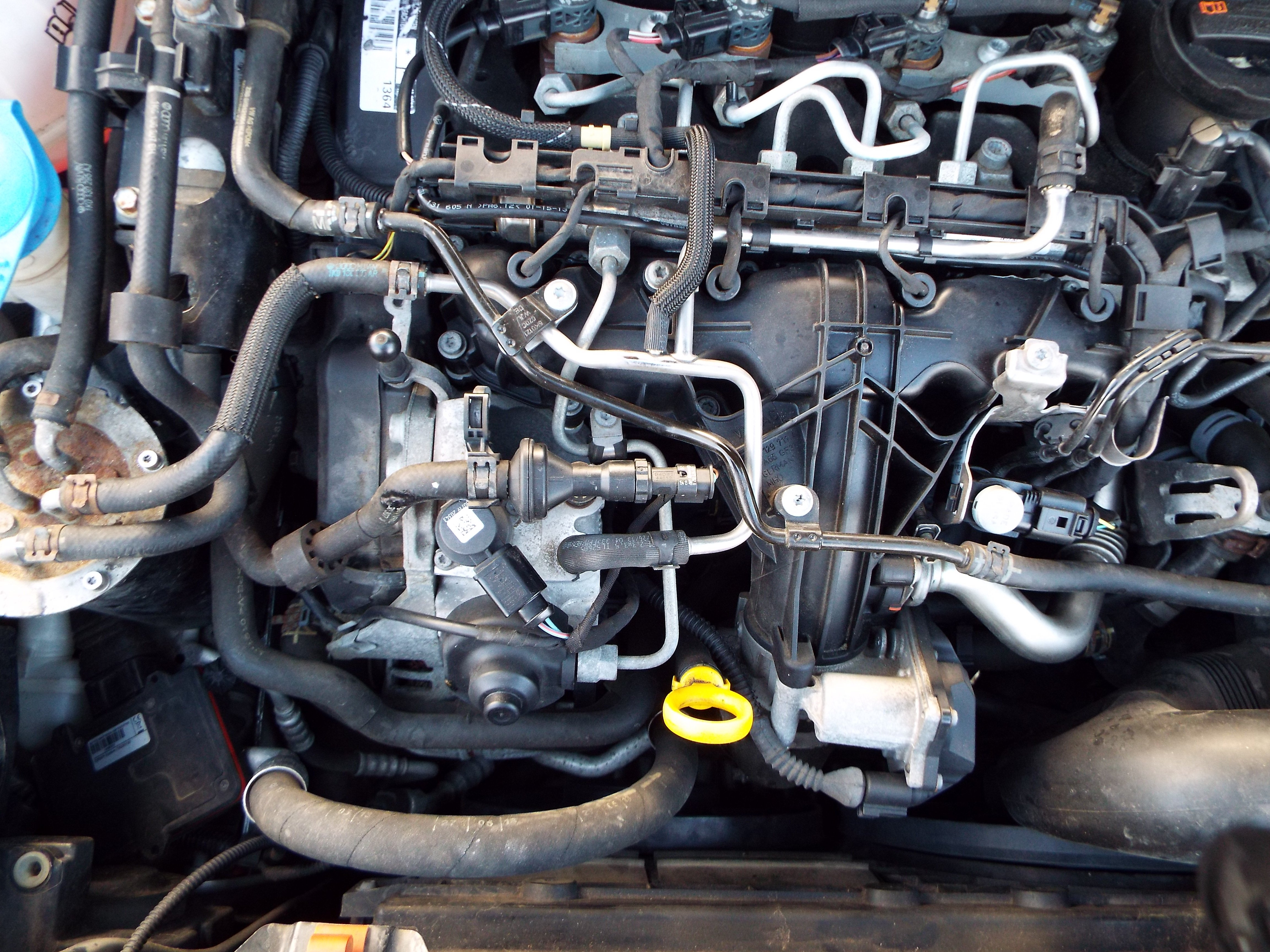

OkNow had a look, and a photo, a bit different to the Langer's link, my engine is a CFHC unit.

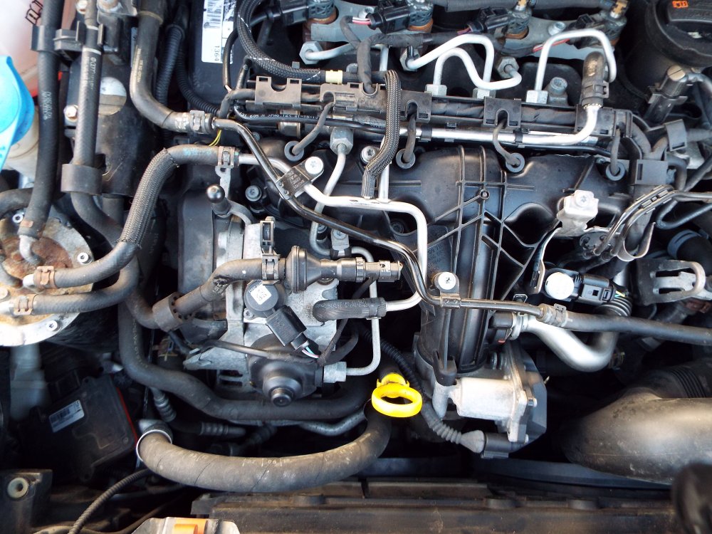

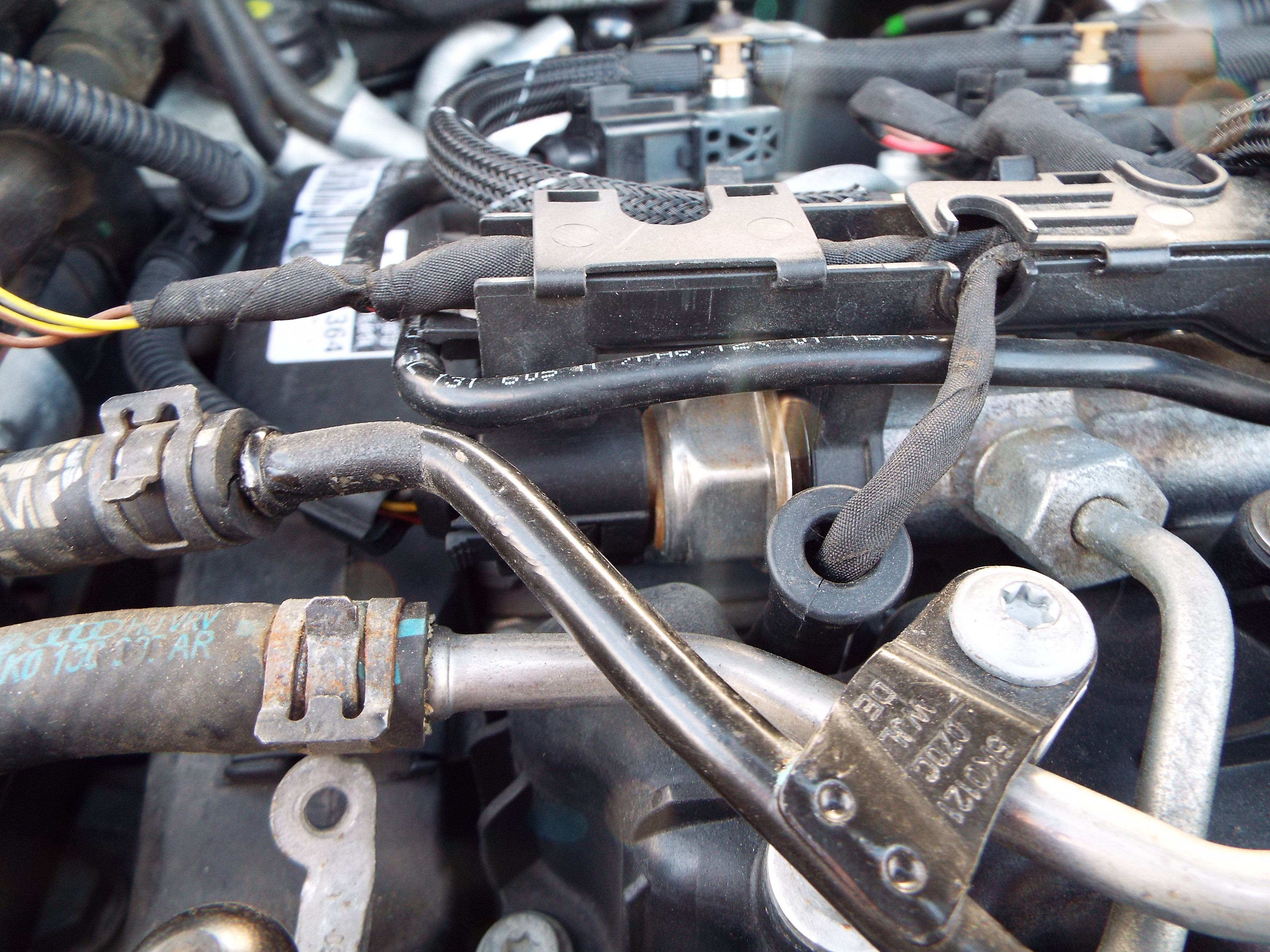

Below is another photo, in which centre stage is the pressure sensor I think, can you confirm please Langers?
Edited by Frenchtone
Looks to be in the right place and connects to a fuel rail so I'd say yes :)
