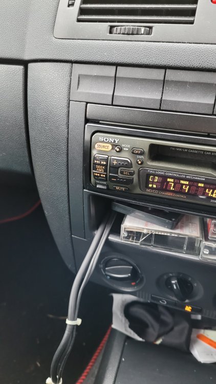

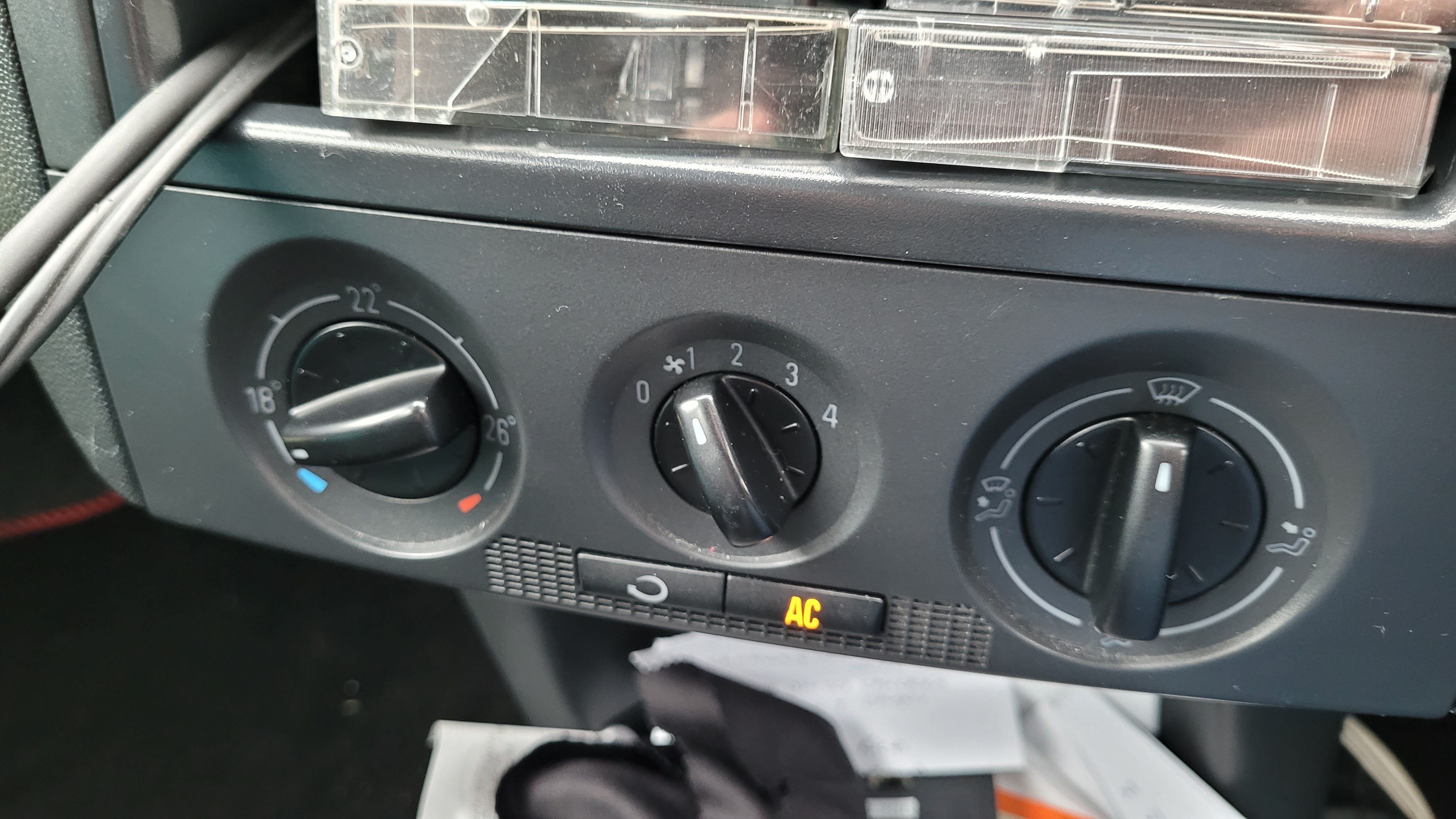

Begin removing this trim panel...

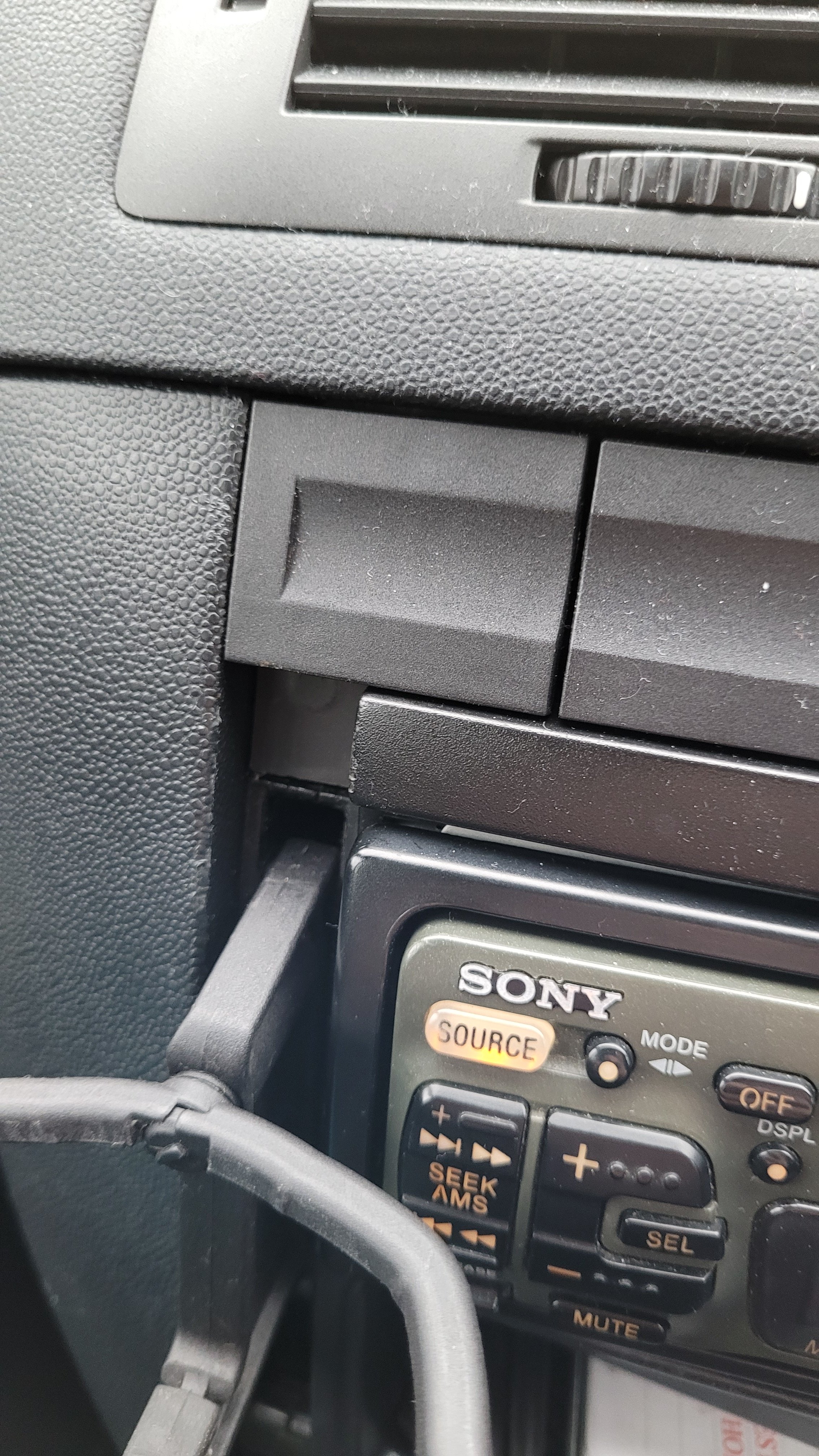

Then this blank button (or heated seat module if you’re posh) …

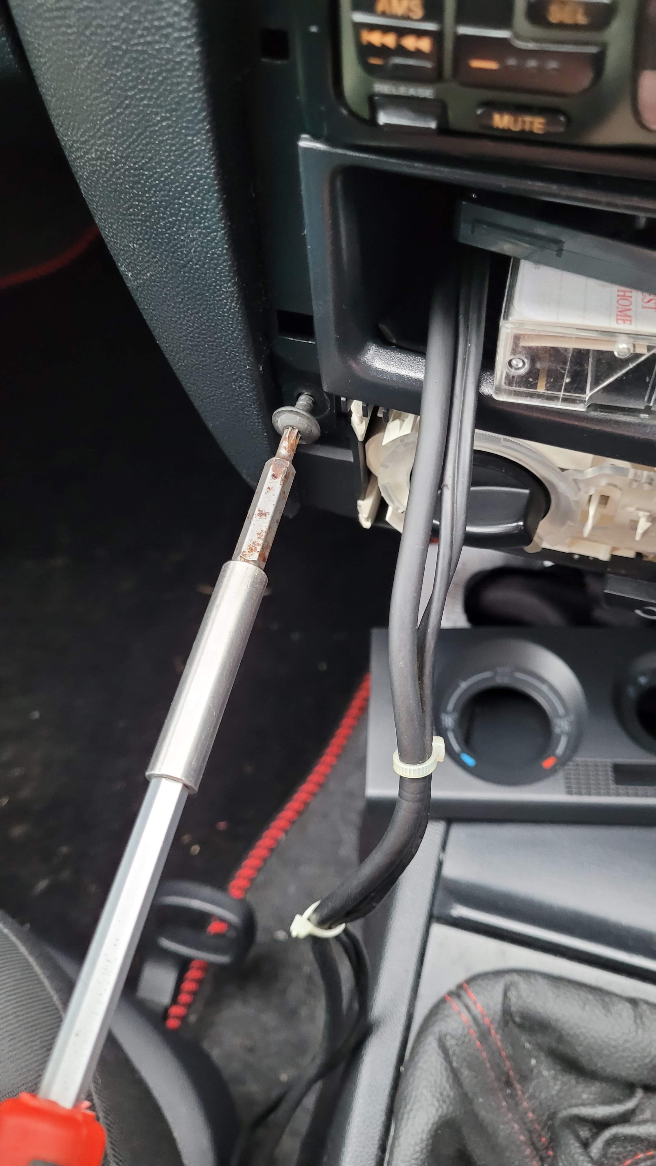

Remove screws with Torx driver. Remove the heater control panel which comes off with a little persuasion…

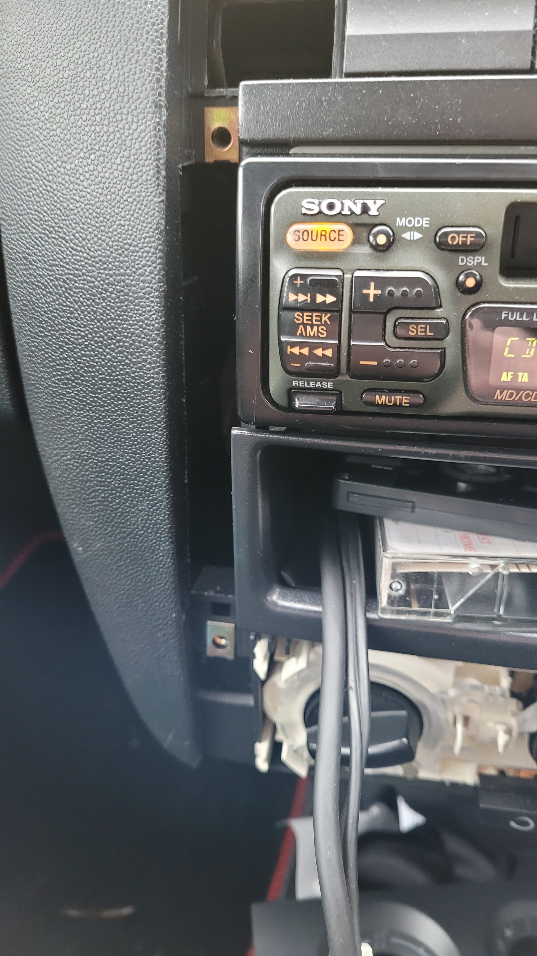

Remove the remaining panel…

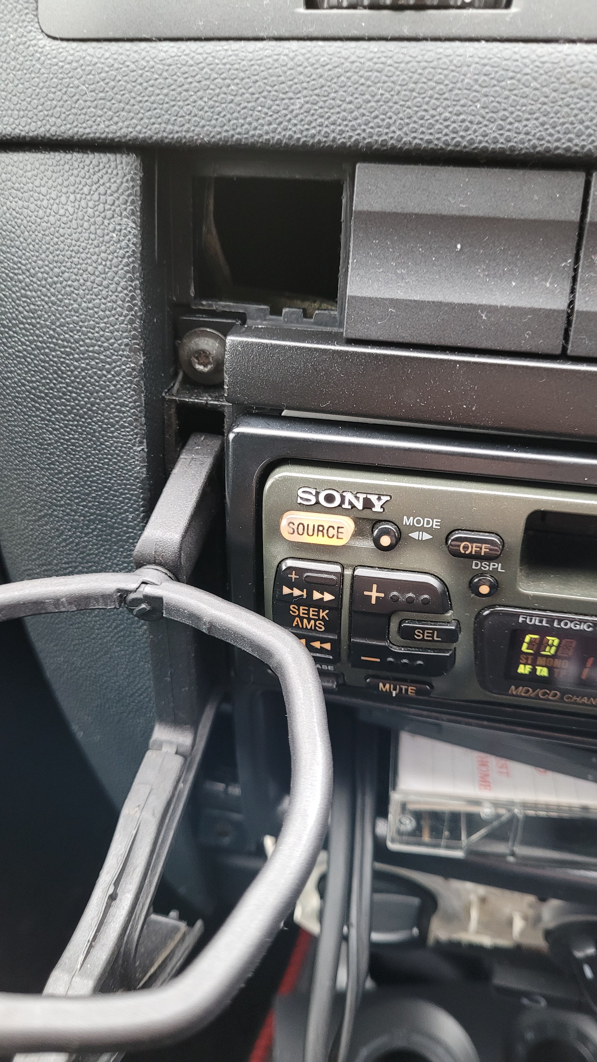

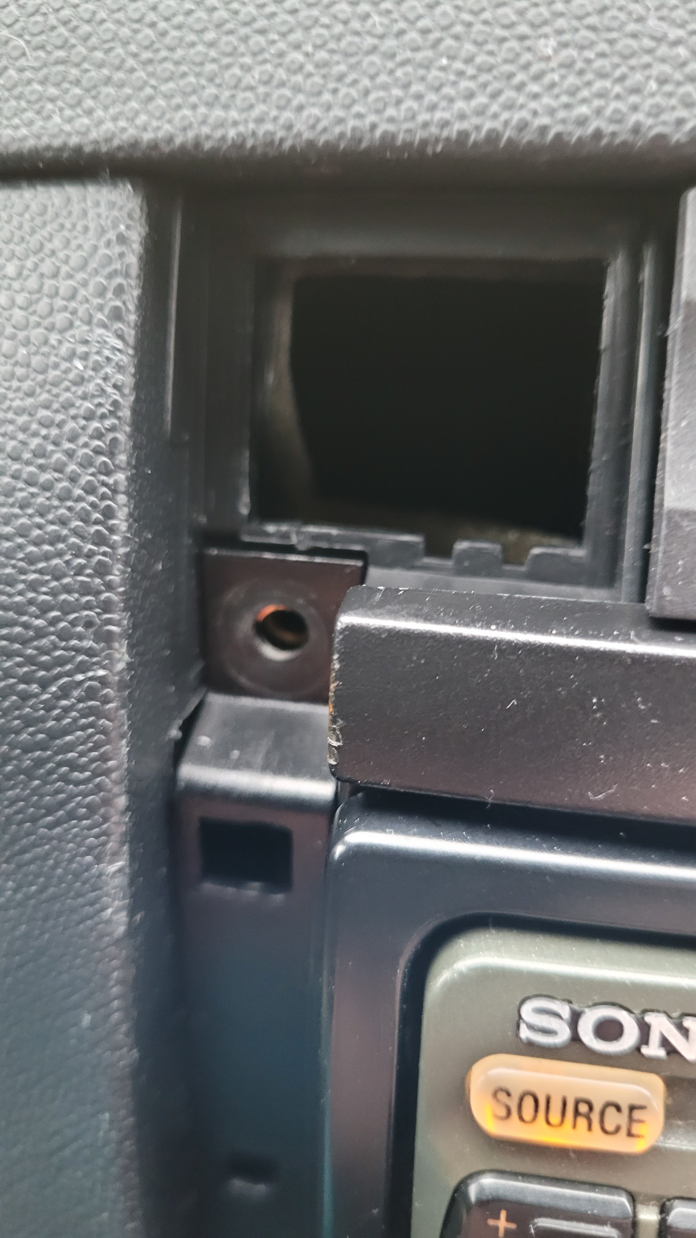

Insert cupholder and refit screws…
And the blank button…
Refit your heater panel…
