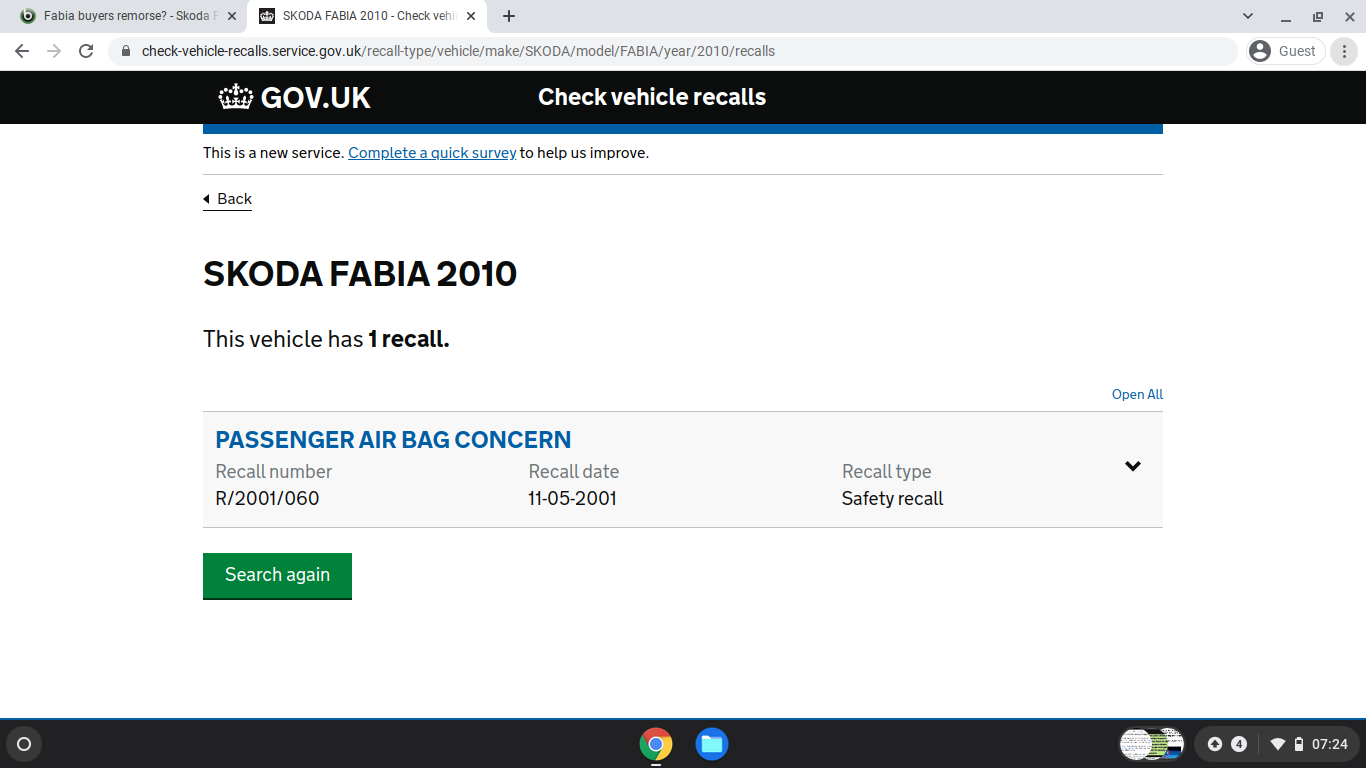

  PS.   There were no RECALLS,
  there were Service Campaigns which now get called RECALL ACTIONS.  Not even the Heated Seats were a RECALL.
http://skoda-auto.com/services/recall-actions
https://www.gov.uk/check-vehicle-recall
The RECALL is on a MK1 Fabia.
