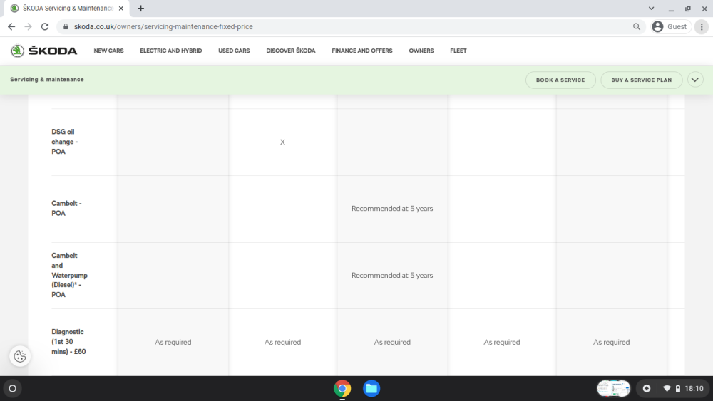

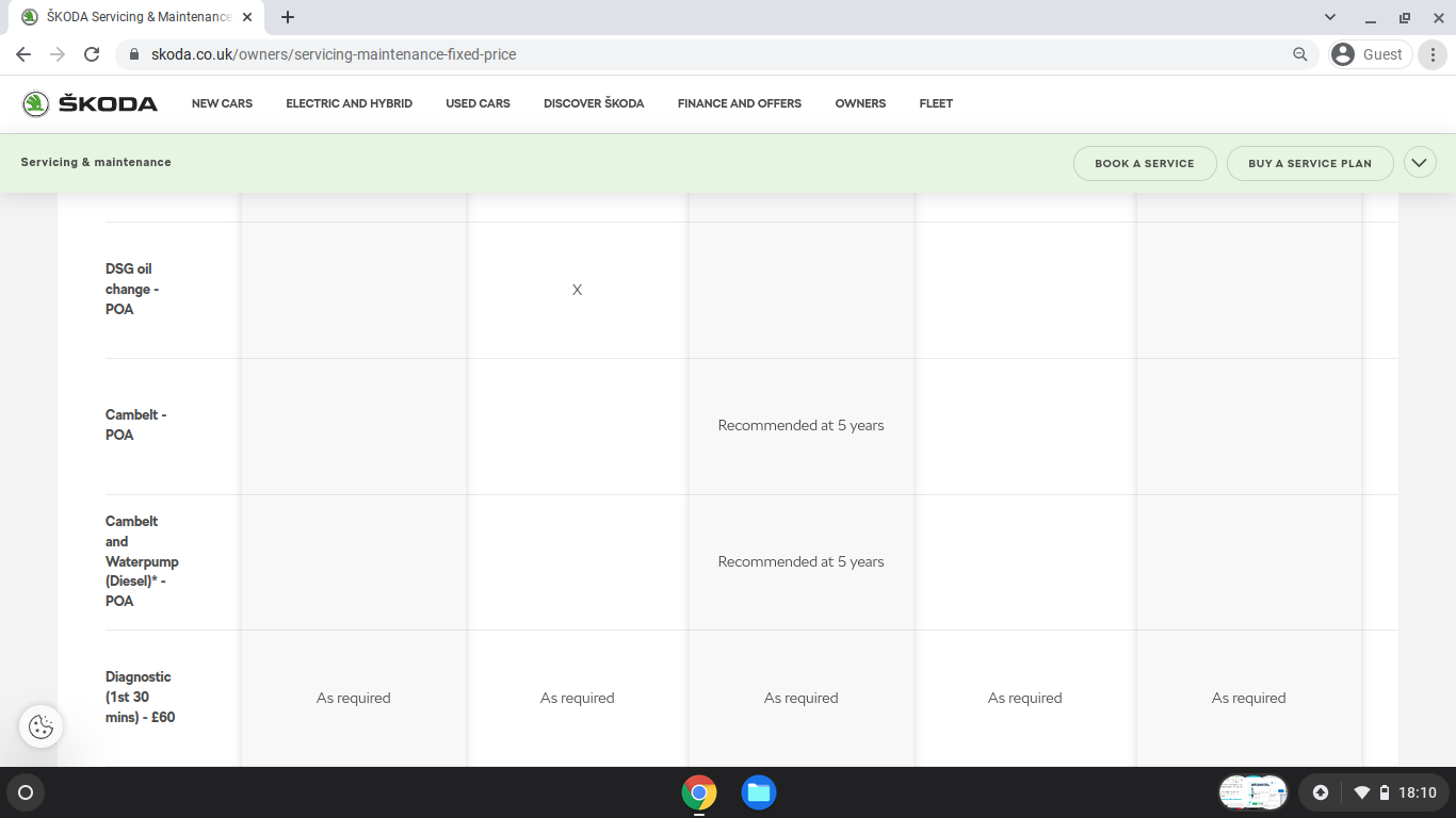

Skoda Fixed Price Servicing and Maintenance @ participating dealers is only £60 for the first 30 minutes and they only need 30 minutes.
36172_SKODA_Approved_Used_Warranty_Dec20_SINGLES.pdf
