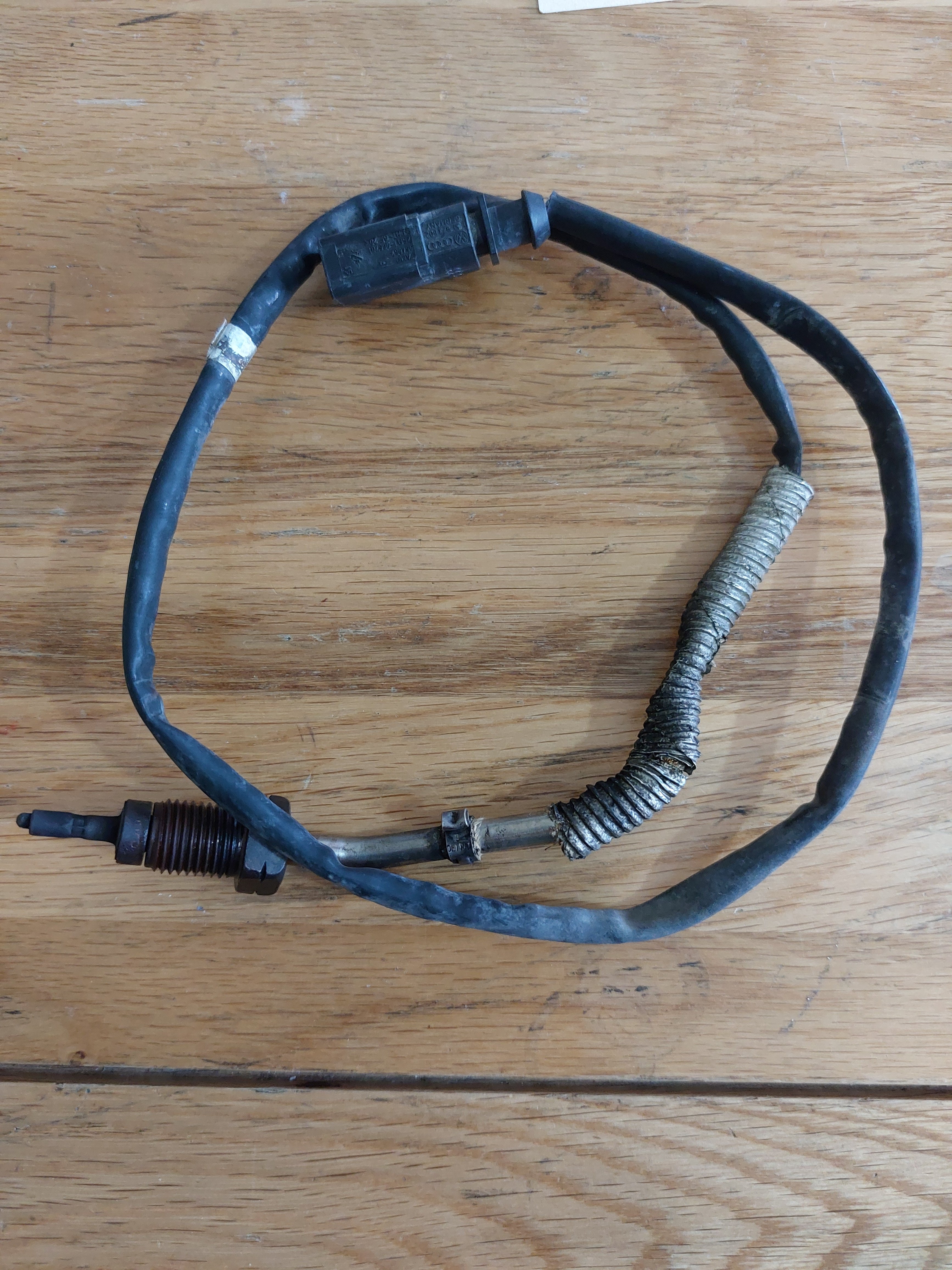

Hi
Trying to confirm this is a
03L 906088 J
Which is the bank 1 no. 3 exhaust sensor, Europarts is quoting me £195 for it. Does that sound fair or should I look somewhere else?
Many thanks
Is that the part you've removed that is faulty? Is there no part codes on it anywhere? It looks like it visually. Although you may want to pay close attention to connector form.
(By the looks of the diagram the three are all different. One on the turbo, one b4 catalyst, one post catalyst   The part number your refer is the one on b4 the catalyst. )
£157 plus delivery on skoda-parts.com.
Retail price probably about right.
Some non genuine options on autodoc. Around 60 or 70 plus delivery.
A genuine item on bay for £100.
https://www.ebay.co.uk/itm/NEW-GENUINE-VW-BEETLE-GOLF-EXHAUST-GAS-TEMERATURE-SENDER-03L906088J-/144151473917?mkcid=16&mkevt=1&_trksid=p2349624.m46890.l49286&mkrid=710-127635-2958-0

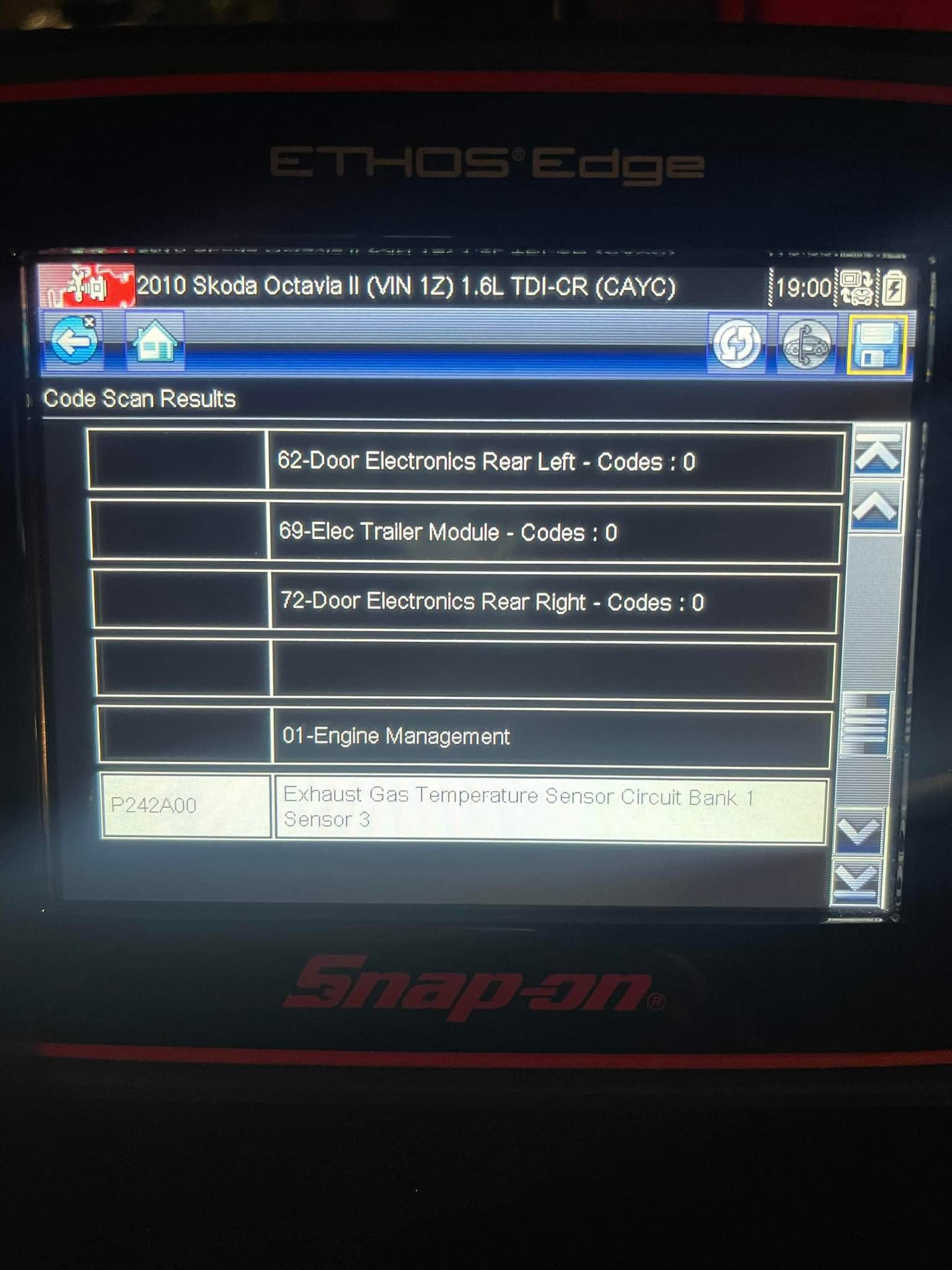

Well F**k my life, so managed to get a sensor from Europe parts for £195.
Managed to fit it really easy  but battery dead, so jumped it and guess what? All the lights were still on.
I bought an OBD2 scanner and it's still showing a P294 code and the coil warning light is lit up and she's still in limp mode.
So I'm down £235 for a job Skoda would have done it for £290 and it's not fixed.
