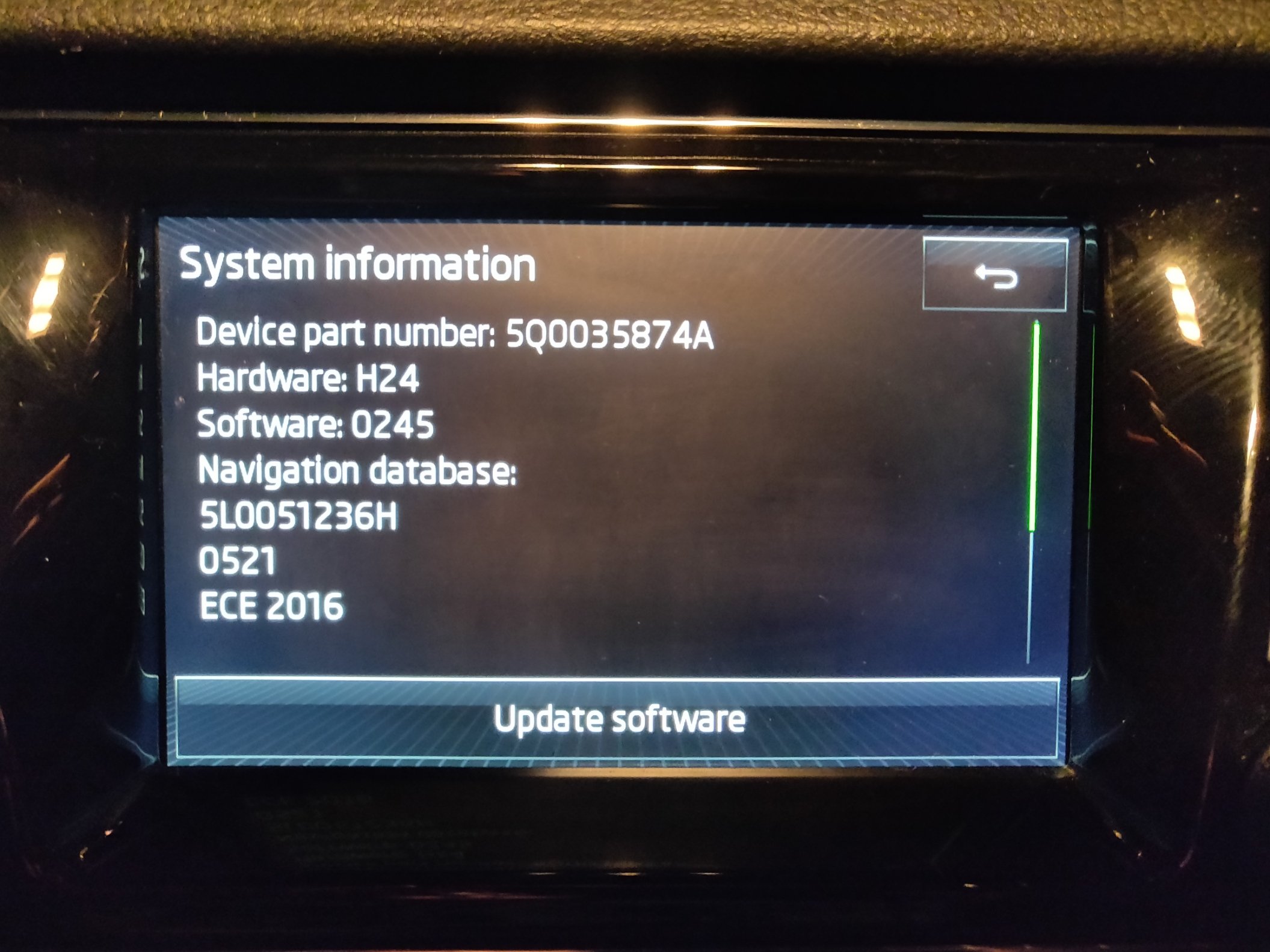

I purchased a 2016-plate Fabia SEL last Friday, and this was fitted with an Amundsen. System information is attached.

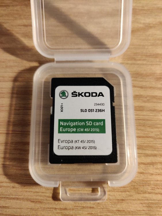

1: It's safe to remove the contents of the SD card? Don't want to find that I've stopped it working irreperably, but at the same time I understand that as the card is almost full, space will have to be freed up to fit newer maps on there.
Picture of the card itself attached.
