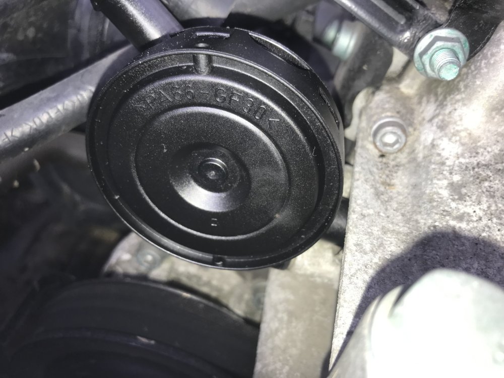

Hello,
anyone knows if the PCV valve from Fabia mk1 1.2 HTP with AWY engine code should rattle when shaken to test? Mine doesnt make any sound but looking at the design Im not sure if it should.
  • Sponsor
I don't think I would expect it to rattle.
thanks for the reply Pete,
i think ill just stop shaking it then and put it back.

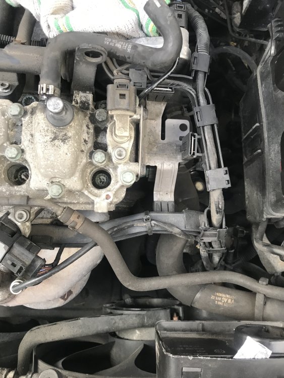

any idea where the EGR is on this 2004 1.2 HTP AWY 3 cyl 12v engine? does it even have one?

Don't think your engine has one. On the BME version of the engine it's right at the front....

AWY and BMD never had one.
AZQ always had, BME had one until end of 2005, then didn't.
