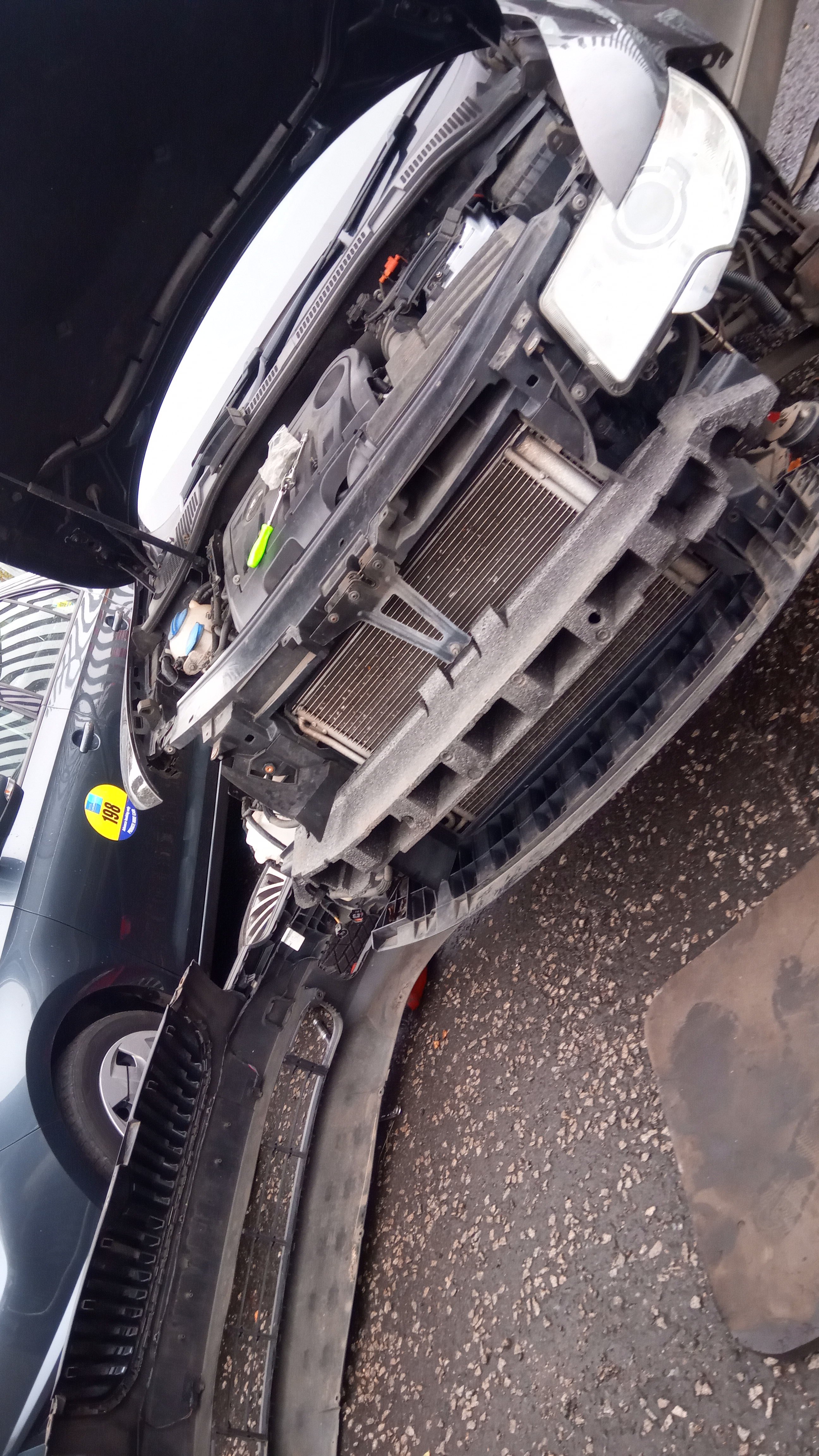

@Walder
its not that complicated to take the bumper of
15 Mins and its sitting on the ground
2 person job to put it back on thoughIMG-20191005-WA0000.thumb.jpeg.3fcf27f47b0c0685e69ddfeb86b2ac5b.jpeg
Ended up with my mechanic doing it
£40 for the pleasure and it kept my Saturday free for the first day of good weather in Northern Ireland. Money well spent! 🤣
