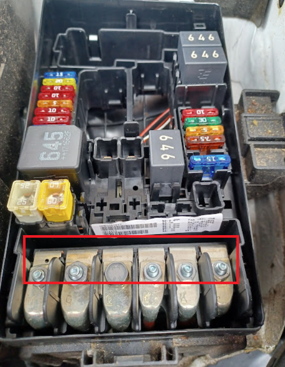

The battery has been checked, we have a new alternator but I read on this forum there is a fuse for the alternator... I am buggered if i can locate it from the handbook any ideas? None of the fuses in the engine comparment seem to be visibly damaged I havent removed them all.

Can you post a picture of the fusebox under the bonnet, including the face that's nearest the front of the car if poss.
Here you go... Photo

I believe it's part of this chunk here, that all the heavy-gauge wires bolt to.  Often the left-most stud, I think. (see if that wire goes to the alt.).
If you have 12V on each of those studs I'd say the fuses are all intact.  Careful not to short anything out while checking.
