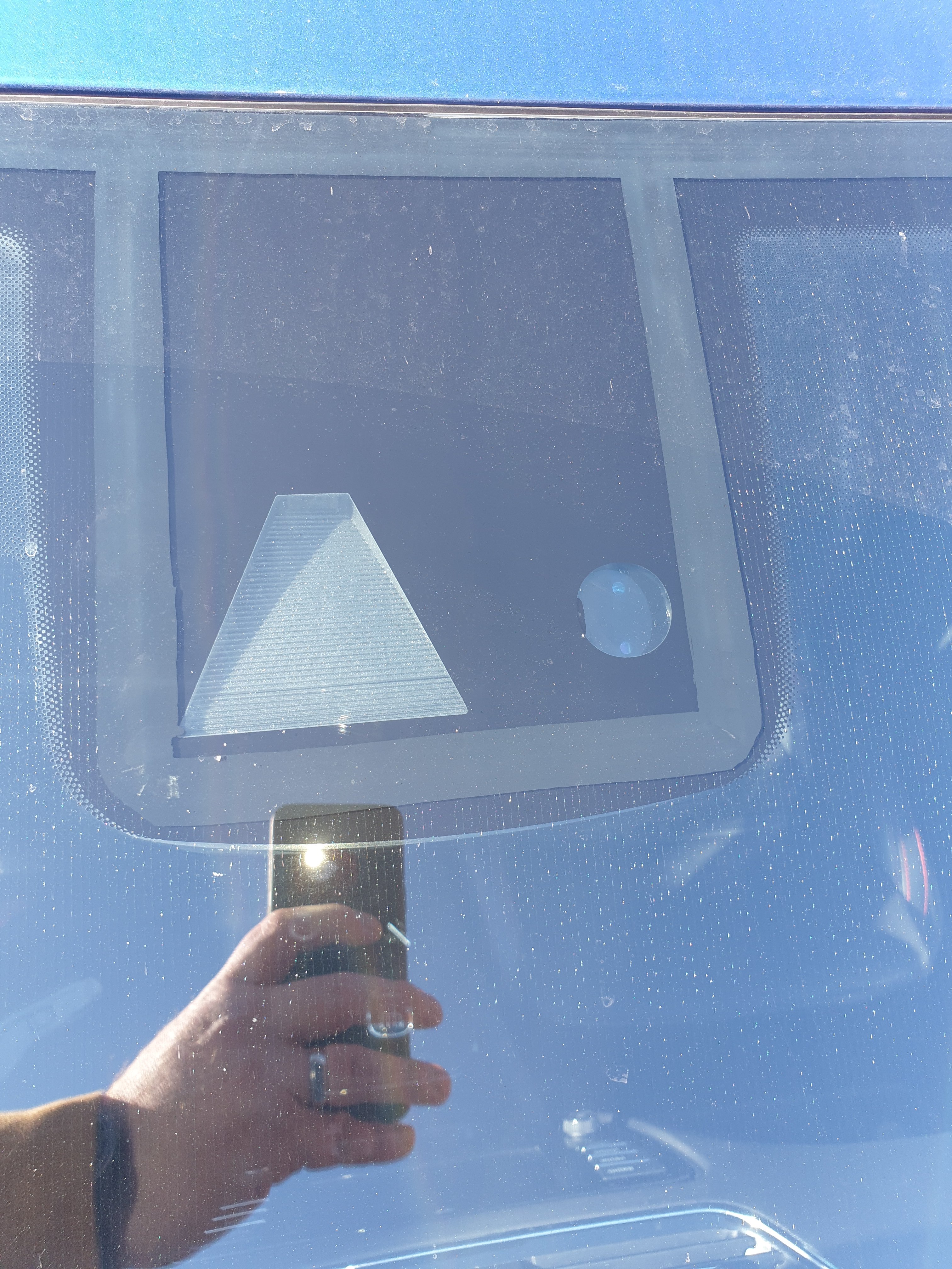

I belive its the rain sensor ive added a photo.

For auto wipers its not an intermittent/intermediate setting but a sensitivity control for the rain sensor, in steady rainfall it has pretty much the same effect though, the more sensitive that you set it the more frequently it will trigger.

I knew about the standing still and them not working and that wasn't the issue, how I solved it was the automatic setting on the car information settings was ticked so that the rain sensor set the wipers off in the rain but for some reason unticking that box made them work.   🤨
