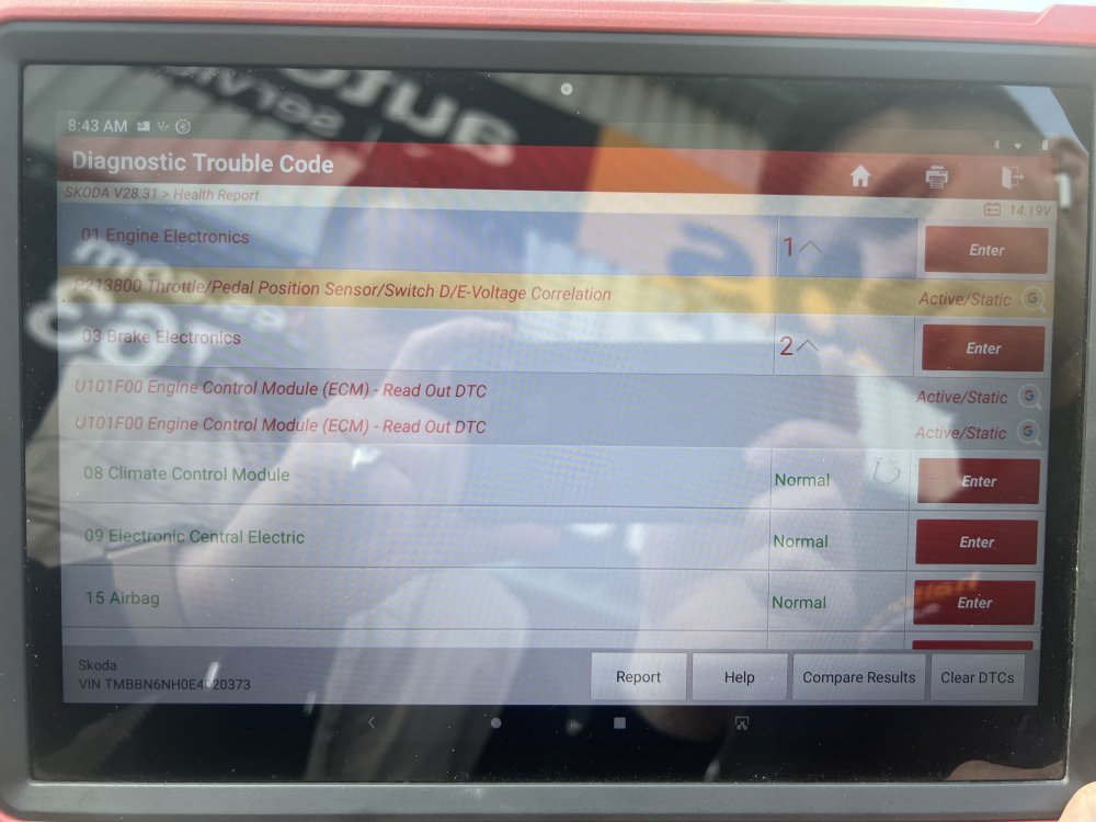

I’m currently driving a 2014 Skoda rapid and have had an intermittent fault appearing and disappearing with no sort of pattern.
the faults are displayed below in the picture attached, there is also a picture of what the dash does when the fault occurs.
Has anybody else had these problems and if so what did you do to solve the issue.
I was told by the garage today to take it to the dealer as they did not have VW software.
I have seen a lot of people saying about a battery change but I would like to get other opinions before either taking it to the dealer or changing the battery etc.

I had similar faults show up and car went into limp mode.
Reading the codes showed up as throttle position sensor but that it was ok. Mine is a stop/start SEAT Toledo, has the same engine electrics etc VAG motors.
It was a weak battery, replaced and all was ok.
Incidentally I had an EPC code show about 3 weeks ago read the codes, nothing showing. Again battery showing low charge, my fault I run the battery low so it threw a light up on the dash.
I strongly recommend getting the battery checked out, it's colder weather now so finds out weak batteries.
