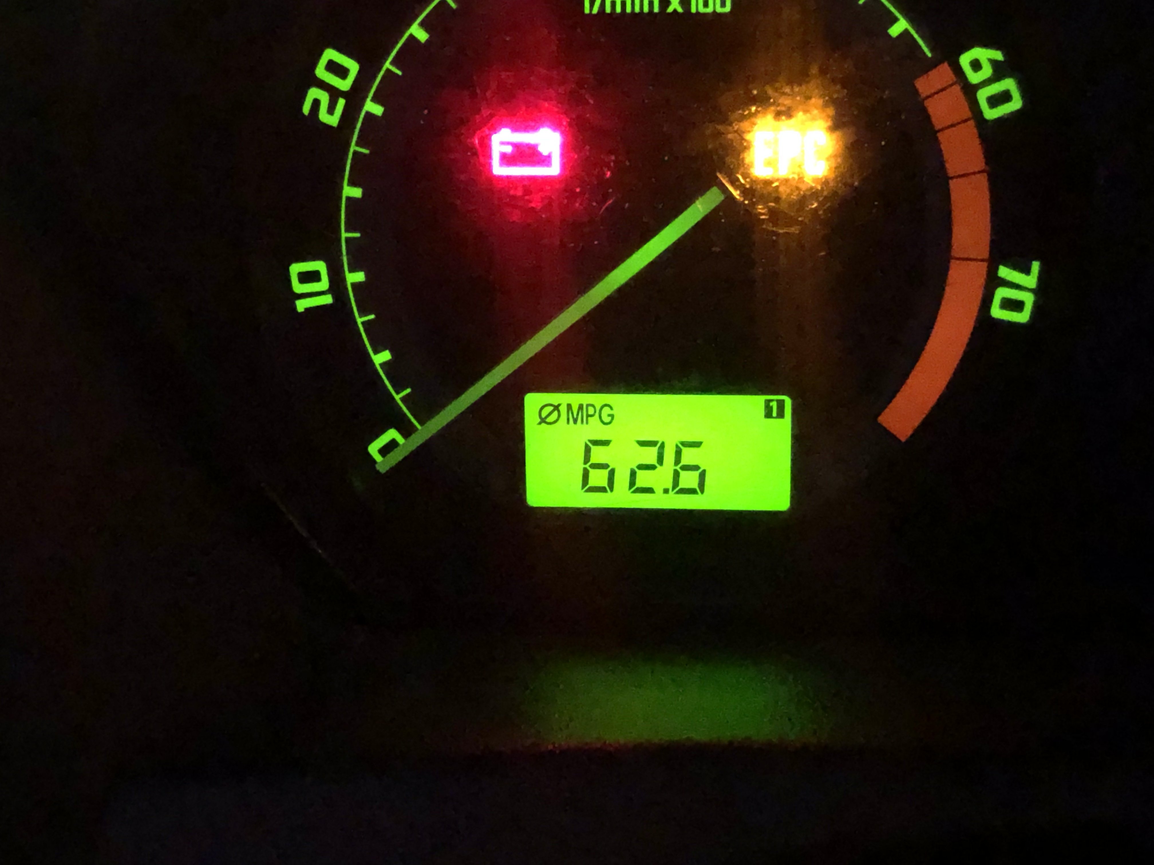

I must have owned 30 cars but I’ve never come across MPG quite like my 18 year old Skoda Fabia 1.2

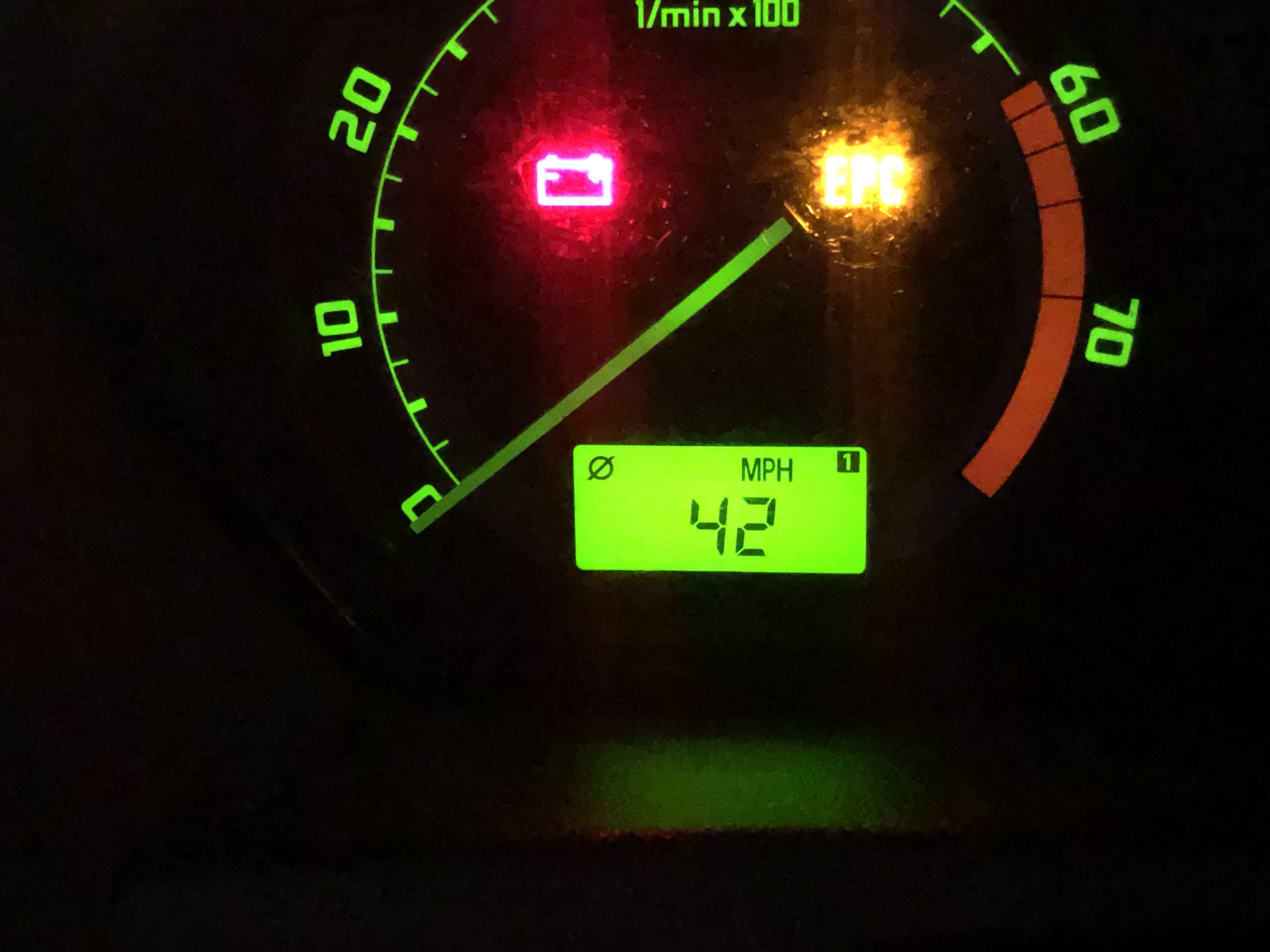

on my way home from work last night I got 62.6 MPG, over 33 miles averaging 42 MPH
Can’t quite believe it! I’m so happy 😀
Is this normal? What do your Skoda’s do?

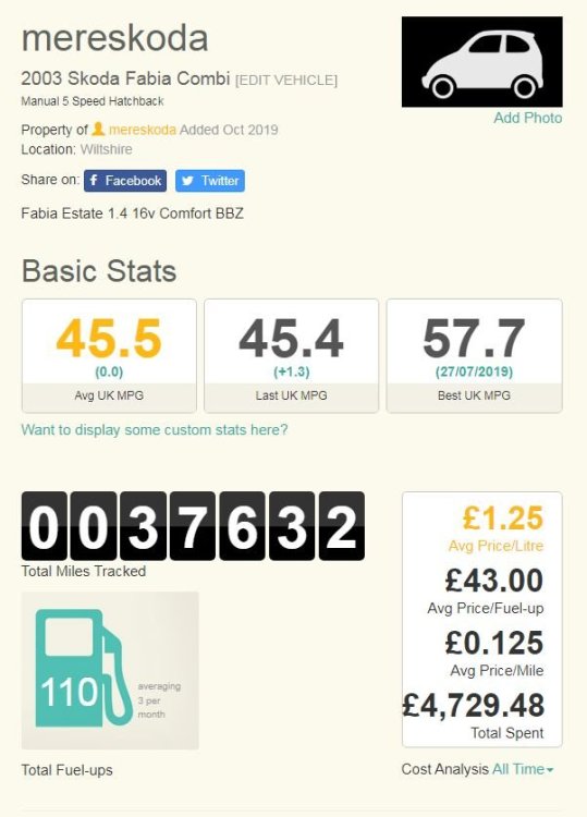

I use fuelly.com to record fuel purchases.
