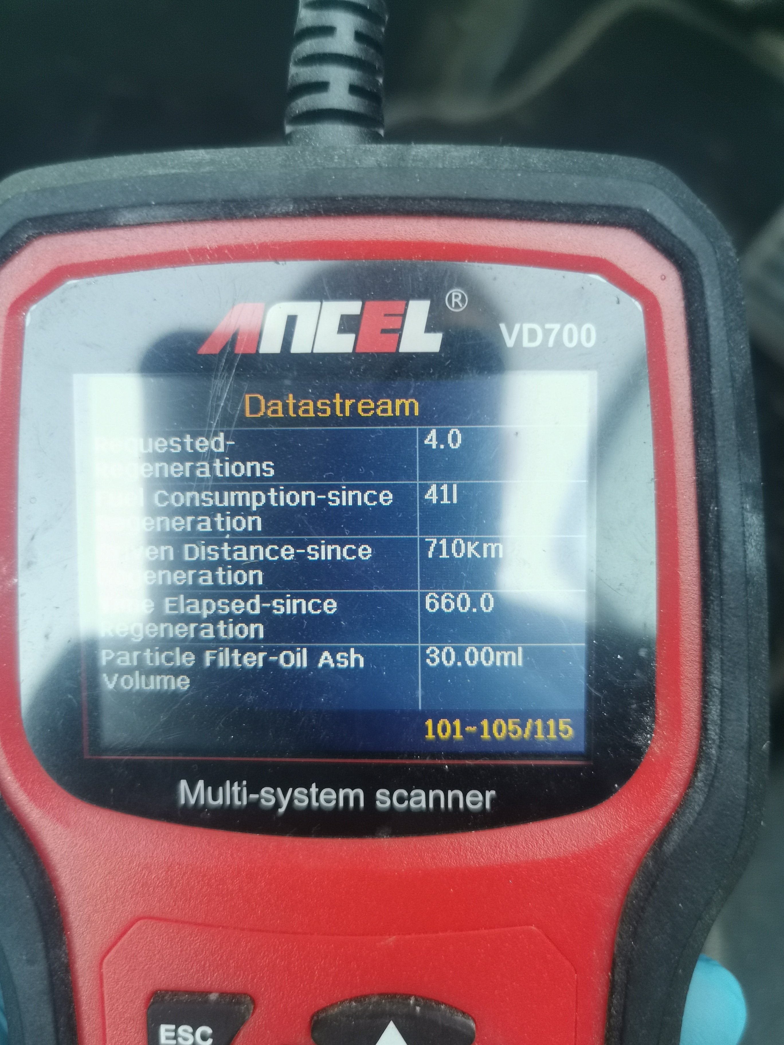

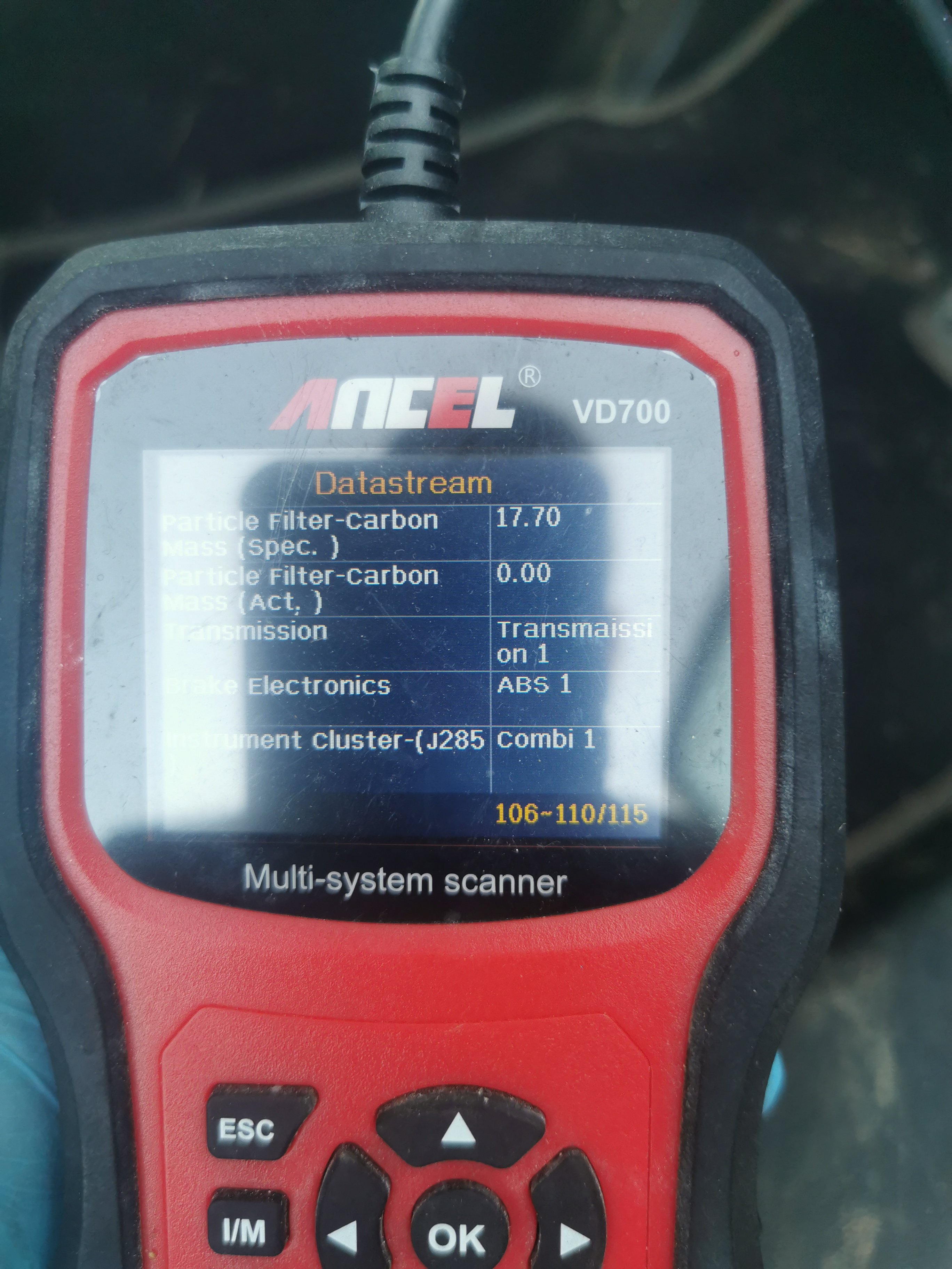

Hi thanks for reply. As said previous, some short journeys during the week that realy can't be helped but always a good run at weekends. I use the ancel VD700 tool, rrafings are 30ml oil ash, 17.70 particle filter carbon mass (spec) 0.00 particle filter carbon mass (act). Is the Ash content to high at 30ml? I noticed the oil level rising a few months after buying the car, eventually killed a turbo! Since then I've been closely monitoring the oil level and can confirm it has risen again several times. Its obviously diesel diluting the oil. Sometimes I removed 2 litres and top up according, oil and filter changed every 3-4 months. I've been doing extended drives on motorway whilst scan tool connected, exhaust temps get to around 450, isn't this hot enough to regen. Tried holding in 5th to keep temps up. After a good hours run at motorway speeds, get home, still at high idle trying to regen. Scan tool shows no regen was completed as distance traveled  since regen still increasing. All the best

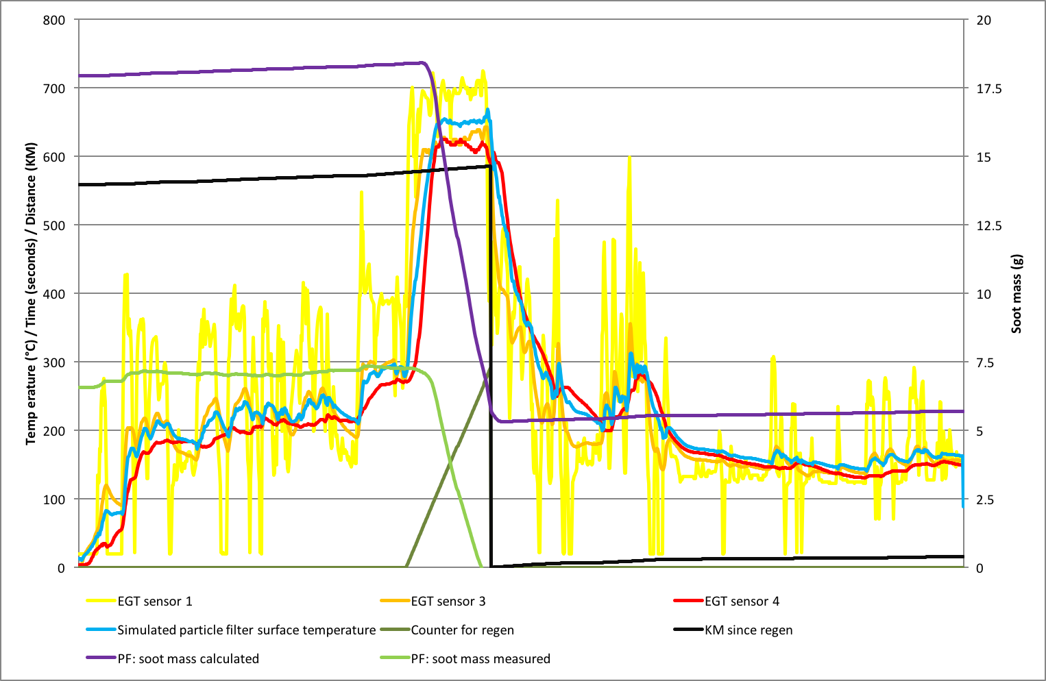

450'C is pretty low for a regen. For reference, this is a regen from a 2012 CR140 where all three EGT sensors reported 600+:
I'd also concerned that the soot mass actual (measured?) seems to be 0. Makes me wonder if the car has been mapped or running some messed with software...
30ml of oil ash is also very low for a car on 156k miles (mileage based on your post here https://www.briskoda.net/forums/topic/502888-20-cr-engine-injector-seals/?do=findComment&comment=5646486).
