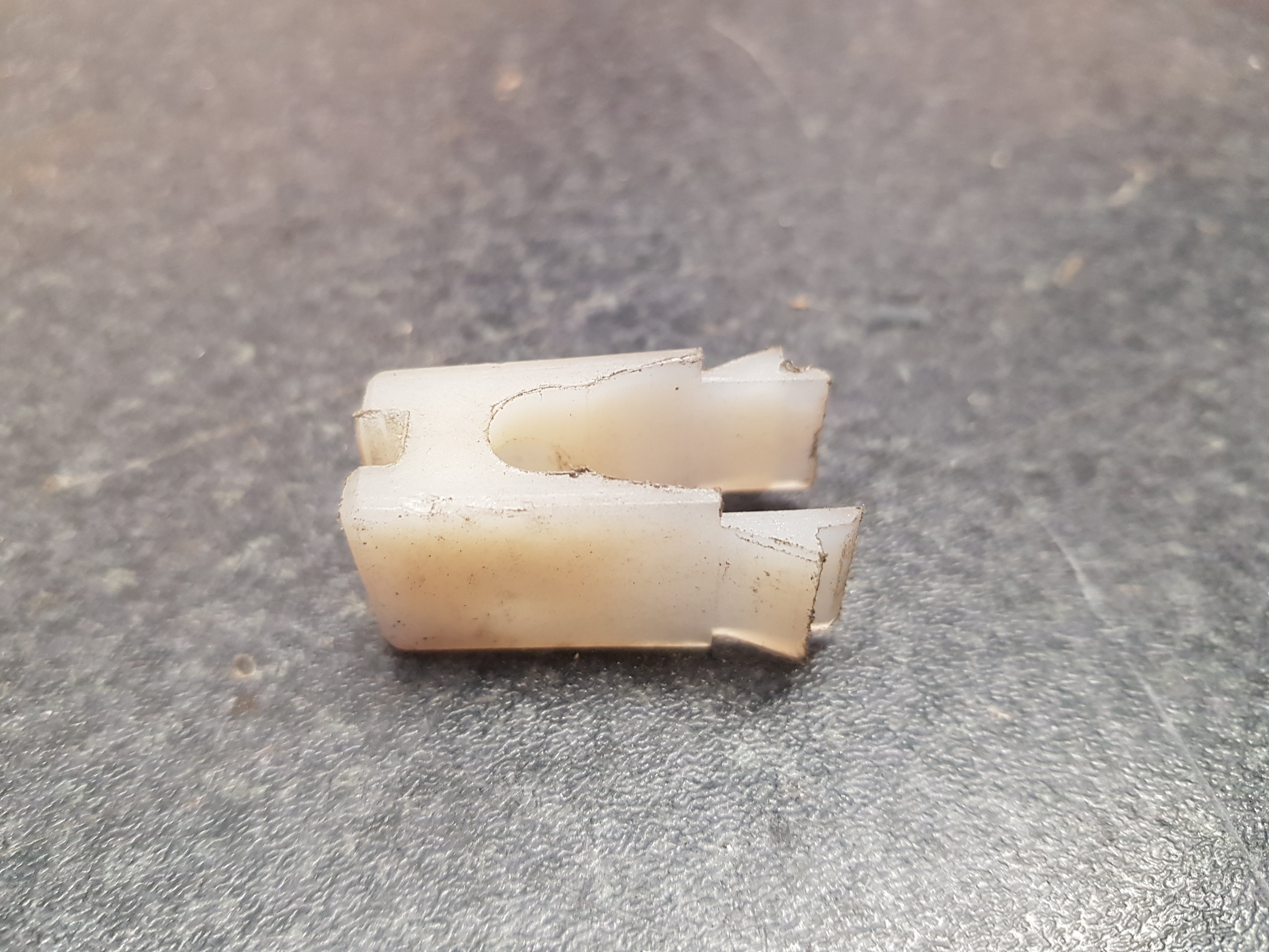

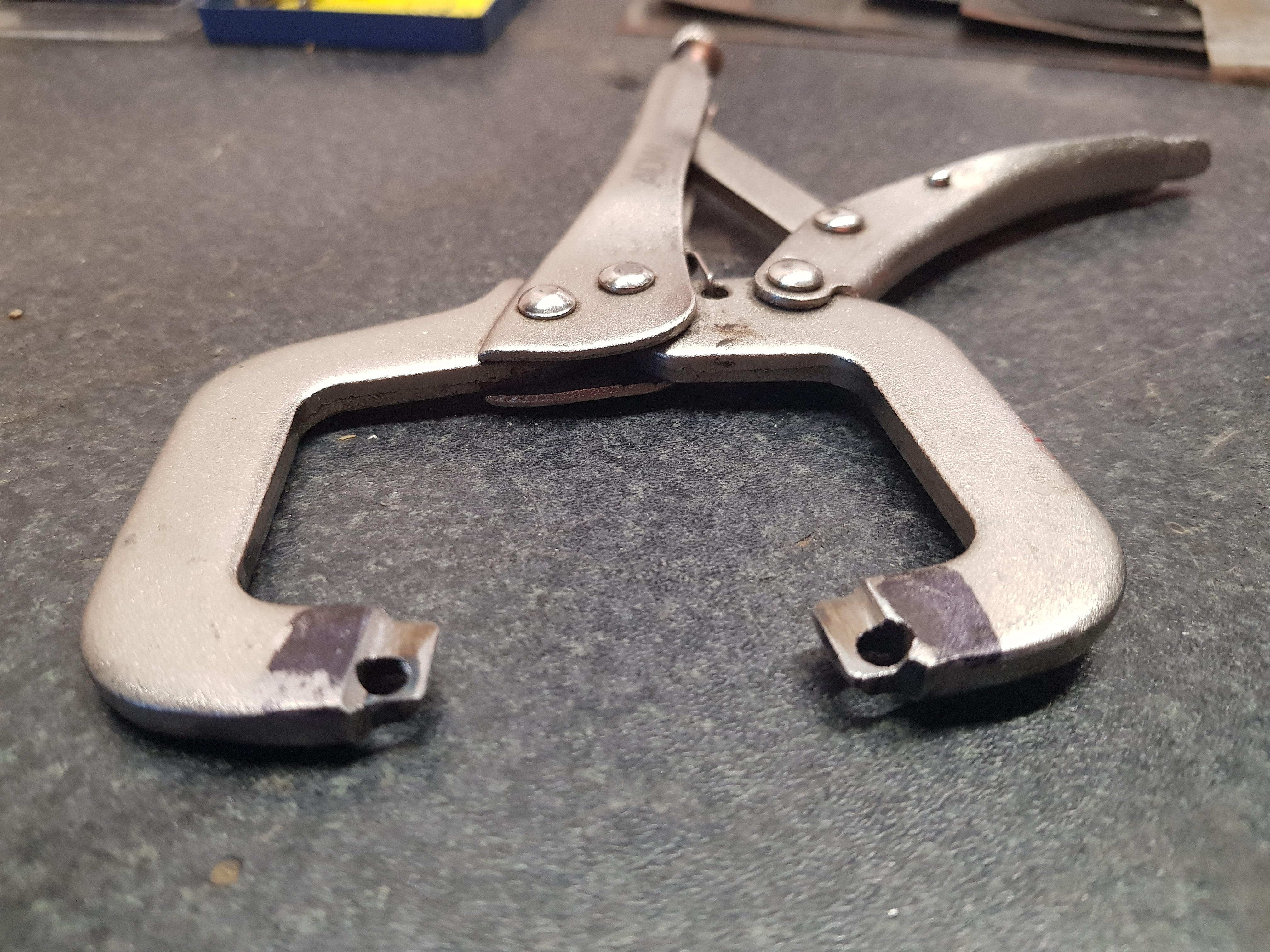

So bit the bullet today and decided to replace the MC.
Based on the instructions from the manual (see attached) it didn't appear that daunting of a task but typically it didn't go to plan.
I'd fabricated a T10005 tool from a welding clamp which performed the task reasonably well but also took the precaution of acquiring a replacement for the clip, more on that below.
Getting the old cylinder out went well enough but trying to fit the new one with the new clip I just couldn't get it to click in  place, then it happened, the helper spring popped out, why I have no idea but hey I thought, no big problem I'll drop the pedal out and refit it - but oh no, for some unfathomable reason the bolt which holds it in is inserted from the steering column side meaning that there was no possible way to get it out without either removing the entire column or taking the complete pedal assembly off the car. What they were thinking I can't imagine as there is no need whatsoever for it to be fitted from that side, it's a simple 8mm bolt acting as a pivot and can go either way and from the opposite side it would have come out without issue.
No way was I going to remove the steering column and after considering - but dismissing - the angle grinder option I set to removing the pedal assembly. The video I posted earlier came in handy as it gave me a clue for removing the top nut which I could barely see but did mange to remove using three long 1/4" extensions through the gap under the steering wheel all the time wondering how I was going to refit it as I do not have a 1/4" 'wobble' extension. Once the assembly was out I cut away come of the sound deadening padding which was partly obscuring it which at least gave me an improved view of where I would be working when refitting it.
On the bench I examined, compared, and measured the new clip against the original and discovered that not only was the new one about 1mm longer between the arrows but also that the slot in the end was narrower so there was no way it was ever going to fit so I chucked it aside and reused the original.
I reassembled it all on the bench as per the video and refitted to the car, the top nut was a b*itch as anticipated but I eventually got it back on.
I bled the system and quickly got a good pedal but then noticed a weep from the pipe where it fits in the MC so removed it again, checked and refitted the rubber seal, after which is sealed correctly, as a check going forward I put a piece of black duct tape on the chassis member immediately below the connector which should immediately reveal any drips.
As stupidly expensive as they are I may invest in a new seal just in case.
What should have been a max 1.5 hour job turned into a half day marathon and being of 'an age' Instructions.docwith all the contortions in the footwell I expect to be totally seized up on the morrow!
