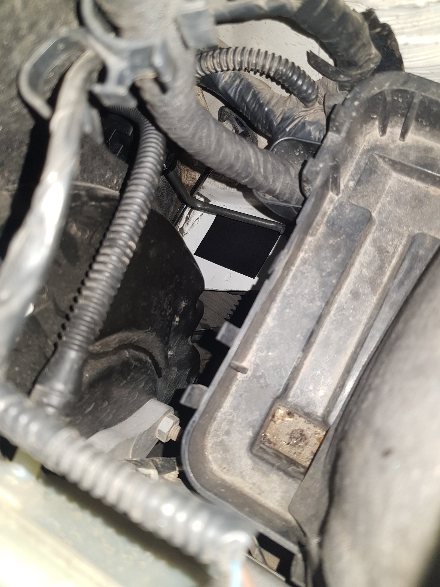

I knew about the seal from the video but it must have dislodged slightly when I fitted the pipe or perhaps the slight movement of putting it back into its support clip on the chassis rail disturbed it.
The fact that it bled and gave a working pedal is indicative of the extent of the leak though, i.e. dripping rather than gushing, start to finish I doubt I lost more than a couple of thimblefuls of fluid.
I don't know what sound insulation you're talking about as the connection is well away from the bulkhead so leaking fluid would drip directly down and pool on the naked chassis leg, hence my piece of black tape because being a white car a tiny drip would be difficult to see otherwise. Thankfully so far it's dry.

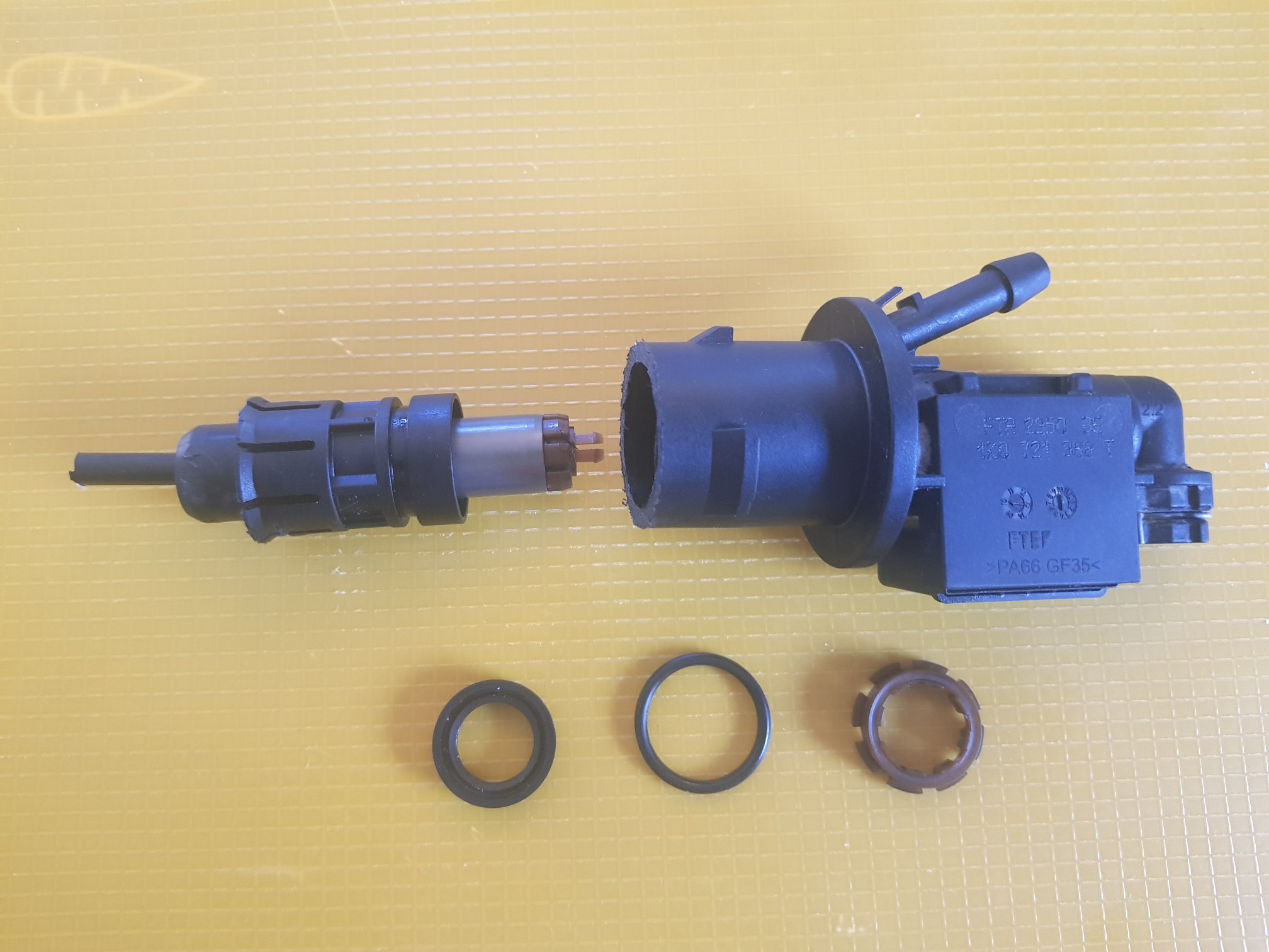

Curiosity of course demands that I disassemble the old cylinder to see exactly what has gone wrong inside it!

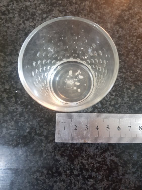

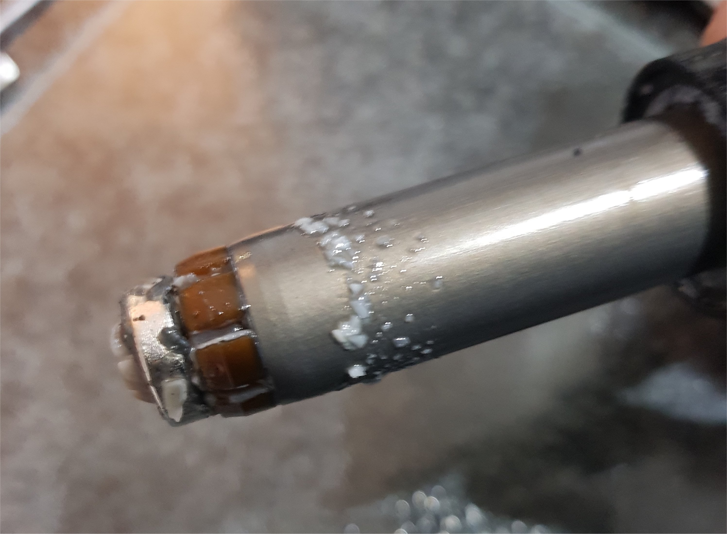

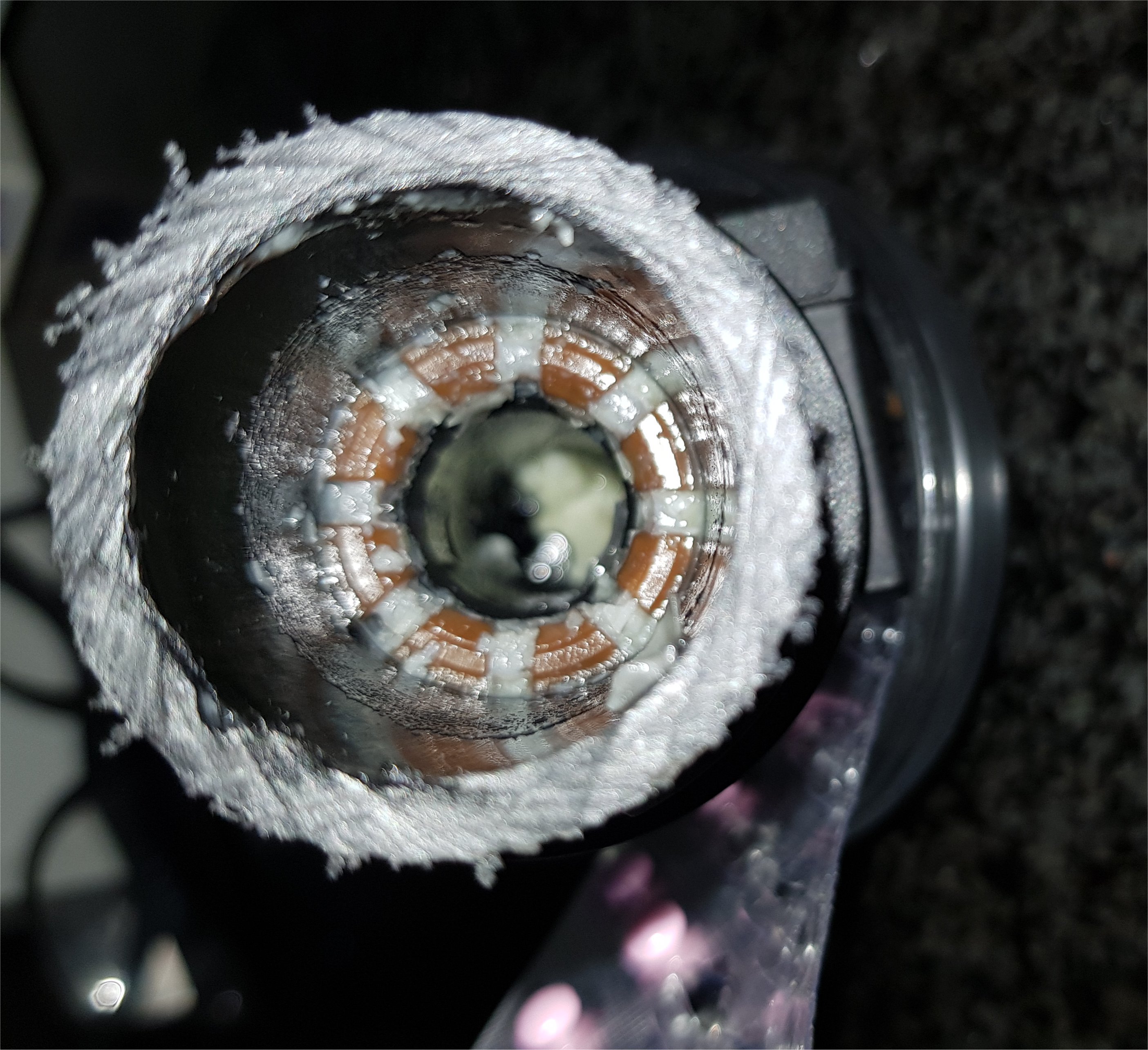

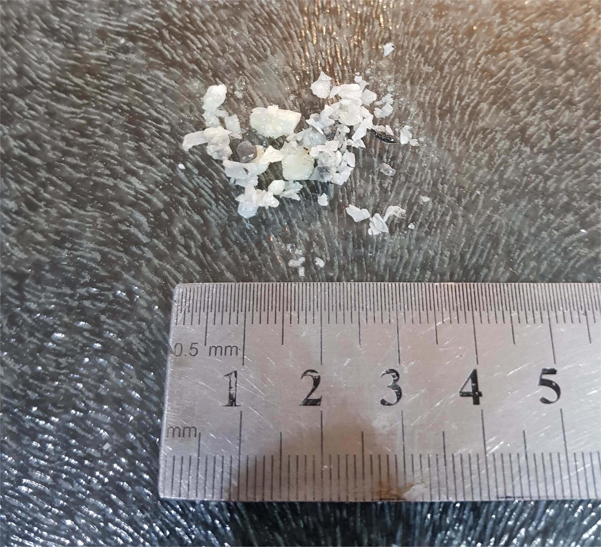

Autopsy done.
No problem getting in as I had no plans for keeping it so just hacksawed around the periphery.
Found loads of white crud inside but only a small proportion of magnetic debris.
Most of the crud in fact dissolved with water and the glass shows what I was left with which was crystalline and most of that had come from the segmented brown seal/bush
Seeing all that makes me think it might not be a bad idea to pull the slave and check that for crud although I suspect both the hydraulic pressure and push back from the clutch cover would overcome any sticking issues there.
I think if I were to encounter the problem in the future I might try an aggressive flushing first.

Nothing like what was in mine but it would definitely cause stiction.
Never seen anything like it in a car hydraulic system but I've been doing some research and come up with this, similar can be found in multiple places.
"If the brake fluid is not changed it will continue to absorb moisture, and eventually it will crystallize and form deposits inside the brake system that can cause the seals to fail and components to seize."
If that is the cause then the surprising thing is that it's happened so quickly (11 year old car which presumably had at least one or 2 changes during it's early life) when, like a great many I'm sure, I personally have never once deliberately replaced the fluid on any vehicle I've owned.

Those crystals are more than big enough to block the fluid return path through the clutch bleed block AKA peak torque limiter, on the downstroke there is no restriction but when you lift the pedal the fluid has only a tiny orifice to pass through, well less than 1mm diameter.
I would definitely remove the slave cylinder and bleed block, I think its one unit on your vehicle, strip and clean it as you have done with the old master cylinder, while its off purge the pipes before refitting.
You also need to empty and refill the brake master cylinder with new fluid , if you did not do this last time then the only way to be sure is to remove and strip the new master cylinder which you wont be looking forward to.
And of course as a matter of safety you should bleed the brakes and the ABS unit, the crystals whatever they are are equally likely to be present in the braking system and wont do parts with fine passages like the master cylinder and ABS block any favours.
