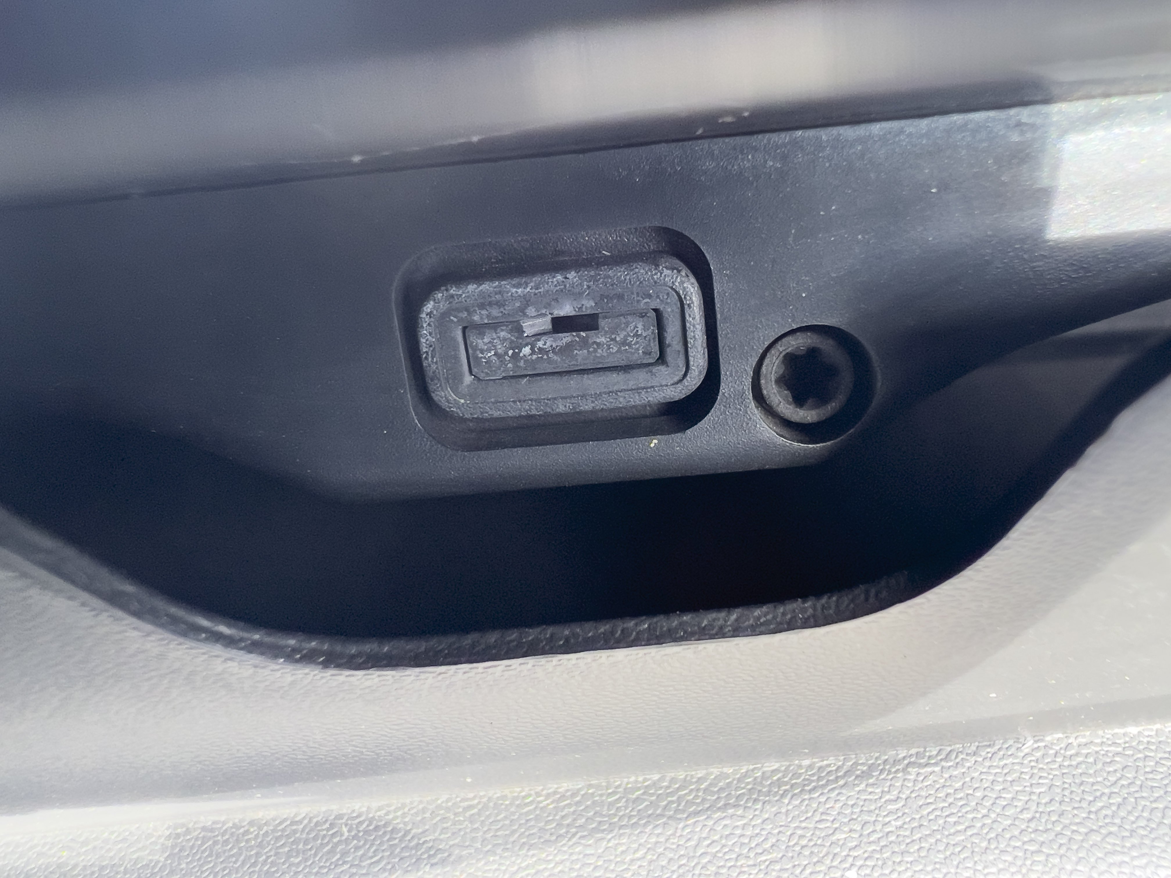

I have found out how.
Next to each jet nozzle is a T10 torx adjustment screw,
Clockwise spray down,
Anti clockwise spray up.

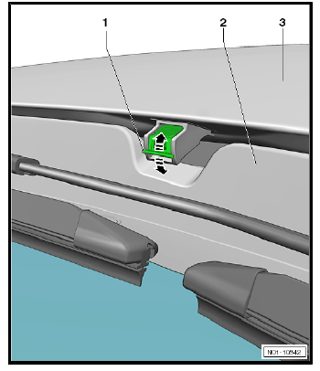

If yours looks like this, then you need to lower/raise No.1 as needed.
Nope, as I say, not the same as mine.
Excellent! mines exactly as you described as you can see from my picture above. I assumed the torx was actually for removing the jets so didn't want to fiddle with it I have to admit!

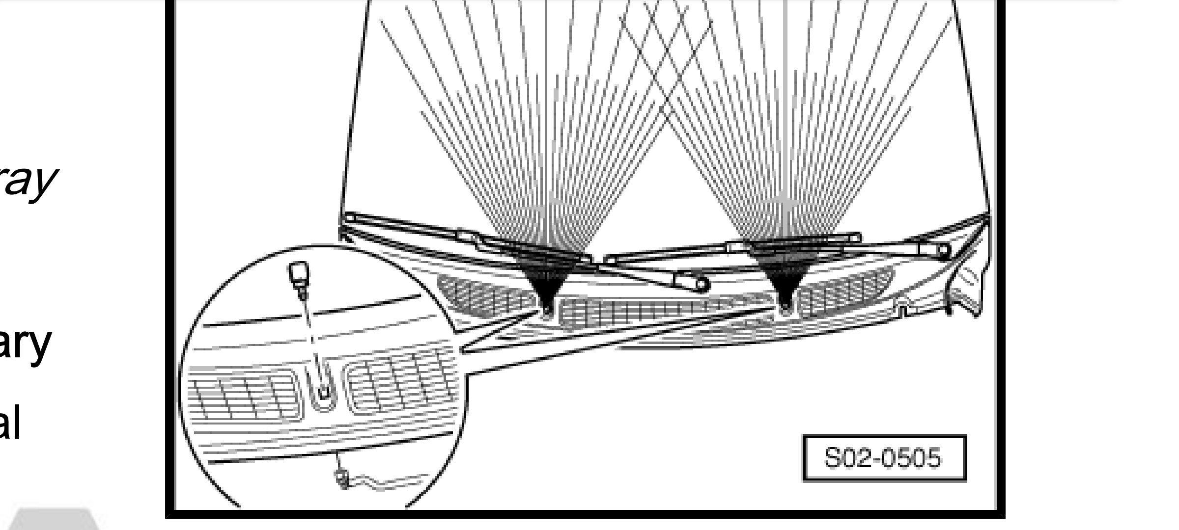

A bit late, the image from correct year.
Screenshot_2022-07-31-17-04-25-270_com.google.android_apps_docs.thumb.jpg.022b557fb24ef2152fd2cc341d324e4f.jpg
@PaulCanning it was a mistake on choosing the year, the 1st diagram was for Fabia III, and one in this post for Fabia II but in typical VAG fashion it doesn't match reality.
