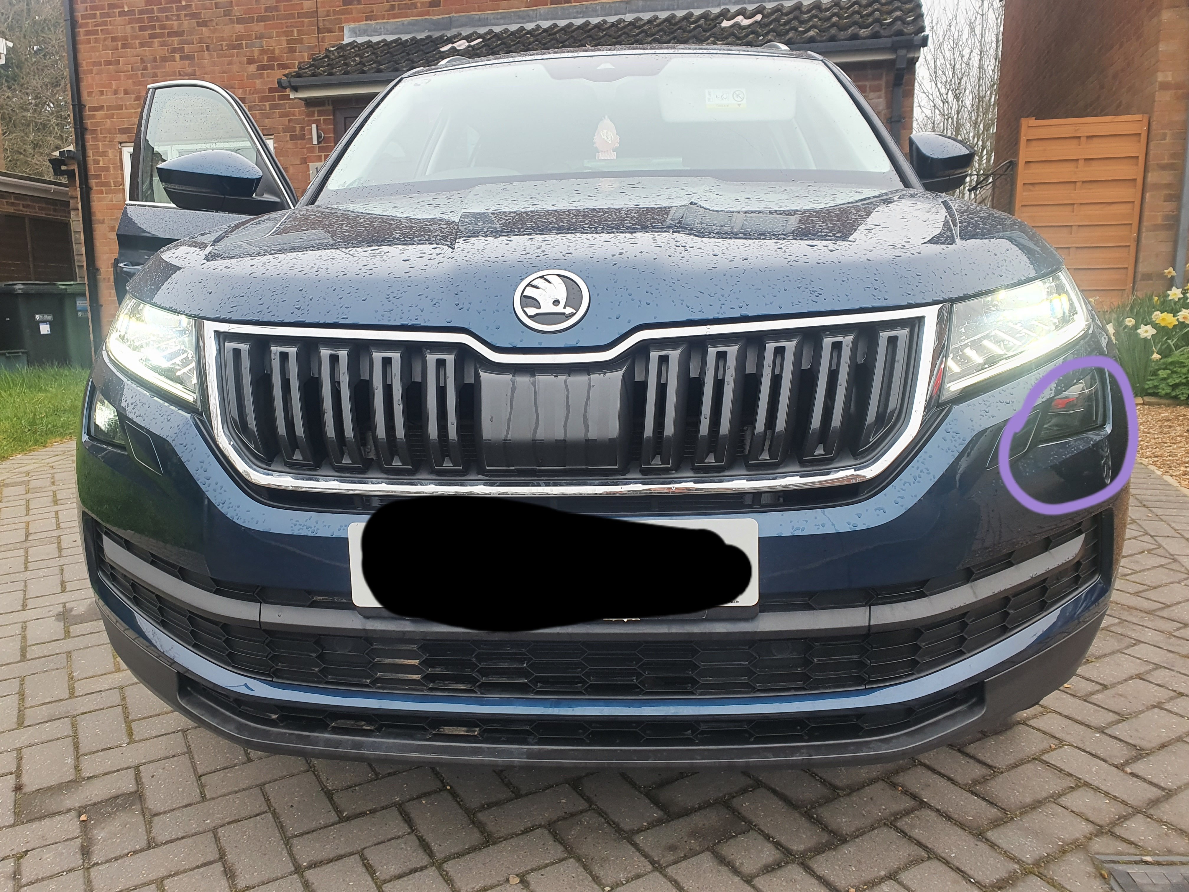

Please can someone explain the corner/fog lights to me?
I noticed today that when I checked the lights were working after I'd reversed into my drive way, only the right of the lower lights was on so obviously thought that the left bulb had gone. However both Did come on when I put the fog lights on (usually I have the switch to Auto).
The manual mentions the corner lights but I don't quite get why only one would come on on one side? especially if the car is stationary on the driveway and the wheel is pretty straight.
When I put the car into reverse both Did the come on as it suggests? Does this mean the lights are working ok? I'm a bit confused.

The cornering light will come on at speeds below 25mph on the side that the wheel are turned to, or when indicating. As you have found, they both come on whe reverse is selected.

Thanks very much. I guess my wheel must have been turned slightly to the right still/or indicator on after reversing.
Thank you very much for confirming
