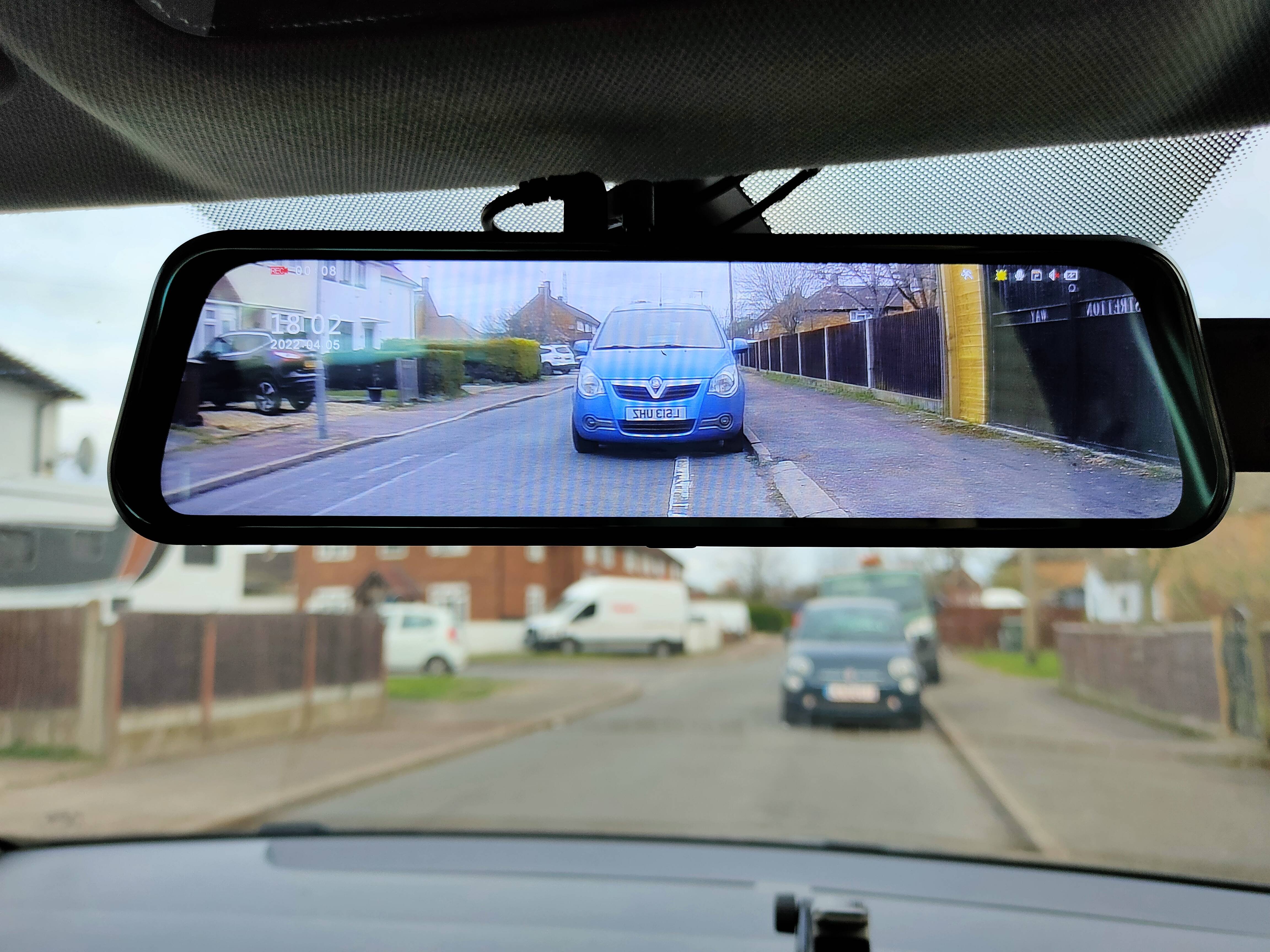

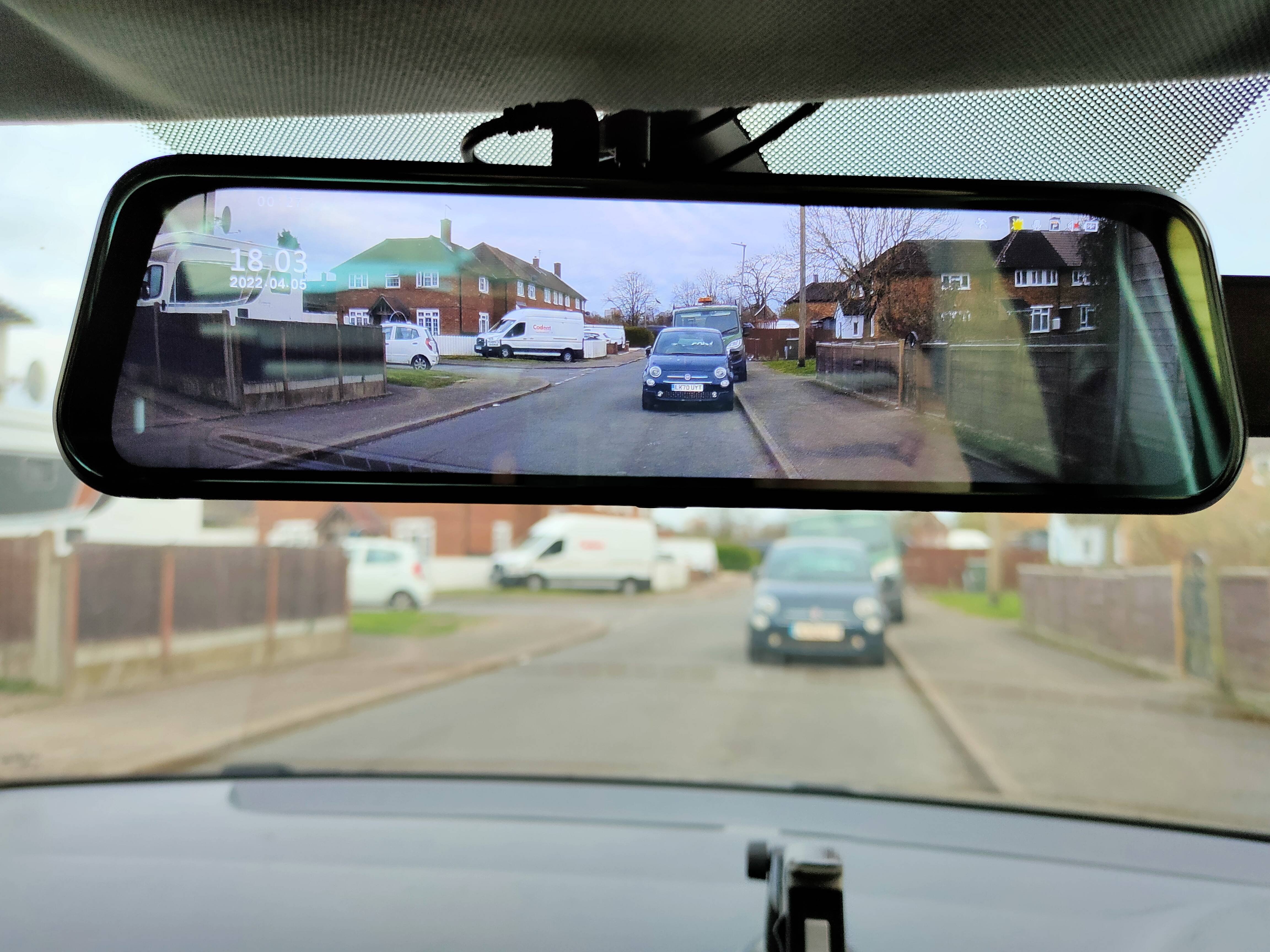

So, relatively straight forward to install. The kit came with a little orange but of plastic.
I put a couple of zip ties on the cable in the headliner to help keep them up there (read it on the internet that they help).
I just need to run the rear view camera now. Same, same but different :)

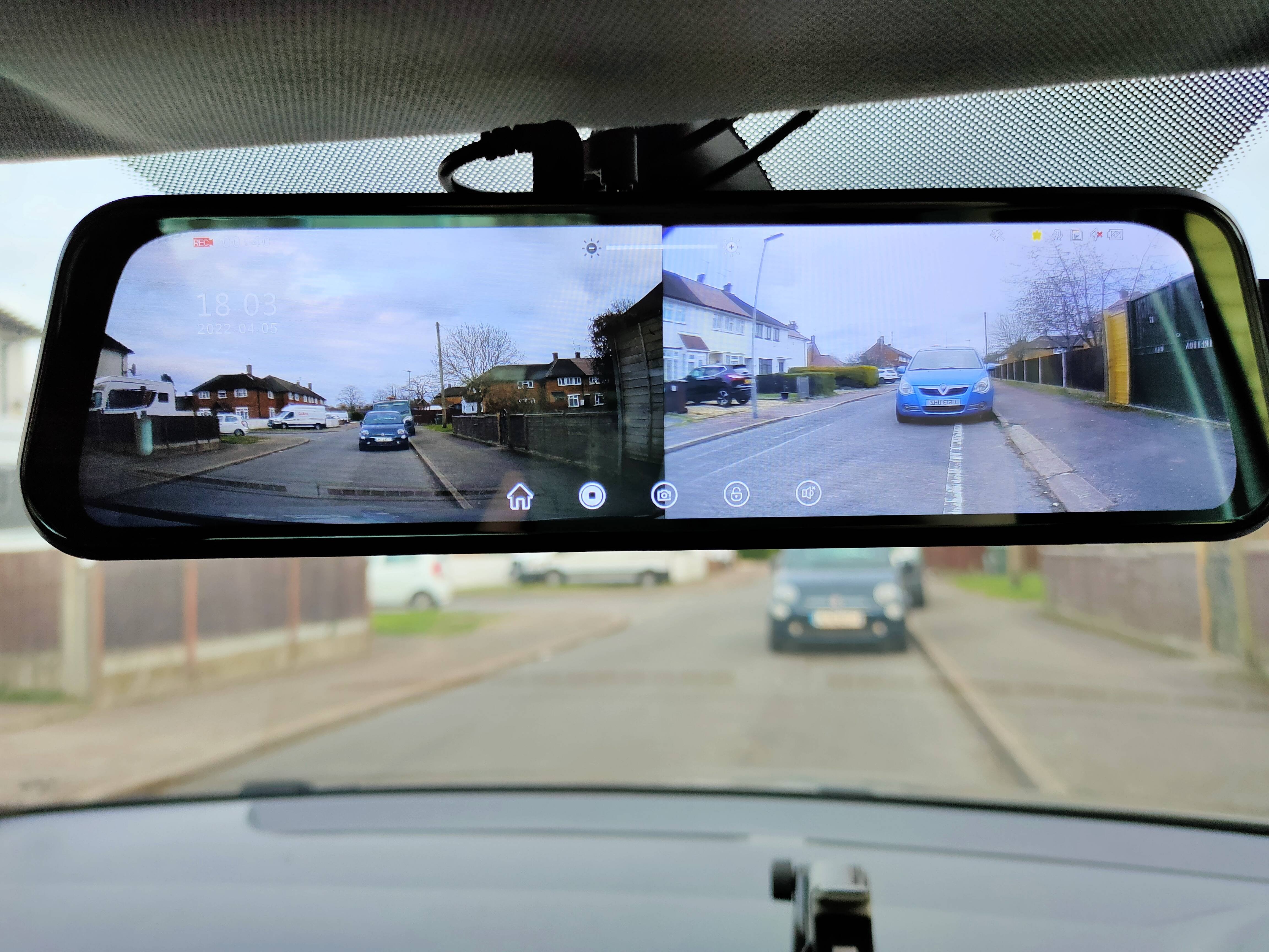

For  CCTV option you should get 12V permanent, 12V ACC and ground (somewhere under dash). When CCTV is active you should get menu to set up time and frame rate (1frame/sec, 2 frames/sec)...

I do like it very much...  First as DVR (front and rear), second as rear view mirror and backup camera. On top of that as CCTV ...
