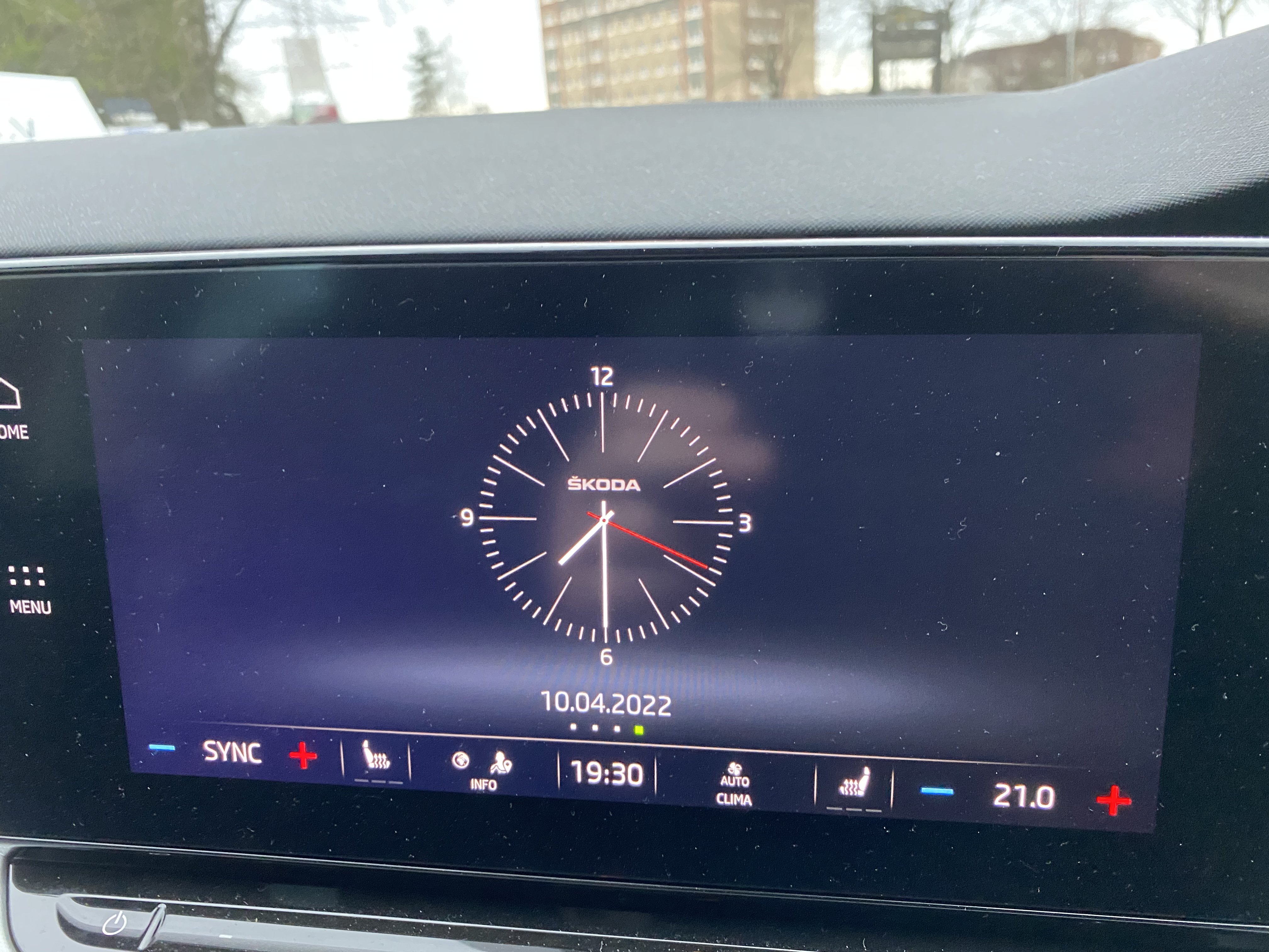

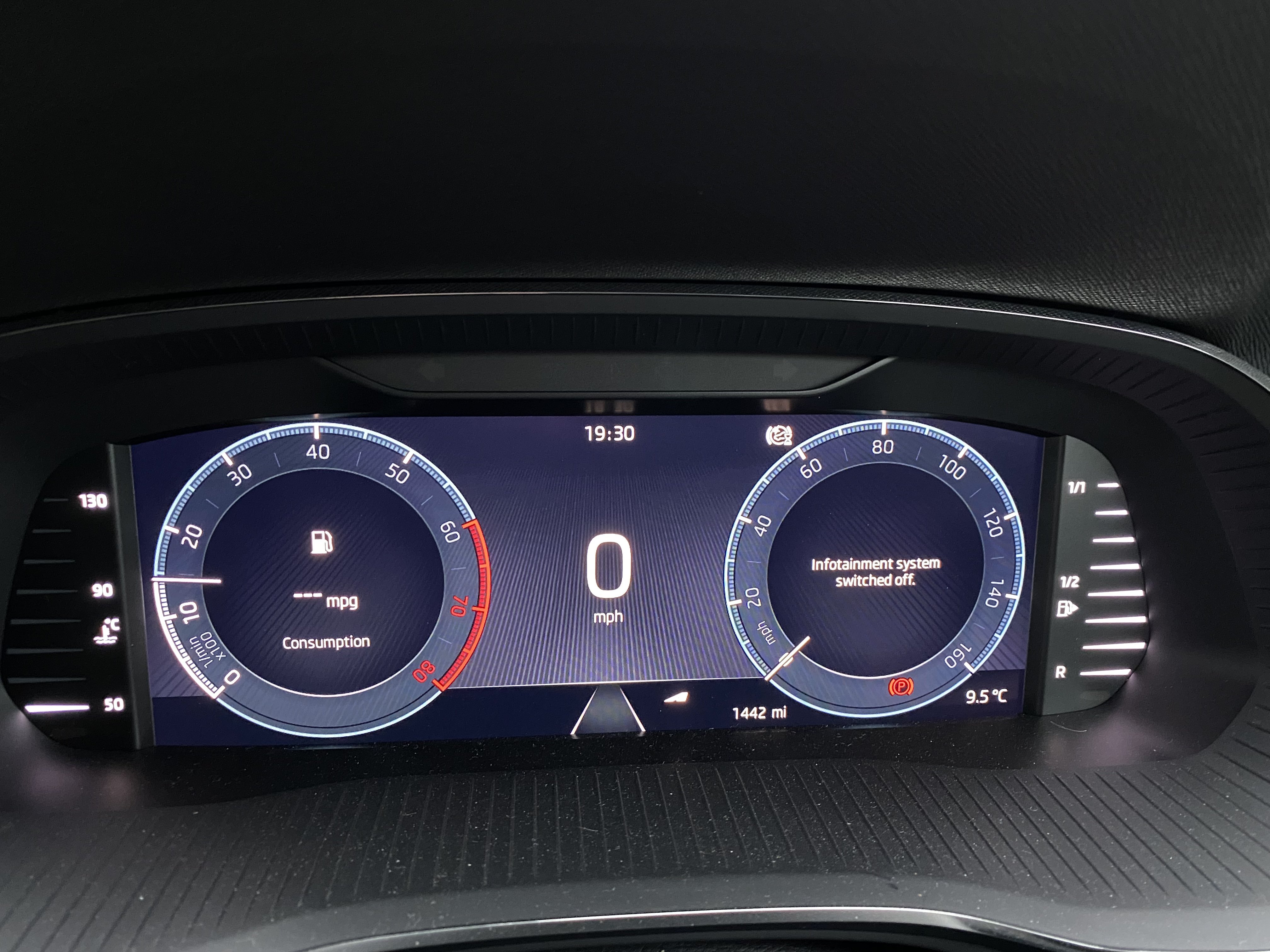

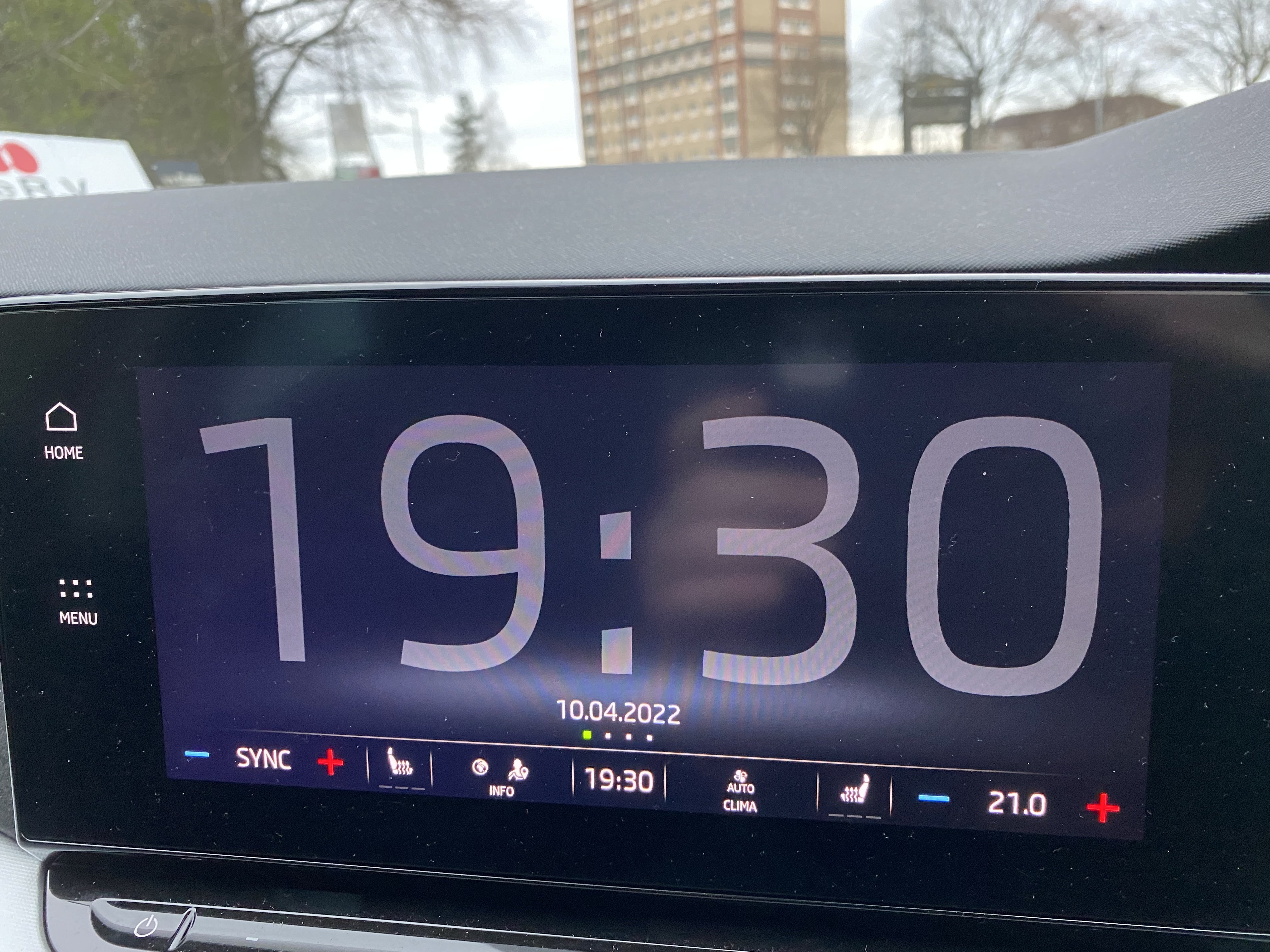

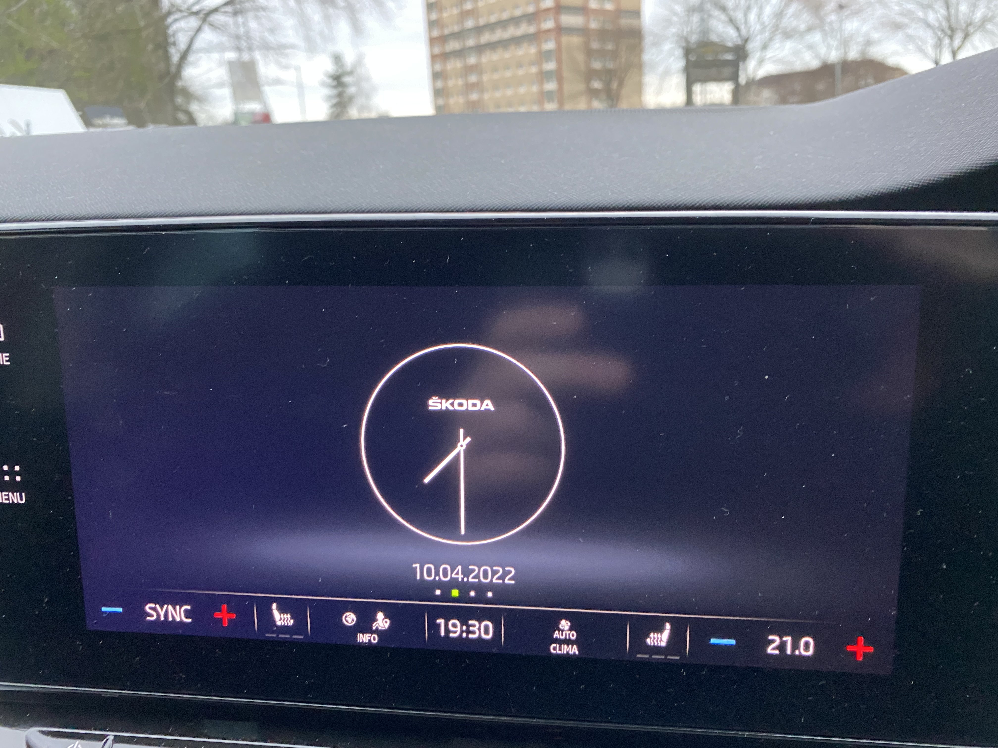

Trying to change radio stations using Favourites Menu, it changed selected station  preset to the one that was already playing, giving me two of one channel and none of the other! Tried to reset it but it wouldn’t accept the original channel. Screen suddenly went black and then came on with a different menu, i.e. four different screens showing either date or time. Infotainment showing as switched off on main dashboard display and no way to use Infotainment System at all. Home and Menu completely dead.
Phoned up dealers on Monday, thinking maybe there would be some way to reset it but seems not. They were talking about not being able to look at the car until late April. Their solution, leave the car with them for a few days and they “might” find time to look at it but no courtesy car on offer during this time. Ended up talking to ŠKODA directly, they booked my car in to a different dealership for April 21st. Leaving me with a virtually brand new car with no radio or sat navigation for weeks. Has anyone else seen anything like this?

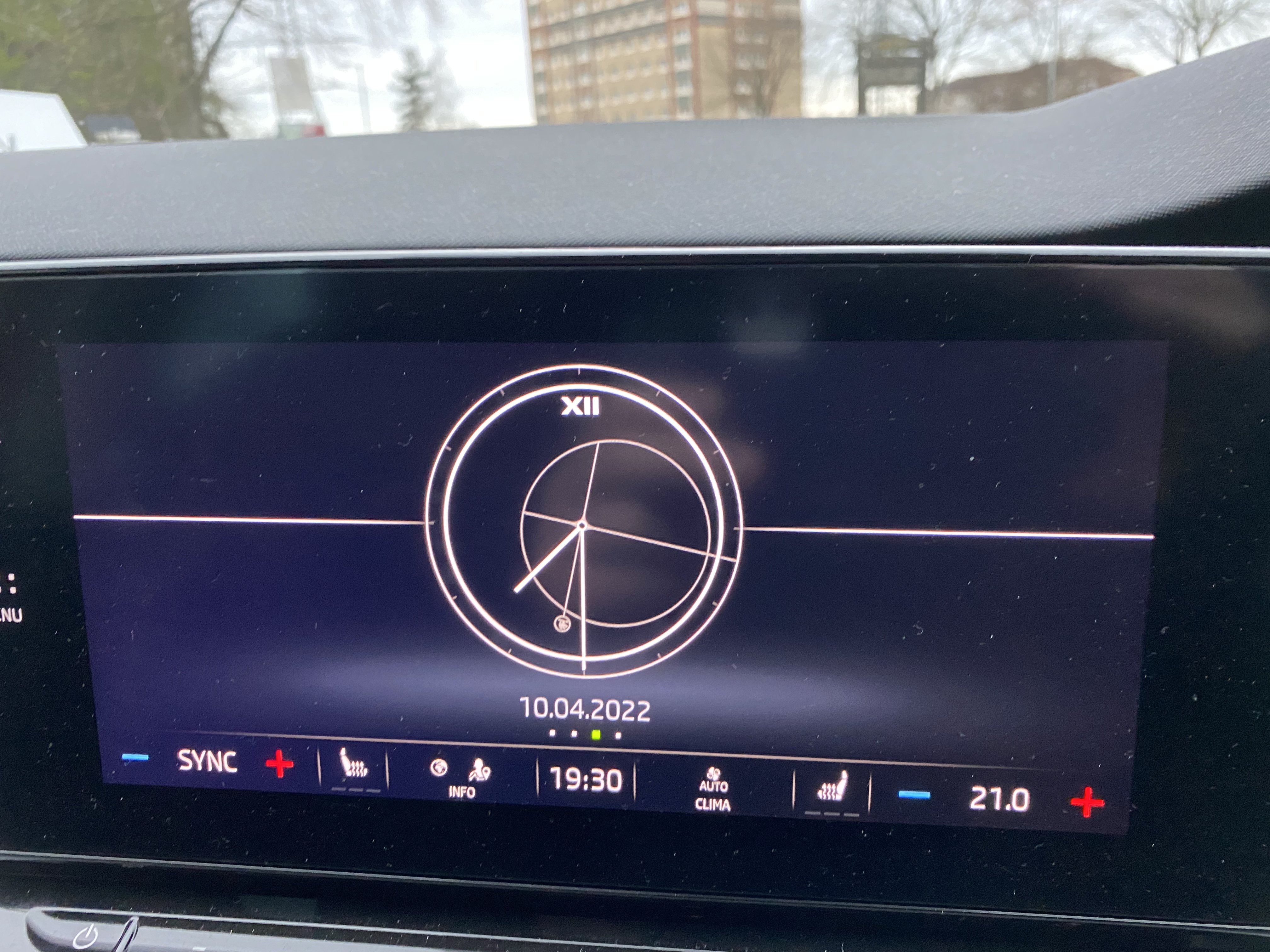

The other two screen “options” !

It kind of looks that way! Couldn’t understand how there wasn’t any apparent way to turn it back on, especially when dashboard was displaying message saying Infotainment System Switched Off. Usually things that are switched off can be switched back on again.
