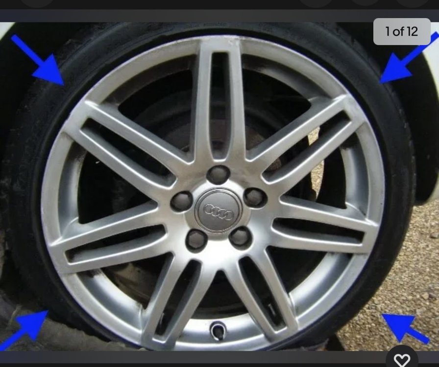

Hey I have done some searching and I’m still not sure can 18” Audi A3 wheels fit on the mk3 octavia I believe they will stick out a few more mill but nothing major ?
And has anyone done this ?  Any cons ?

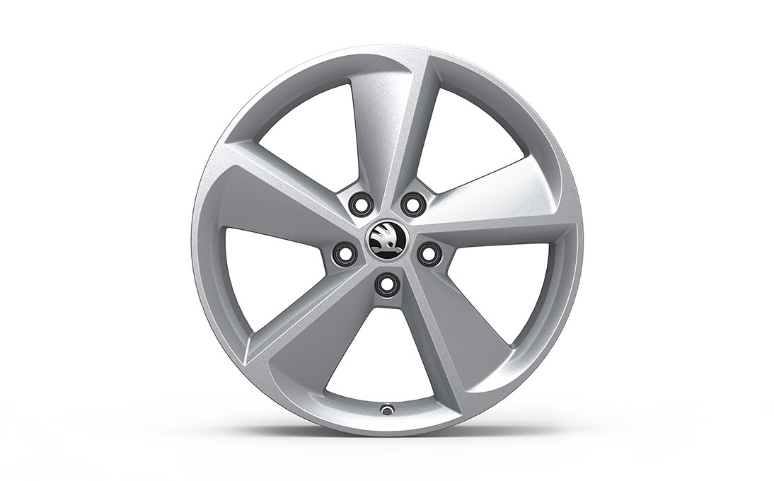

I think the Golus alloys are the best looking 18" wheel for the Octavia & seen similar fitted on Audi's if thats the style you want.

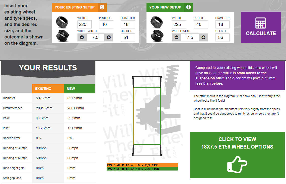

Compare the offset and width against your current wheels using something like https://www.willtheyfit.com/
Otherwise, check the PCD and centre bore also match :)

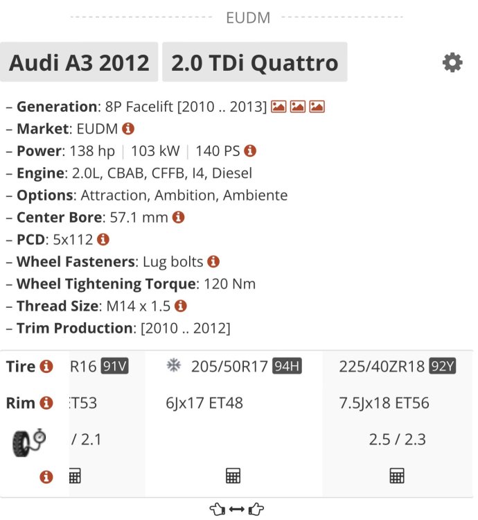

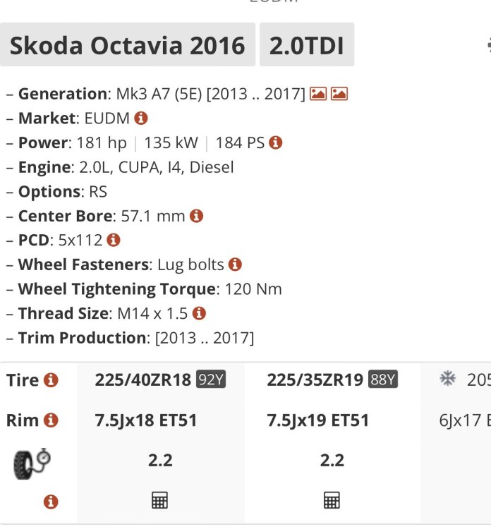

these are the differences all the same apart from ET 56 vs 51 so as I understand these would mean that the Audi wheels would stick out 5mm more ? 4D31EC07-1D72-4D25-80AB-A9BCF39B7E6E.thumb.jpeg.914c72b36e41b43148f87c54bc9454cb.jpeg431F189D-C76C-4C3A-A2F2-7B9C7151A487.thumb.jpeg.79417bc671dc84ea1023d2765e23b828.jpeg
Nope, they would stick in 5mm more so a 5mm spacer would restore the original offset:

Most of the Audi A3 cars that were based on the VW Golf MK5/6 platform had 7.5Jx18 ET54 rims, not 7.5Jx18 ET56. There was a 7.5Jx18 ET56 rim, but not the most attractive rim.
5 8P0 601 025 AJ aluminium rim
colour code:
7,5JX18H2 ET56
5/112
8Z8
4 PR-CC1
https://audi.7zap.com/en/rdw/audi+a3+s3+sportb+lim+qu/a3/2005-412/6/601-601080/#5
As you have an Octavia MK3 that is based on the VW Golf MK7 platform, I suggest you look at Audi A3 rims that were also based on the VW Golf MK7 platform. There's plenty of 7.5Jx18 ET51 rims on that Audi.
https://audi.7zap.com/en/rdw/audi+a3+s3+sportb+lim+qu/a3/2016-745/6/601-601080/
This is not a bad looking wheel
thanks for this so a 5mm spacer would work
Thanks all for advice so looks lovely a 5mm spacer or get VW style

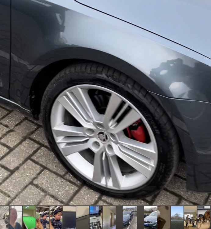

the wheels I have wt the moment are
they are ok but not my cup of tea

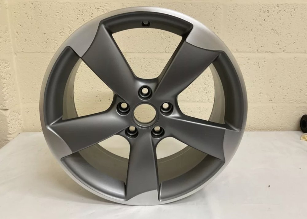

looking at either black edition or sline wheels as below
529BF6A9-C133-403B-8A4C-0A3B8873F834.thumb.jpeg.3784f48e2be158ce097be7d91c9e9137.jpegD9F961D2-751F-43CB-ACB2-7413023FA726.thumb.jpeg.ee7ad10e4d81d770aaed4454f204432c.jpeg
