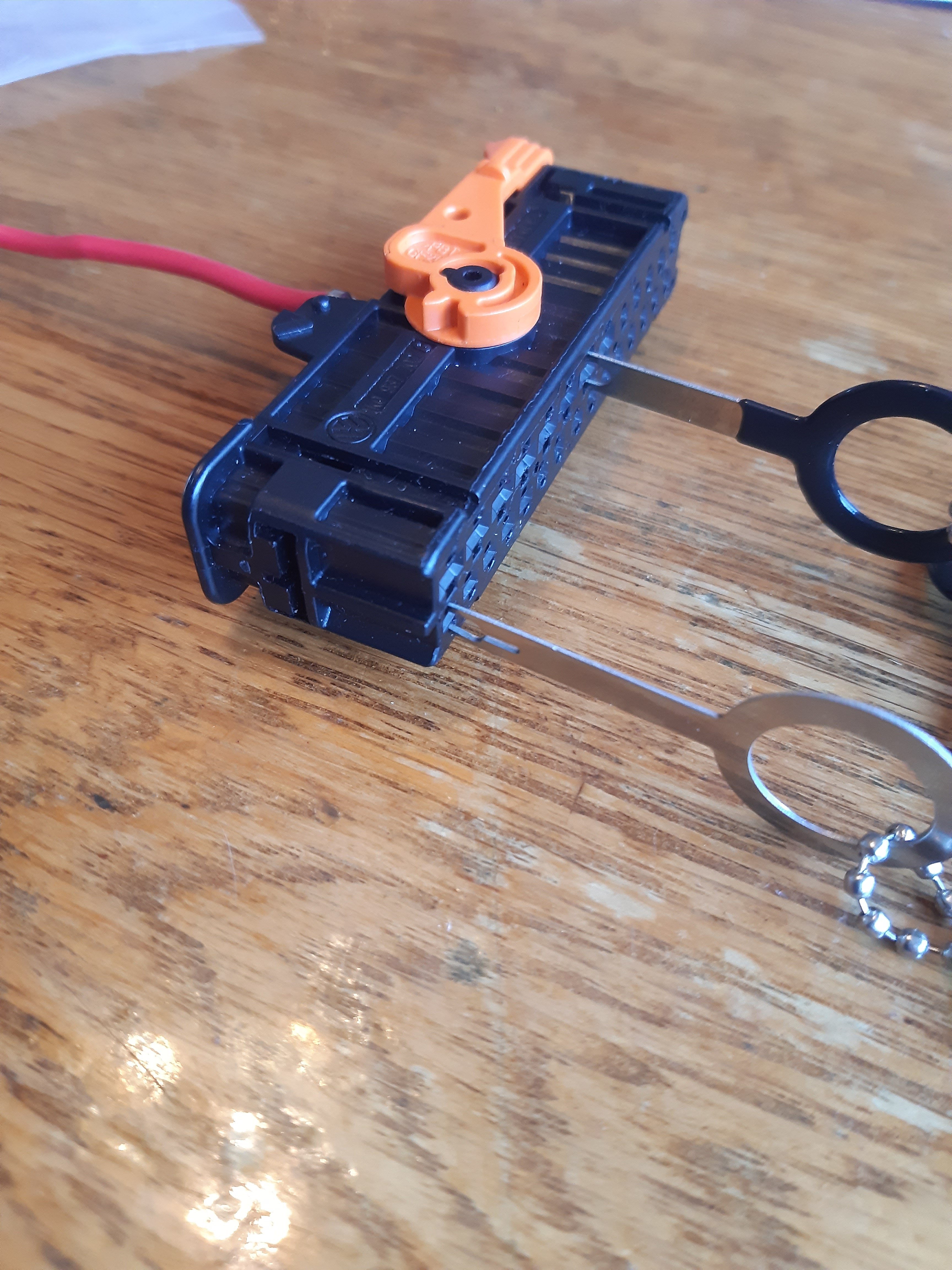

I've ordered one of these kits to remove the connector from the chassis loom from Amazon (it should arrive today):
https://www.amazon.co.uk/gp/product/B07S8PS4FY/ref=ppx_yo_dt_b_asin_title_o00_s00?ie=UTF8&psc=1
... have I bought the correct item?

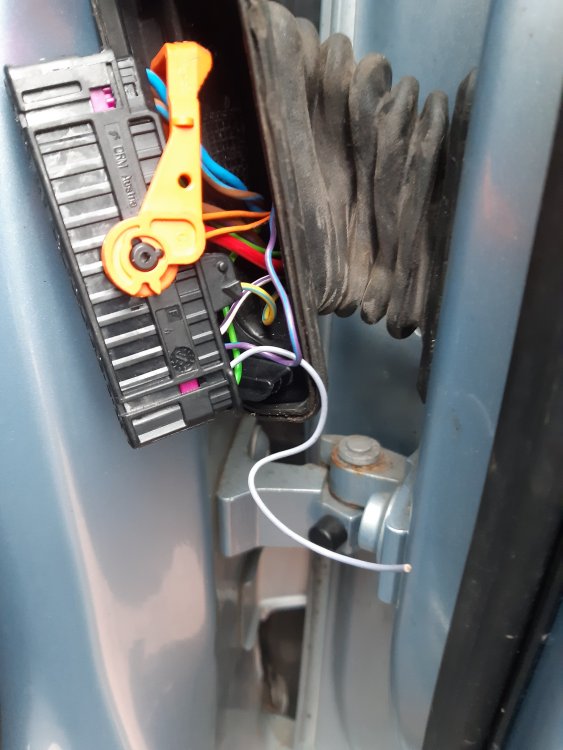

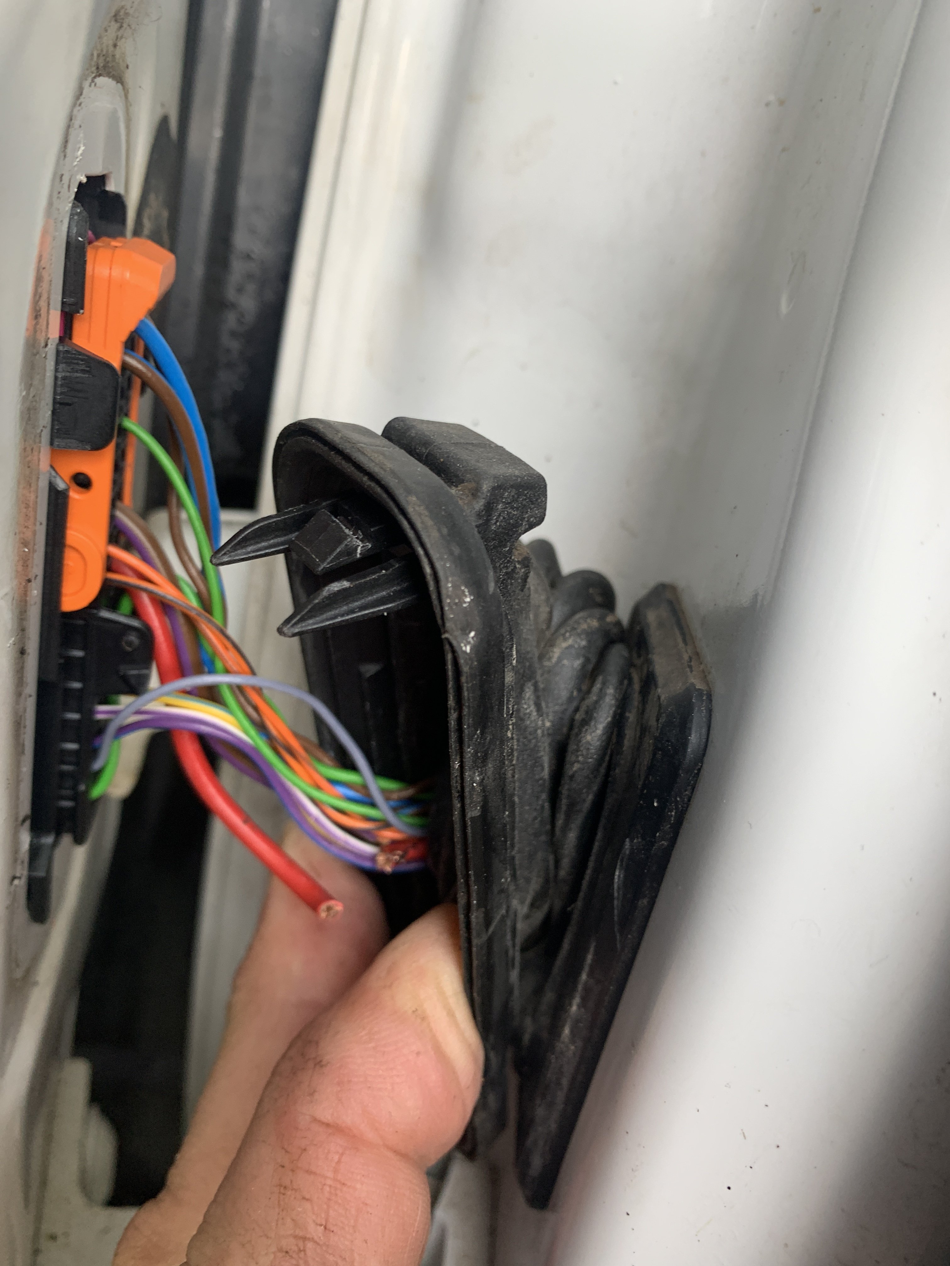

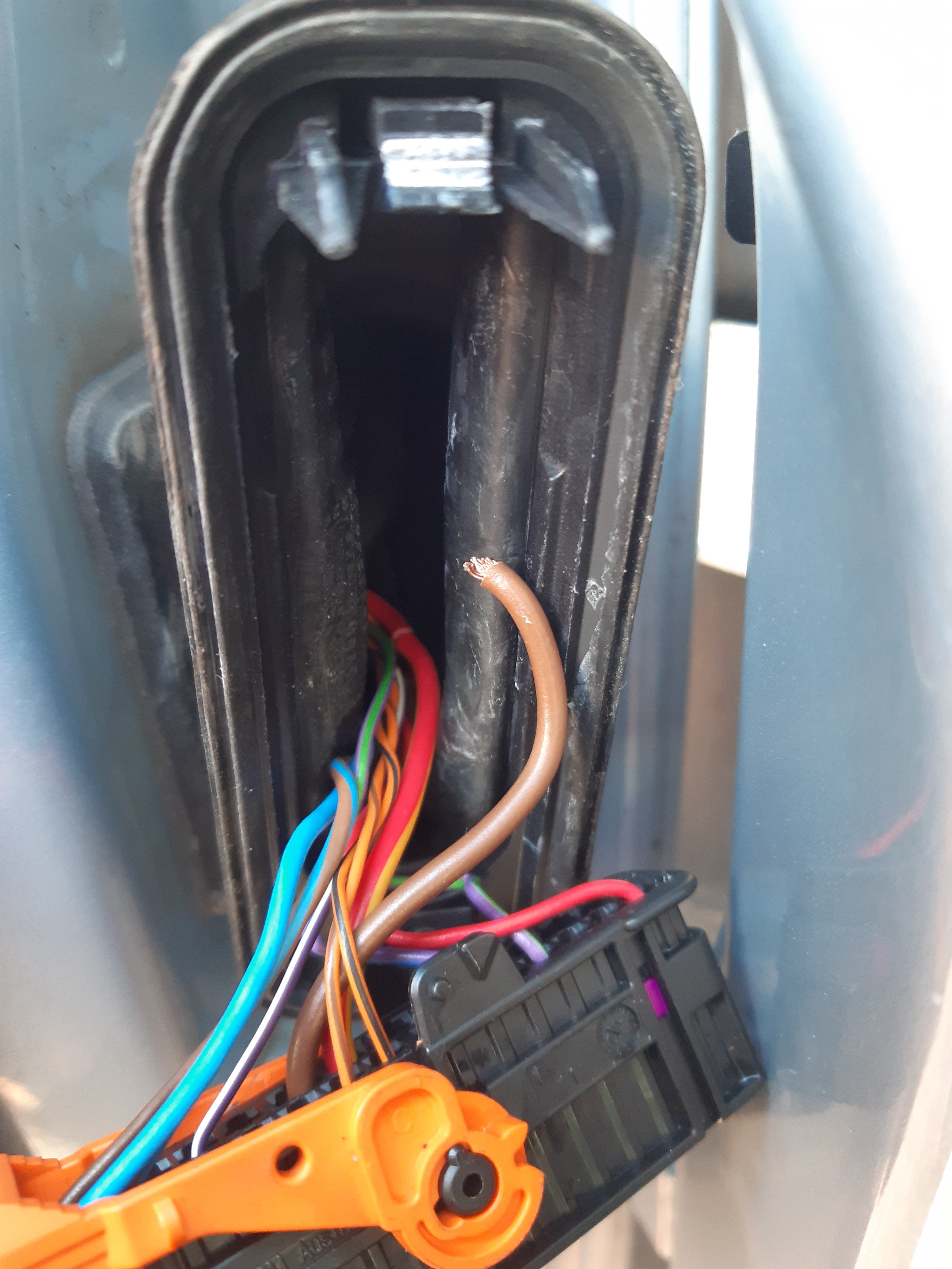

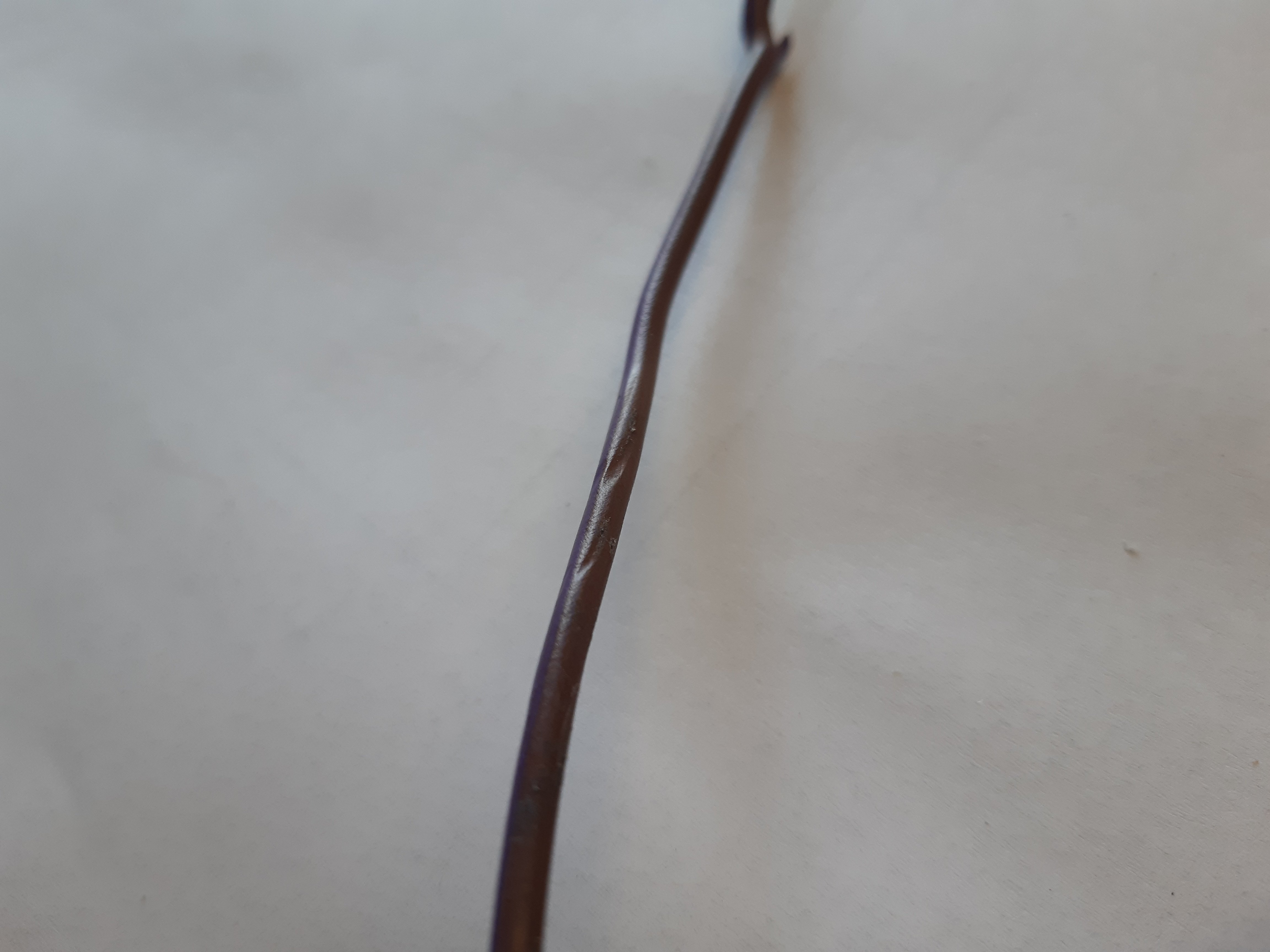

I got round to pulling the rubber grommet off the chassis plug today, and found that the thick red wire has broken, but as far as I could tell it was the only one that had severed through and through (see the first photo). I am guessing that prior to me removing the grommet it was only touching sometimes and hence causing the intermittent fault. At this point none of the functions to the door worked, I surmise the thick red wire is probably a common 12v +ve feed.

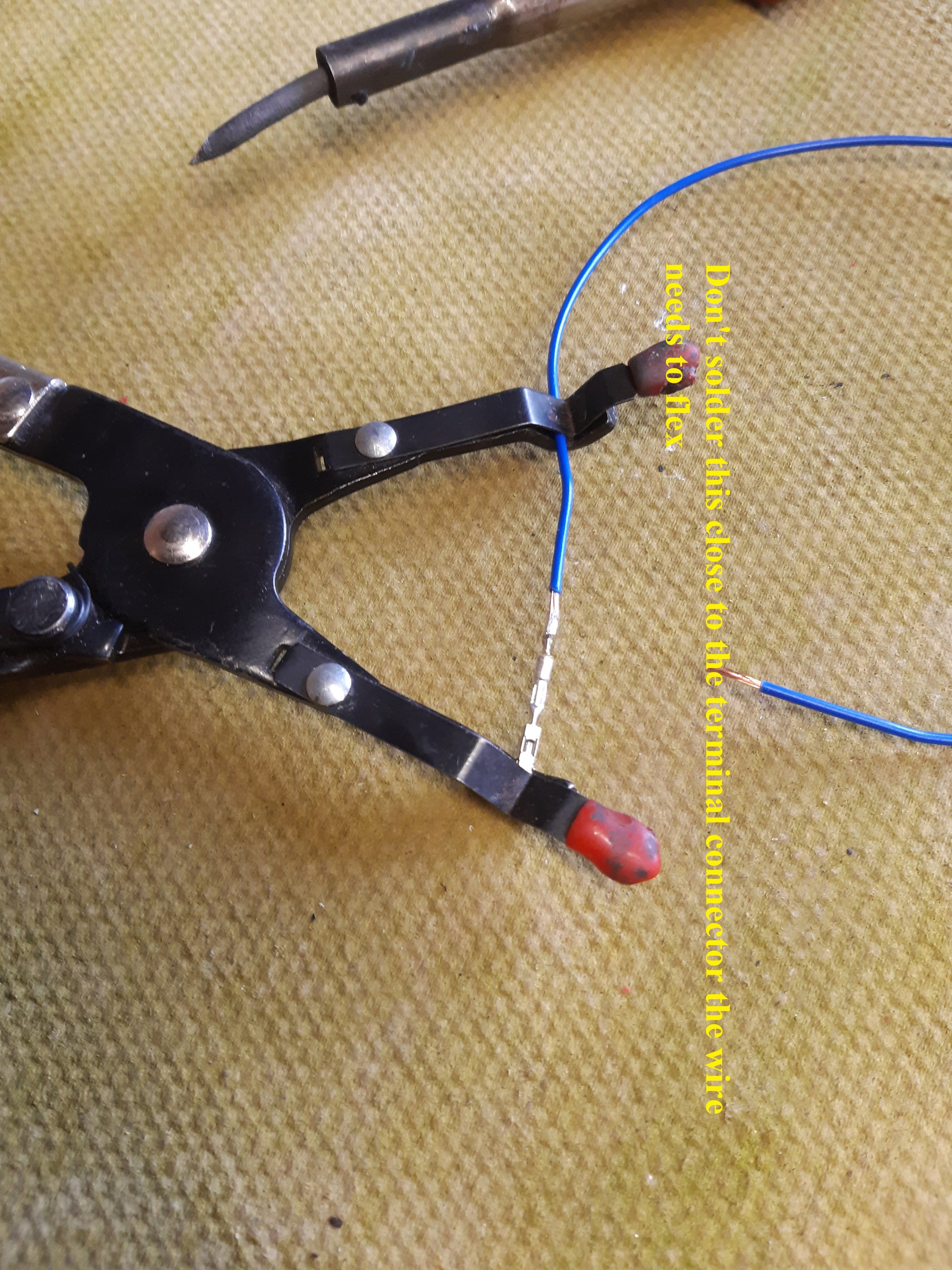

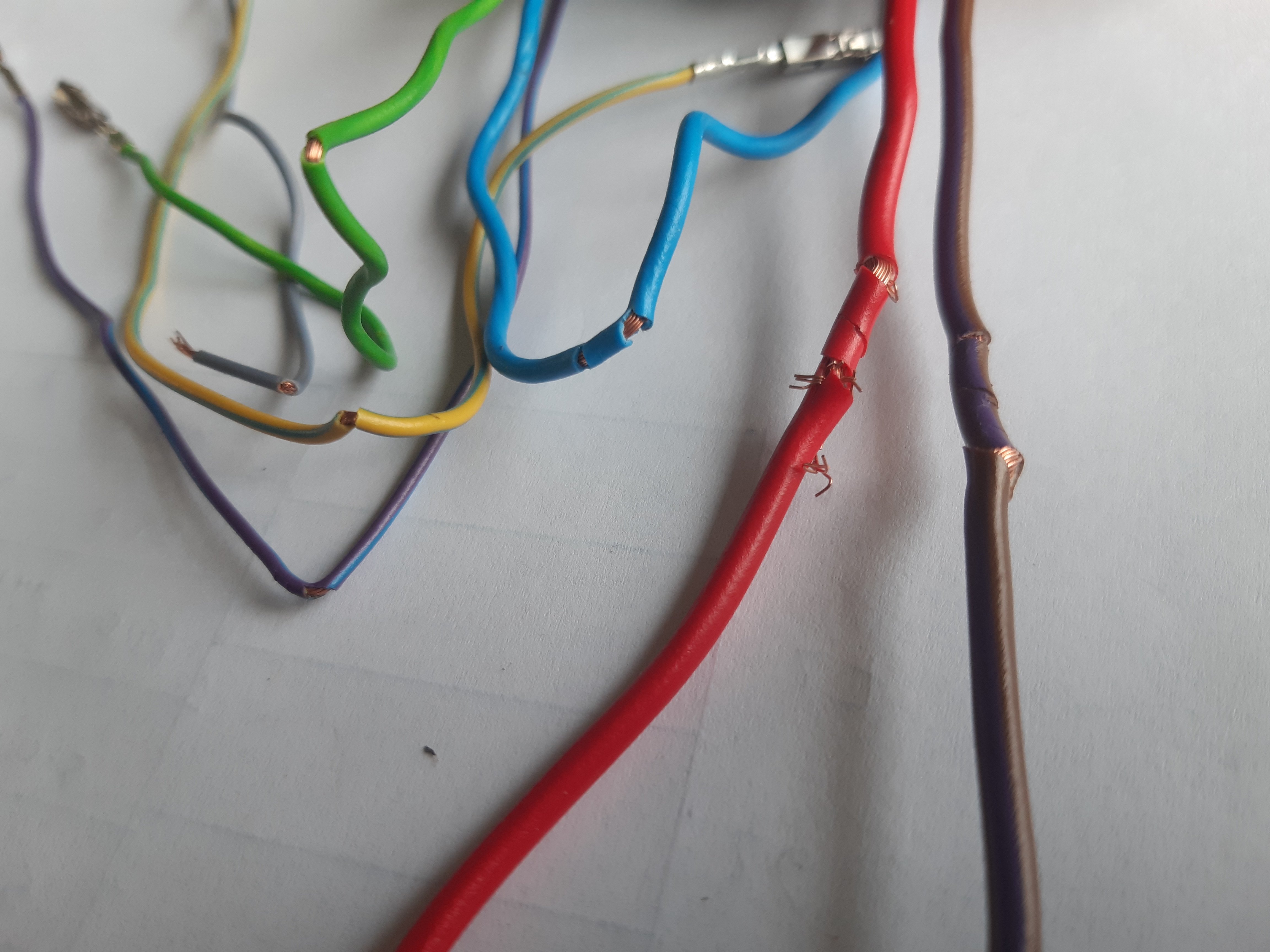

I thought it was probably worth having a go at a fix today. I managed to strip back just enough of the red insulation to allow a self-soldering joint to slide over both ends of the break, inserted a thermal shield (i.e. piece of cardboard) between the red wire and the rest of the bundle to prevent collateral damage, and very carefully melted the solder with a 175w iron. The joint had its own shrink wrap, so that should give some mechanical protection (see second photo):
The break had been close to the door end of the wire, so I couldn’t get the soldering iron close to that end.
Now I seem to have full functionality of the door: central locking, mirrors, windows and speakers, so this appears to be a good quick win for the time being. The wires are quite brittle, so this probably isn’t the end of the story. I have ordered the repair patch, so I think I’ll still take the door apart and fit it next weekend. I’ll report again when I do that job.

Nicely done, hopefully keep you going for a while

You've done well to get in and do that repair in such a confined area. Like you I've found the forum search function doesn't seem very good?  Google seems to do a better forum search of the forum?
Though personally I think you'll have a re-occurrence at some point if not with that wire it will be with another wire breaking as others have posted in other threads. The insulation hardens and losses it's plasticity cracks and the wire work hardens until that eventually breaks due to the doors being opened and closed twisting the wires back and forth.
I've replaced all the wires in the door hinge area on both front doors. The common earth to the front near side passenger door broke which meant neither of the near side door functions worked. Fortunately the wire failed with the doors unlocked so I could open the door. I found other wires that were also in poor condition. On the drivers doors one of the central locking switch wires had broken and again I found other wires in a poor condition. Also on the tailgate had to replace a length of negative feed for the same reason as the heated rear window wasn't working. It's common issue right across the VW, Skoda, Audi, Seat range with cars of this age.

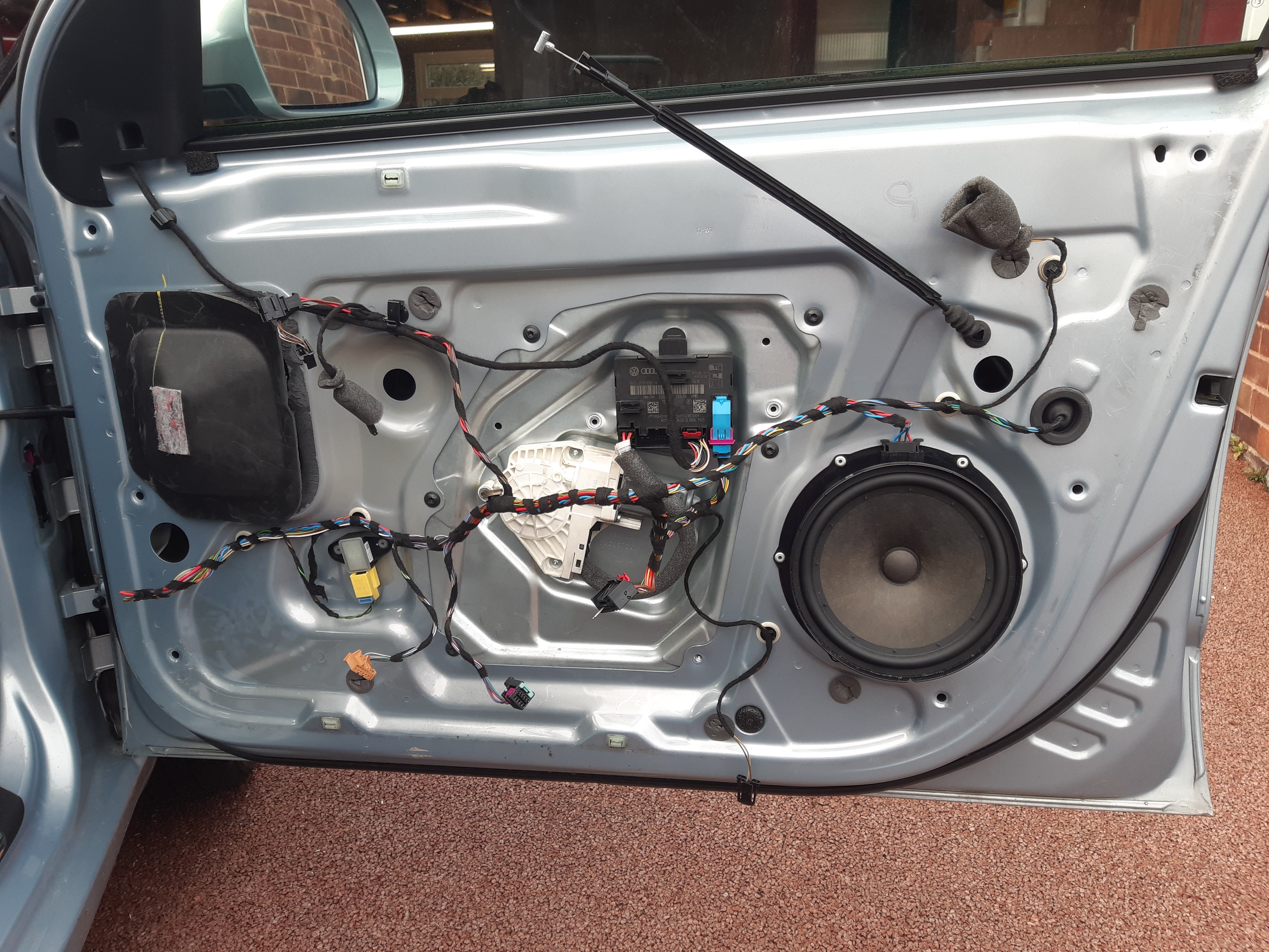

12 hours ago, Othen said:

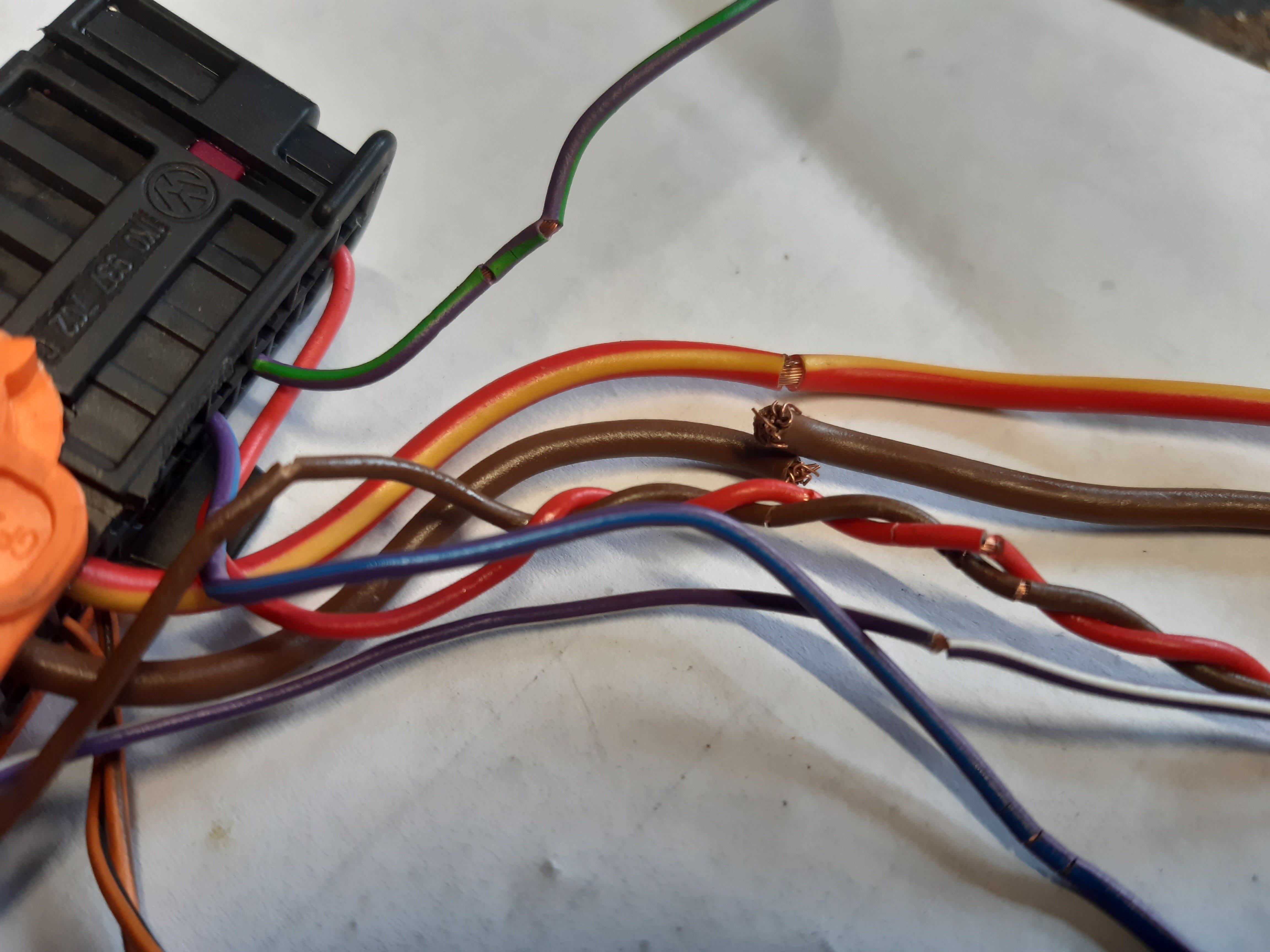

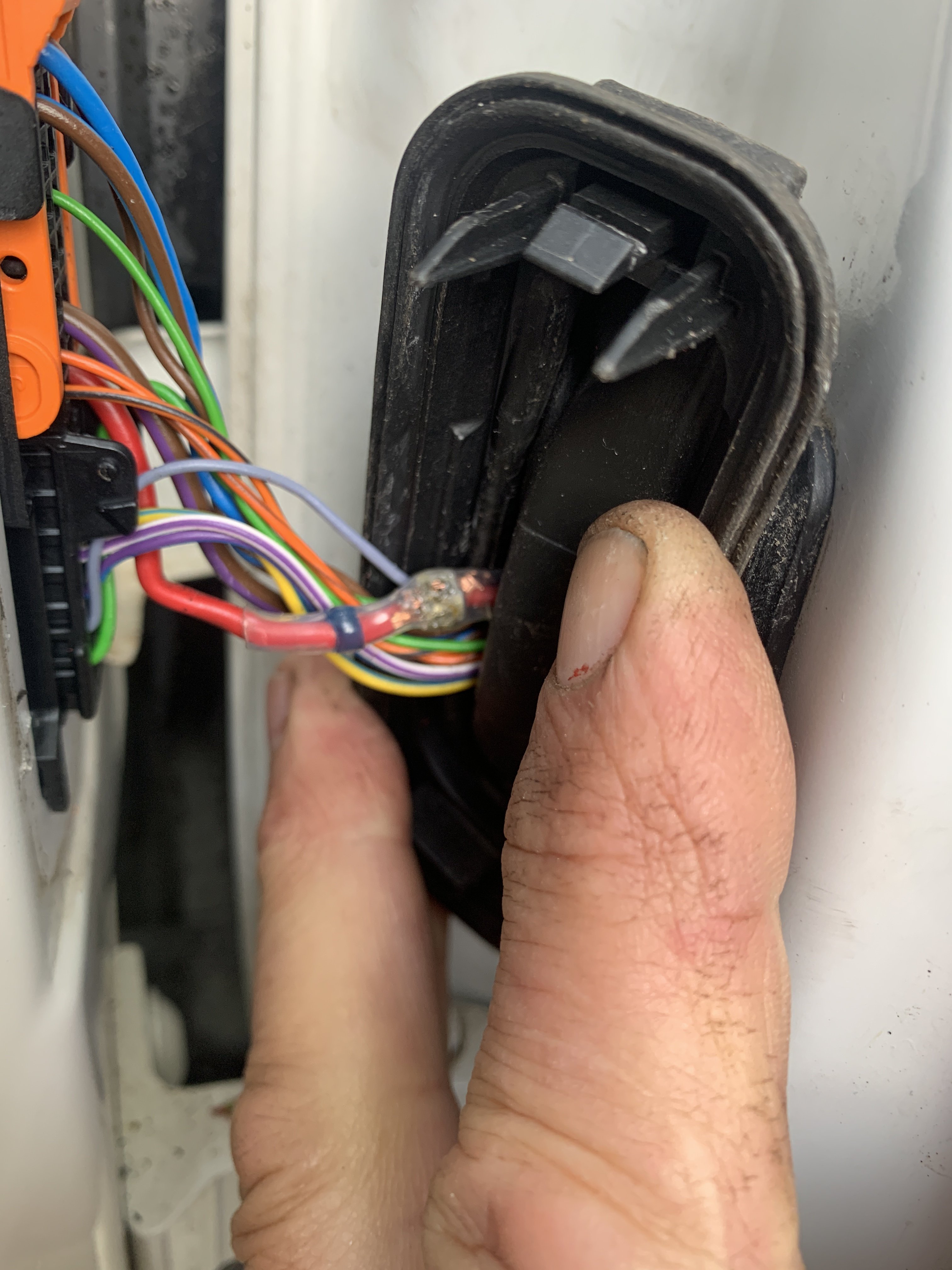

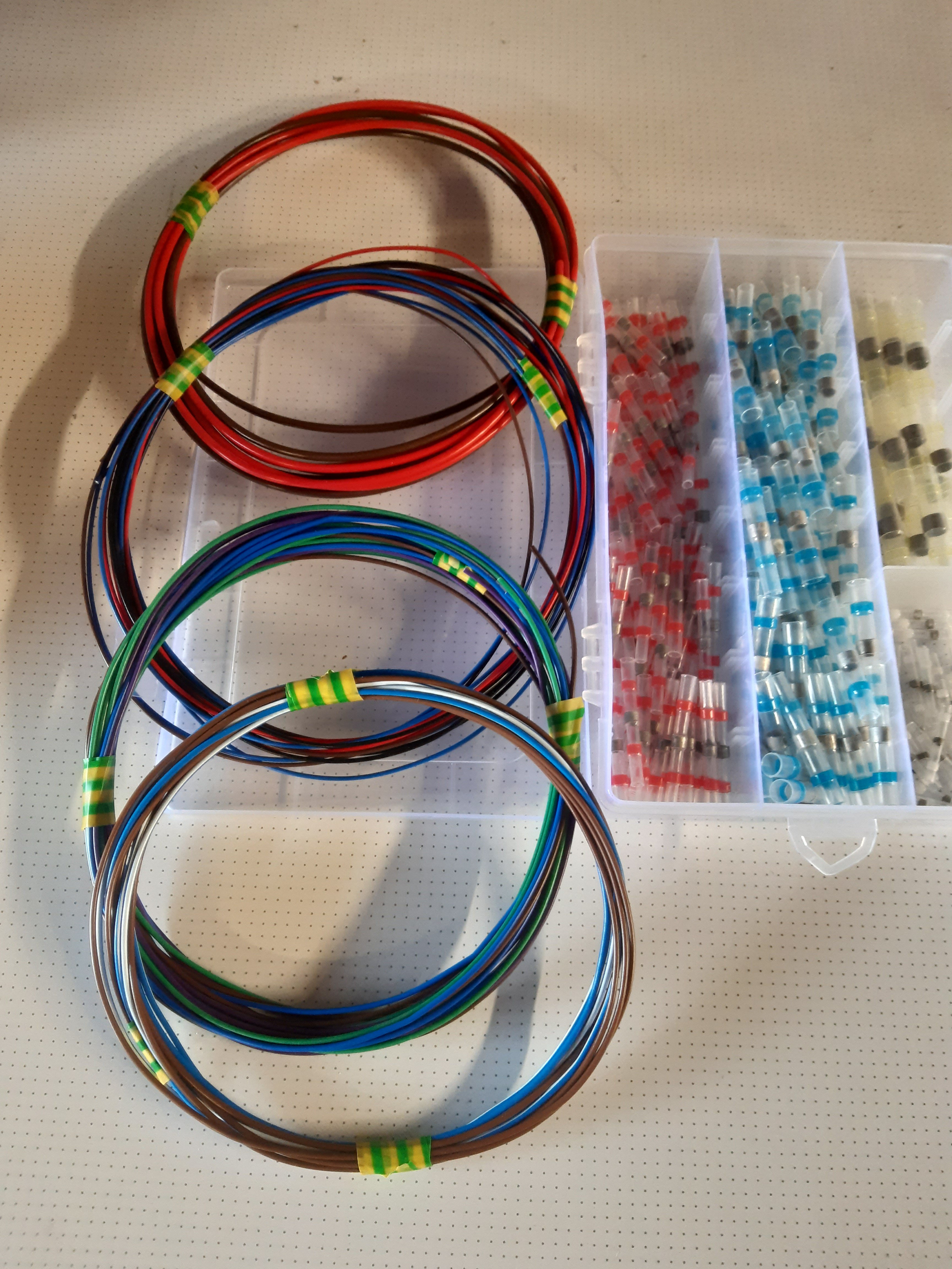

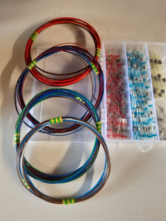

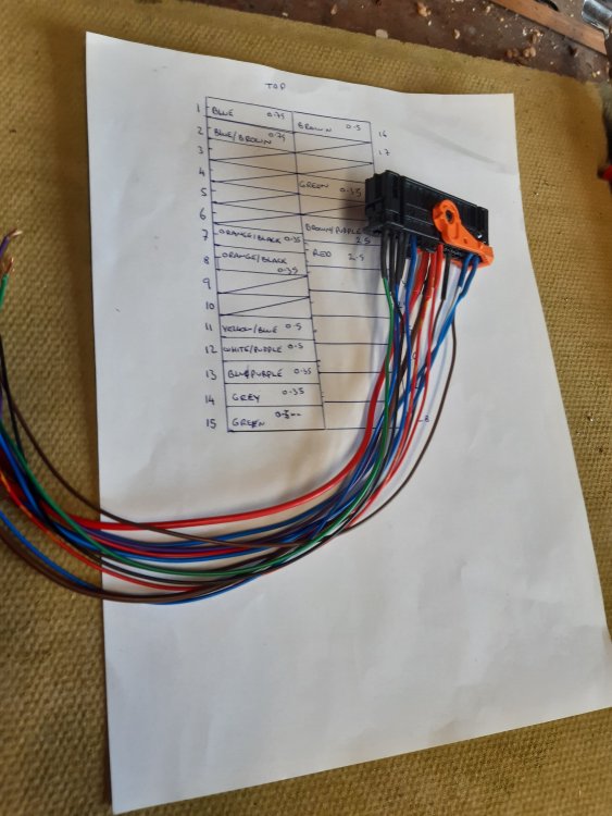

If what I've read  is right it may not take me much longer to fit the kit with 10-15 self-soldering joints as it would to take the door apart and fit a new loom.
I personally doubt you can complete an effective long term repair without removing the door cards to get access to remove enough length of the old hardened insulated cables and make a new joint away from the area of movement where the damage occurs.  The cables are taped to the rubber gaiter so cant be pulled through till you've removed the tape and to do that you have pull the gaiter  in through the door to cut all the tape off. I had at least one wire which was broken right down inside the gaiter as well as several damage cables.
I didn't bother re-taping the new wires to the gaiter as it made it easier to slide and adjust the wire lengths to the door pillar.
Yes it would have been quicker and easier buying a loom repair kit at around £30 per door. But being between jobs at the time and on a tight budget and having the time, I replaced around 240mm of all the cables on both of my front doors and made the connections where they were easy to solder and put them just behind the round door grommet where the loom goes into the door. You don't want too much excess wire inside the door as the loom passes close to the window runner
there are 4 wire thin wall insulated sizes.
Ø2.75mm = 2.5mm²  29 Amp
Ø1.75mm = 0.75mm²  14 Amp
Ø1.5mm closest I could find  Ø1.6mm = 0.5mm²  11Amp
Ø1.2mm  closest I could find  Ø1.4mm = 0.35mm²  7Amp
On my Superb SE there are 13 wires on the drivers door and 11 on the front passenger door both connectors have 28 pinouts so I don't know if the higher specification cars have additional wires?
Thank you so much, that is all really helpful.
I certainly wasn’t implying that I might attempt this job without removing the door card! This week’s quick fix in the door hinge was a one-off and would not work with a dozen or so wires.
I have a patch kit arriving this week, but otherwise my plan is the same as yours:
a. Remove door card.
b. Snip wires to the connector.
c. Assemble new connector and wires.
d. Pull wires through to the door space.
e. Make connections within the door space (self-solder joints like the ones you used).
f. Reassemble.
The photos are particularly helpful, thank you.
