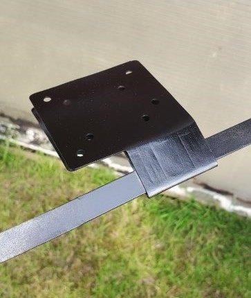

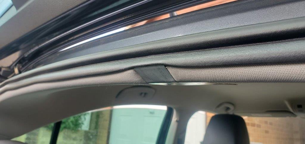

My working solution was something I had found on a bimmer forum.
Using what I had available I made this bracket (from a spare joist hanger bracket, lots of hammering, bending and satin black spray paint).
Here it is fitted, off centre as there is a plastic trim clip holding up headliner.
And here it is with the dash camera fitted and the cable tucked into the headliner and into the C-pillar.
672195427_20220423_182112-Copy.thumb.jpg.ca57674713ed5c6380373ed23e7eec32.jpg713662434_20220423_182223-Copy.thumb.jpg.567b27b575bdd0b7f5f85474ca505e6a.jpg
I might take it back out and re-adjust the angle so that it fits into the headliner better (or remake it entirely). The only issues I have is that the rear view is off centre and further back than before. The view is also slightly obstructed by the upper brake light cover and parcel shelf. However I have full DAB reception now with this set up, so I can listen to some tunes other than my own (and traffic announcements). 😁

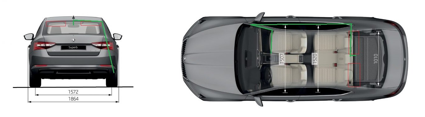

I am thinking of running the cable through the headlining from the rear, to one side of centre, so it passes by the centre light and the front centre light assembley and comes out by the clip (not swivel side) of the passenger sunvizor - planning to use an electricians style cable puller thingy to push through from back to front.  I am currently working out how to do it and have a few ideas from looking (A) Skoda air bag safety brochure which shows where all the air bags are (2) the repair manual fpund on this site which shows how to remove parts and (3) the parts listings off catcar.info.
My next step is to 'hang' the rear dashcam cable from the headlining (fasten a few strong cotton threads around the edges of various fittings) and experiment to check for interference.

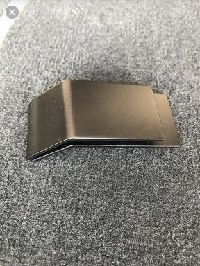

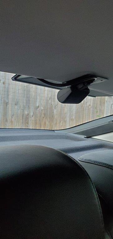

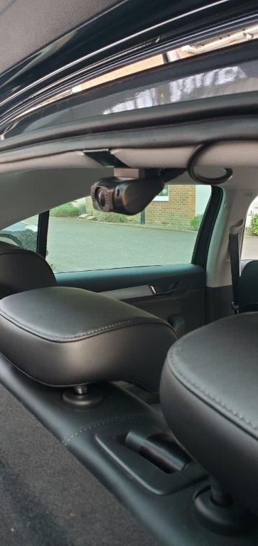

I've fixed mine on the boot trim:
With a slight mod to give it an OEM look (using an OEM inside review mirror trim) :
