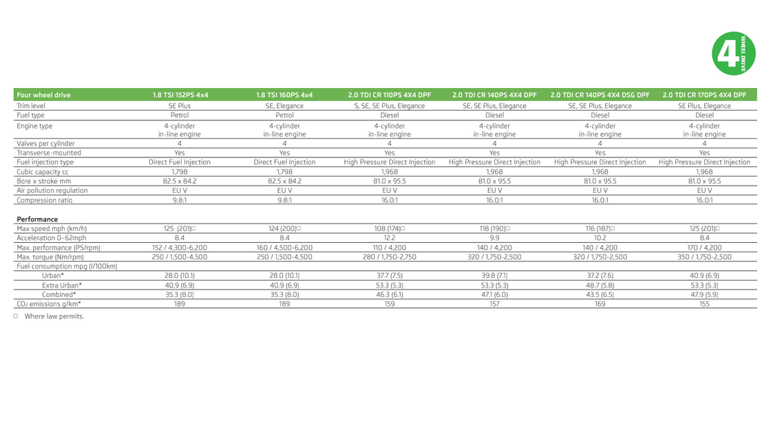

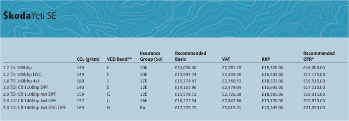

hi the skoda yeti you are looking at is not a 1.8  it will be 1.2 tsi petrol or a 2.0 ltr cr diesel if its a 4x4 i would say its a 2.0 ltr diesel as i have a 4x4 2011 yeti only came with 2.0 ltr cr engines very good engines as my has done  145000 with reg oil changes lovely car to drive on a long jounery dsg 40000 halex 30000 here costs £300 for both i get well into the mid fortys mpg

This is from the April 2012 Yeti specifications.
And from the dealer website.
And in 2010.
I believe the yeti was available from launch with the 1.8 tsi engine.
I had a 2010 1.8 tsi 160hp 4x4 elegance and a 2013 1.8 tsi 160hp 4x4 L&K
I had a 2010 1.8 tsi 180 hp 4x4 elegance and a 2013 1.8 tsi 180 hp 4x4 L&K
👍 Yes brochure shows from launch in 2009.
It only disappeared in May 2015 when the new 2.0 TDI AdBlue engines were brought in.
