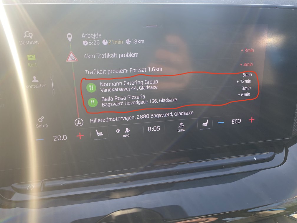

Hi all
In my iV octy the navigation suggests stops at restaurants and cafe on the route. Do anyone know how to make it stop?
All POI's is off and can't find any other setting that makes any change to this.
Hardware H58
Software 1889
NavDB 22.1
production week 3 2022

Click on the two gears icon at bottom left of your photo, then click 'Basic function settings' and then click 'delete usage pattern' and you should be sorted.
