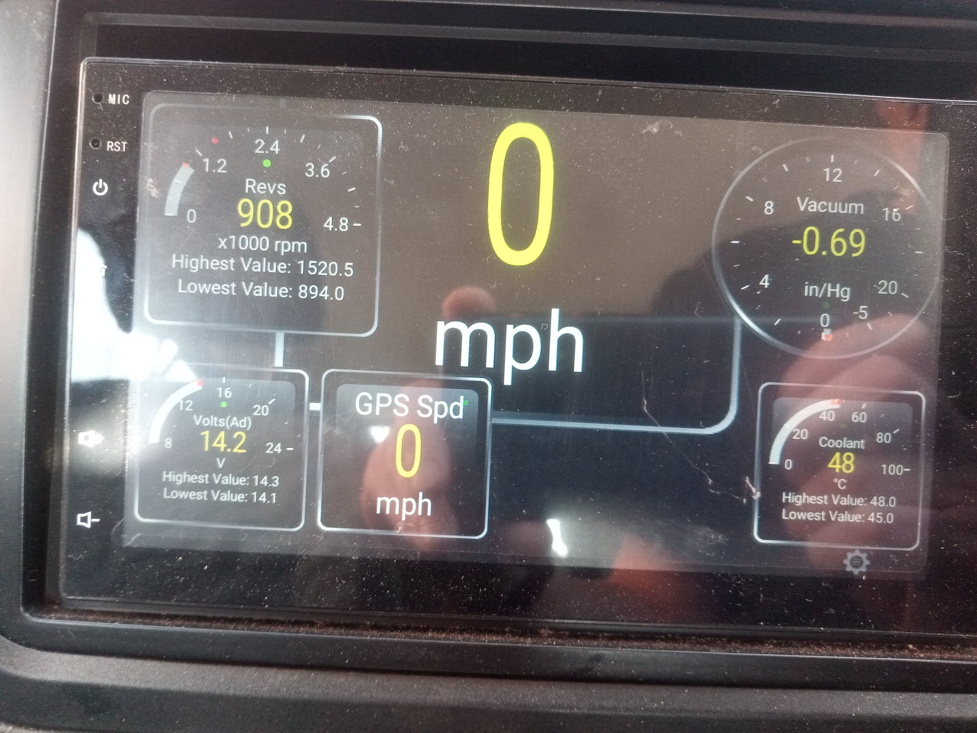

Often repeated comment by me - ODB2 bluetooth dongle and Torque app on an Android phone or tablet. With the phone in a holder in eye view while driving this is possible. I have an Android headunit fitted to use GPS and allow DAB, with a screen shot below - there are different gauges that you can chose. Unsure if car has an oil temperature sender. Smell and raised tick-over suggests DPF regen, and long run may correct this as the car may not have travelled enough distance to complete the regen. There is a app - DPF Free? - that may also be usable via the OBD2 dongle that would report DPF loading, that may be suitable for you engine code but not suitable for my 1.4TDI Greenline.

  This OBD2/Torque method identified a faulty thermostat issue on my Greenline which also just has just the blue light to indicate coolant below about 48 deg. Never heard of the revs/handbrake issue you are seeing so will be interesting to see if anyone else can supply feedback on this.
