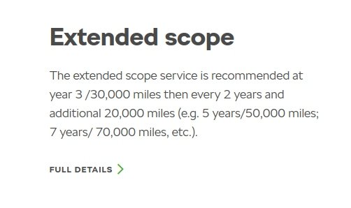

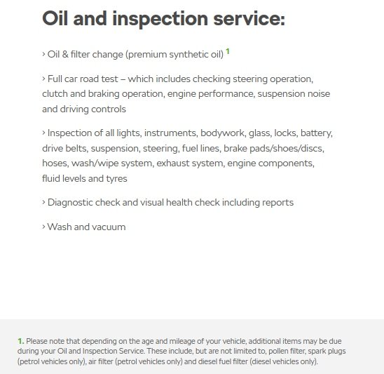

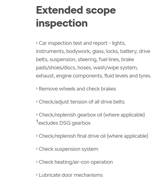

@terozone
What engine, gearbox, drivetrain has your Karoq?
This gives and idea of what Skoda UK has as recommendations.
(A DQ200 DSG does not require the oil change.)
1168293554_37335614_Screenshot2021-09-14at07_38_18(3).webp.ee5b8a609f78b3b2f42441d7532010fa.webp
