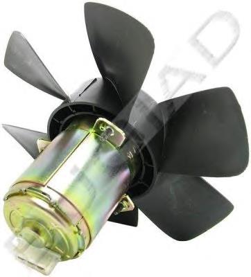

How one can take preventive maintenance on a radiator fan like this?
This fan was on the car when I bought it. I don't know its wear status.
How do I open it?
I want to check carbon brushes, bearings etc.
Last summer this fan was running like all time on. It's good to check before summer heat arrives.
I also want to clean carbon residues inside of the motor housing. They tend to create conductive surfaces. Which in turn, creates unwanted heat and electrical losses.
Since I can't edit my post above, I want to add that, I can't find any alternate fan from Bosch or any other reputable brand in my area. There are brands like Vika Ruby etc. (Importing is not an option at this time.)
After some research, I'm %90 sure, the fan currently I have is from a Felicia. This one has only one speed and possibly 70W. That means it's over 20 years old. 😱
I think I can open it by prying the metal edges folded over the back plate.
- Should I try to open the fan and replace the carbon brushes? OR
- Buy a new one.
Which one is more reliable? 20+ years old Bosch fan with new carbon brushes or a new aftermarket fan? (Vika)
(New fans are 120/200W two speed models. I'll use only the slow speed.)
I presume that you need a specific answer, not generic videos from the Internet.
My answer for you is this:
1) If it is not broken, don't fix it. Relax. Fan motors don't need maintenance other than changing brushes (if you are lucky to find suitable ones)
2) You may open it, but I advise you not. The small metal catches have a high chance to break.
3) When the fan motor will break, buy another available replacement motor. Meanwhile, check the market using the part number. Use the pinned topic about online catalogs for Felicia.
Yeah, I needed someone who did this before on 165959455 series fans. There are a LOT of cars using this fan. Golf I,II Audi 80s, Caddy, Felicia etc. Unfortunately there is not any instruction or video about these fans.
You know, I trust your expertise and judgement. I'll leave it for now.
Thank you. :thumbup:

Usually they are scrapped, not repaired. I know that money is scarce today for a Felicia owner, but sometimes it is easier to buy new parts.
I'll wait for now. At the first failure sign, I'll buy a new one. Whatever I can find at that date.

As soon as I saw the videos you've posted, I got the whole picture. They broke the internal parts when trying to open the fan motor. Fans are not designed for repairs. Not even one example for our fan motors means they are even worse. Even so, I thought, maybe I can try?
I postponed the idea for now. But if I open it in the future, I'll post the results. :thumbup:

The balance! The keyword is balance. Both the fan blades and motor itself have to be balanced too like any other fast rotating part. One must consider this before attempting a repair/refurbish job. They have professional tools for this. An overlooked but very important detail.
Dont even bother just make sure it works for as little as possible and when it fails get a new one
