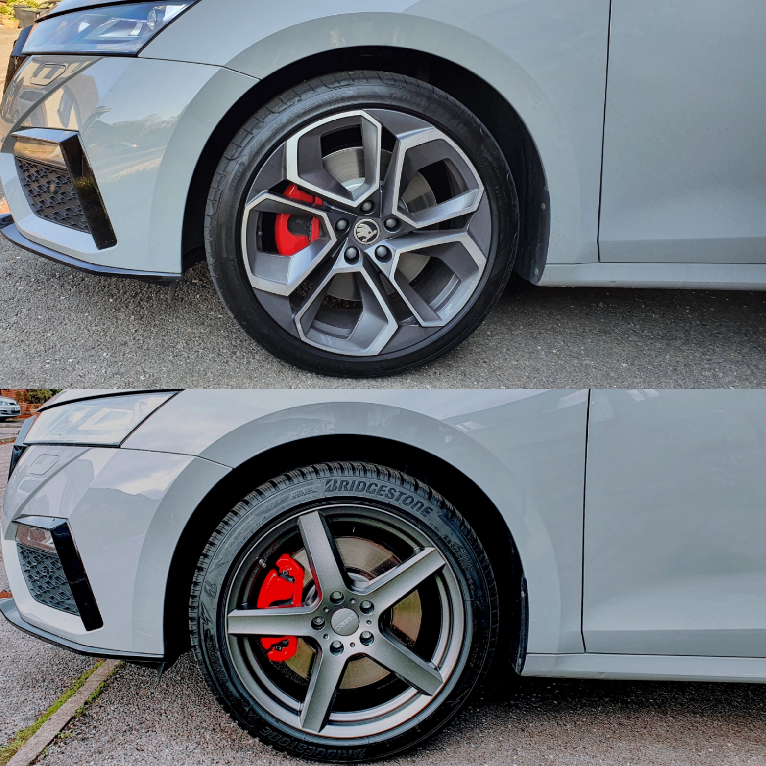

I've got 18" Dezent TR black for winter. Perhaps less weight than the original 19".

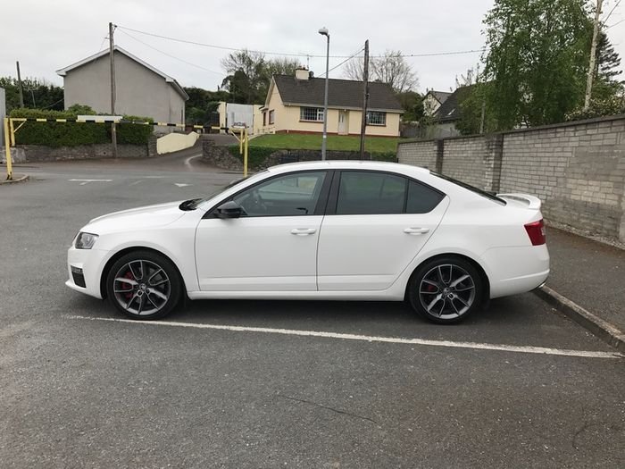

Also i really like the Skoda Gemini from mk3 RS, will they fit on mk4 RS ?

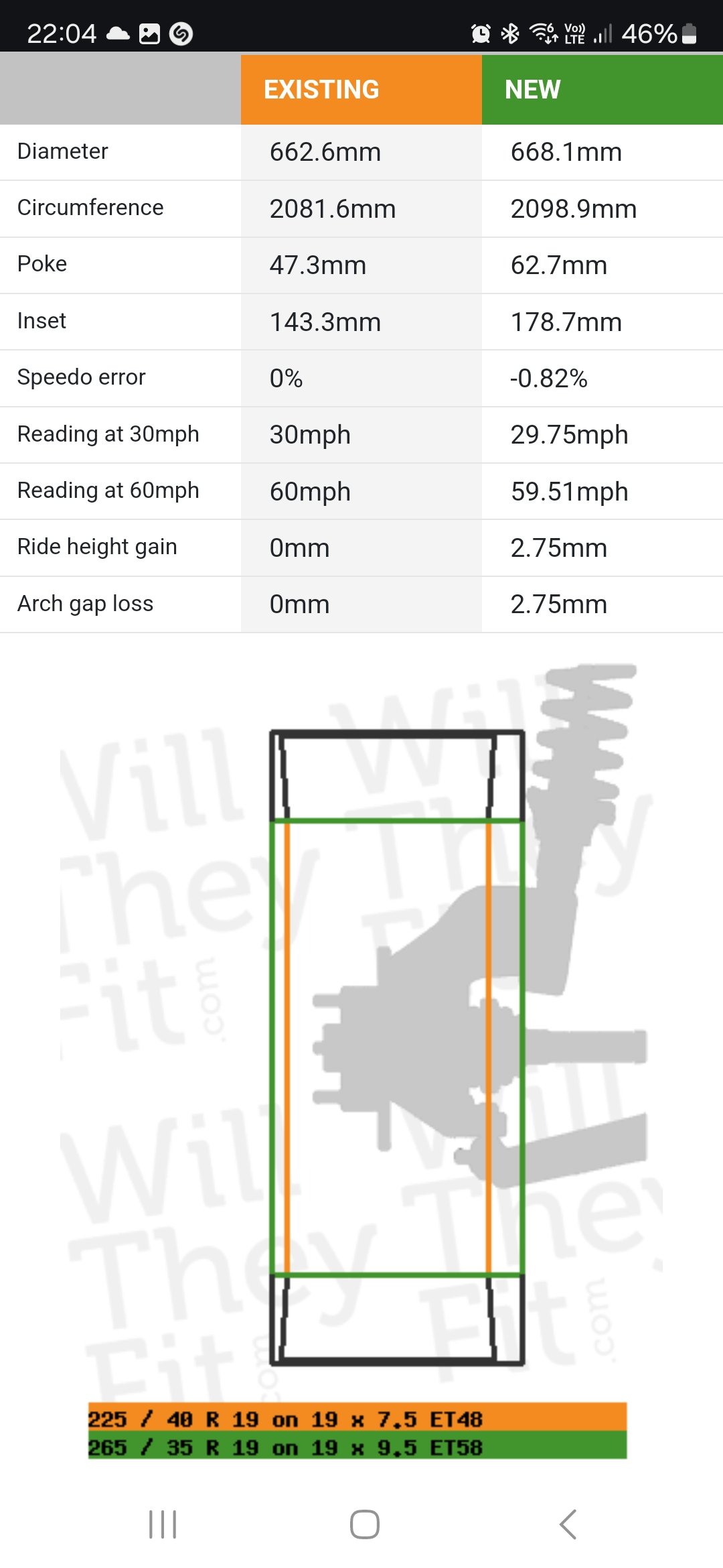

Has anyone used 19" x 9.5" wide wheels with 265/35/19 tyres on mk4 rs?
Planning to order some japan racing wheels with 58 et, theoretically should fit but any experience?
Currently running on stage2, so thats the reason for wider tyres
Edited by Kristo97
I really doubt you will be able to fit that size on Octavia without heavy modifications. ET58 is too large to fit. And then you also need to take into account that not all tires from different brands are the same width.
I currently have 235/40/19 and on et45 / 19" wheels and I had issues with tires rubbing the front inner arch liner. My car is lowered with KW coilovers. I had to lift the car for 5mm in the front.
