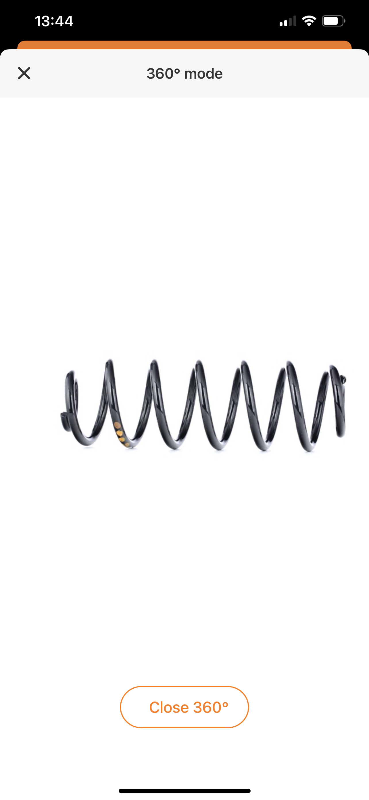

Just discovered I’ve got a broken coil spring 😤
After looking on here at a chart and going by colour code (WOOOBr) I’ve discovered 1KO 511 115 DE is the right coil springs ( I hope)

The third character in the OEM part number 1K0511115DE is the number zero, not a letter.
The build code 1JA means standard ride height.
Rear spring 1K0511115DE 1JA+0YE
(1) 1K0 511 115 DE coil spring
1 paint mark
3 paint marks
1 paint mark
rear
white
orange
brown
2 PR-0YE

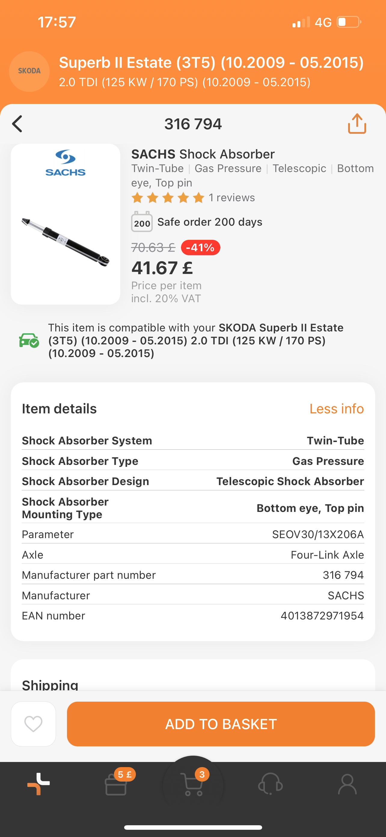

Rear shock absorber 3C0513049CP 1JA+0YE
(7) 3C0 513 049 CP gas shock absorber rear 2 PR-1JA,1JL+
0YE,0YF,0YG,
0YH,0YJ,0YK,
0YL

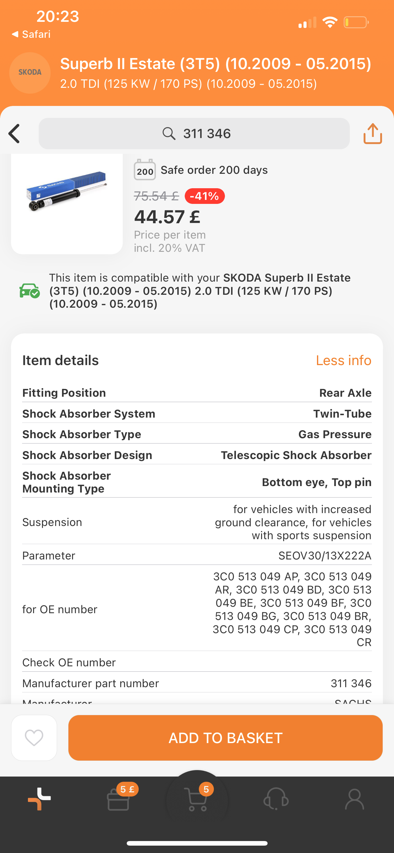

Sachs 311 346 are sold to replace 3C0513049CP, not Sachs 316 794.

You find a suitable shock absorber by searching for the OEM part number of your shock absorber, such as on autodoc.
Aftermarket shock absorbers will usually have a long list of OEM part numbers that they are being sold to replace. This means that it's unlikely to match your OEM shock absorber exactly, but that the manufacturer thinks that it's close enough.
Aftermarket shock absorbers often state that they are suitable for higher ride height, standard ride height, lowered/sports suspension. Don't take too much notice of these descriptions, because what's important is whether the shock absorber is sold to replace your OEM part number. So always check the list of OEM part numbers that are listed by the manufacturer for that particular shock absorber.

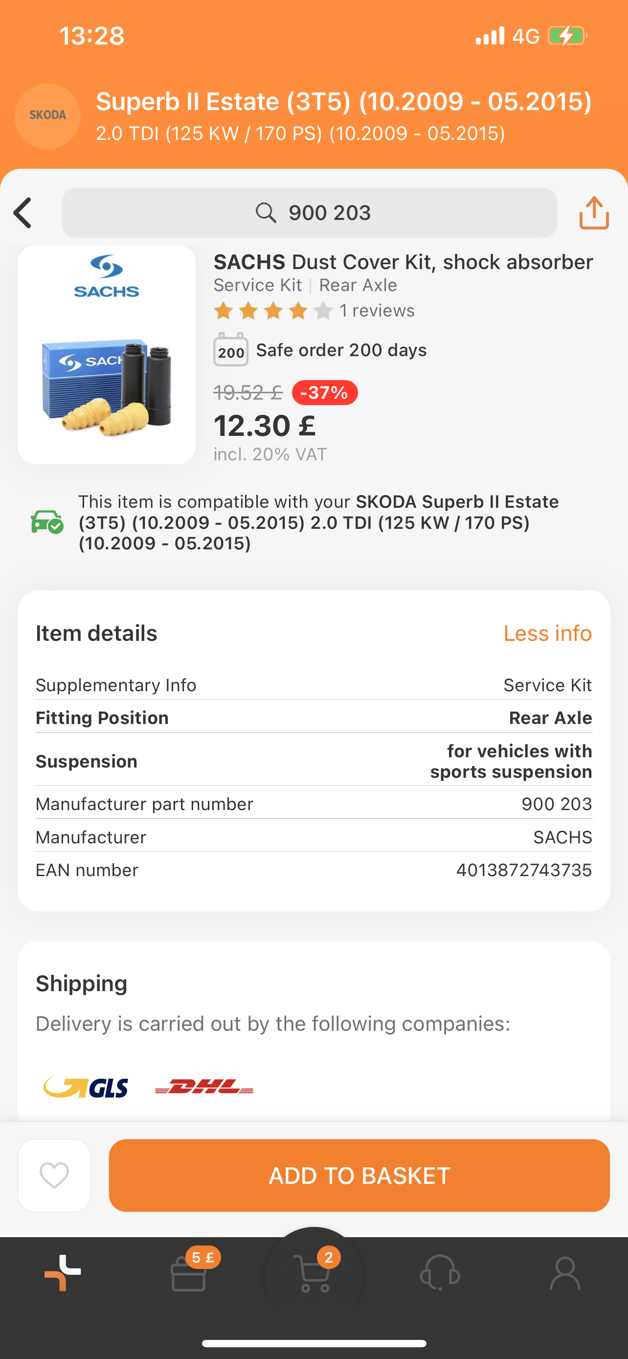

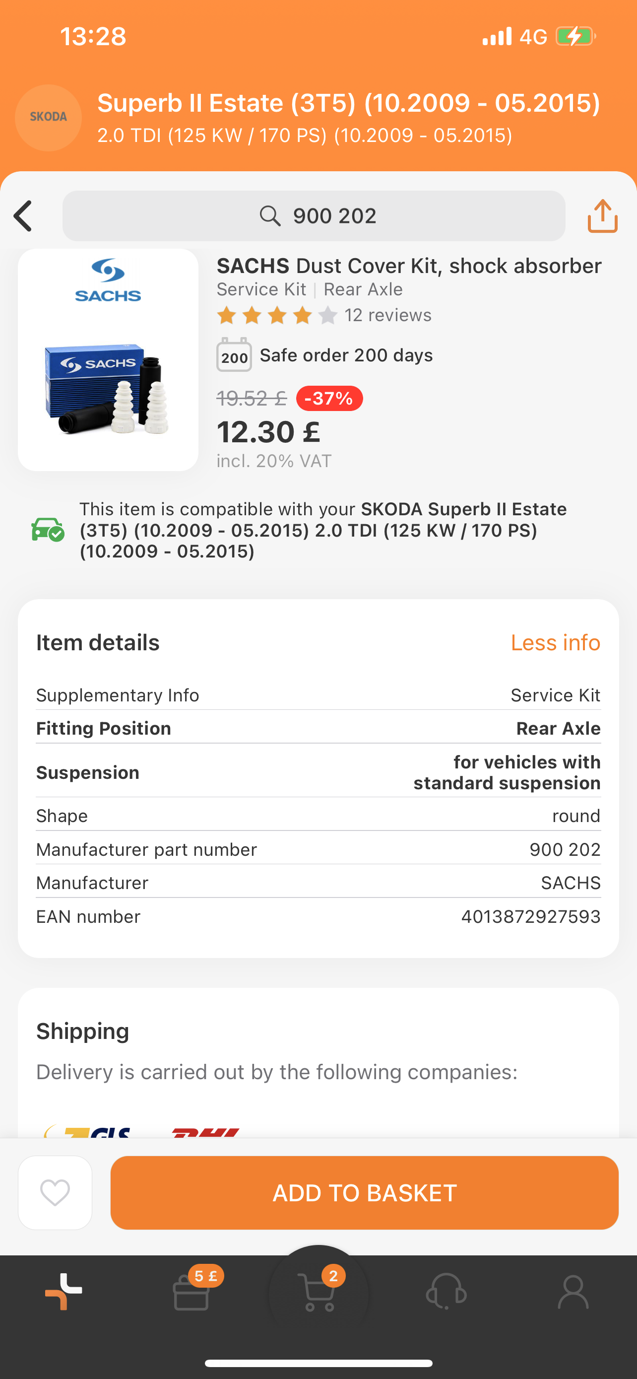

Hi again and after your help if possible
I’ve tried figuring out which of the kits in pictures I need to go with the rear dampers I have on order
The ones on mine seem to be the orange colour
Thanks again for your time and patience

Sachs 900202 is for standard suspension, so will be suitable for your standard ride height car. The two stop buffers in the kit should have a height of 133mm.
2 3C0 511 359 stop buffer 133MM 2
https://skoda.7zap.com/en/cz/superb/sup/2016-768/5/511-511000/
Sachs 900203 is for sports/lowered suspension, so won't be suitable for your standard ride height car. The two stop buffers in the kit should have a height of 118mm.
2 3C0 511 359 B stop buffer 118MM 2
https://skoda.7zap.com/en/cz/superb/sup/2016-768/5/511-511010/#2
