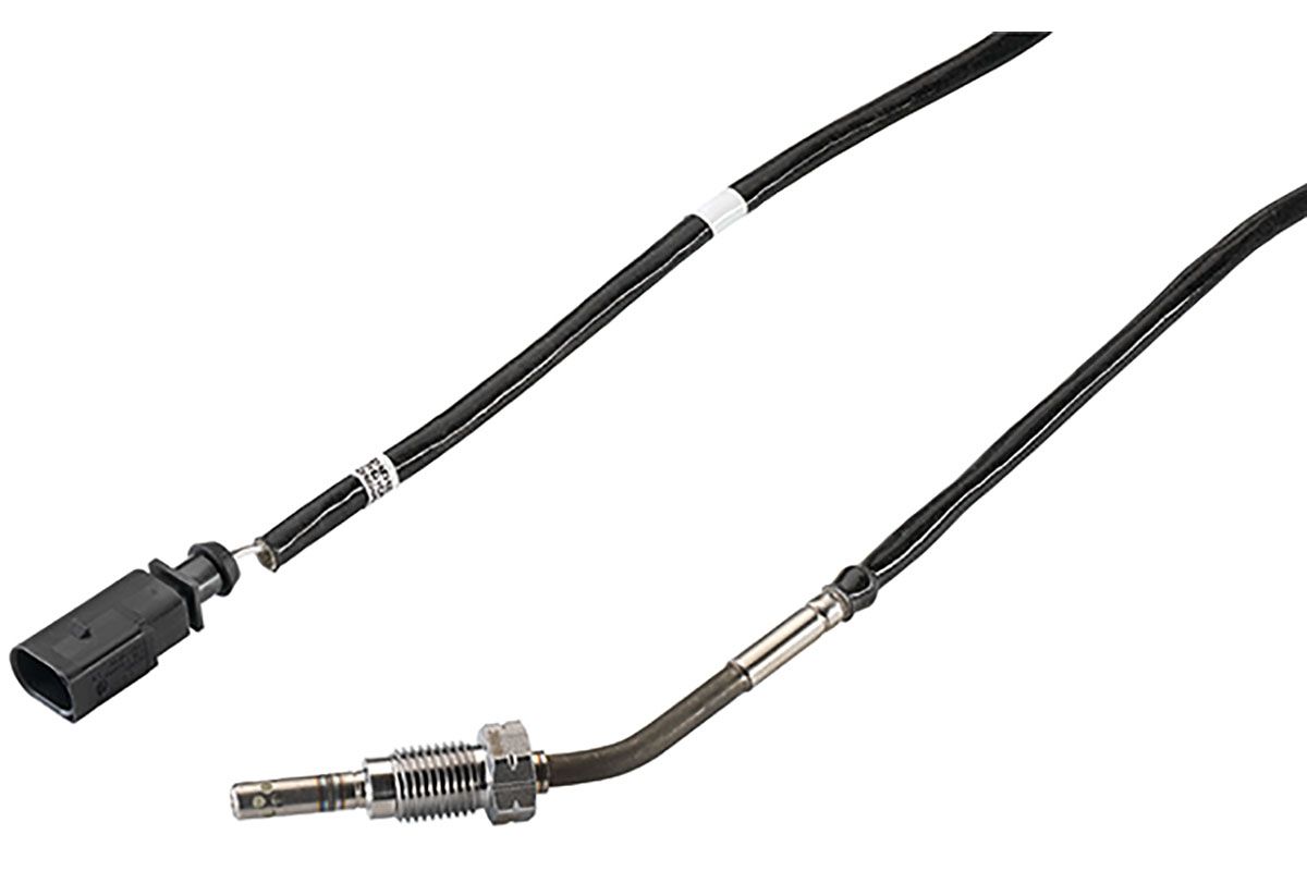

01348 (P0544)- Sensor 1 for Exhaust Temp Bank 1 (G235) - Circuit Malfunction
This is the EGT sensor in the exhaust manifold at the turbine inlet, VAG part number 03P 906 088 A and retailing at £179.23 at a Skoda main dealer. These are available aftermarket from reputable companies such as Bosch, VDO, Hella, NGK, Pierburg etc and a common failure.
5a5988923d917beb6989b656bfe0124536247a99.jpg?ver=3.47.0.1fc1c3429c

It is in the exhaust manifold before the turbo accessed from above.
