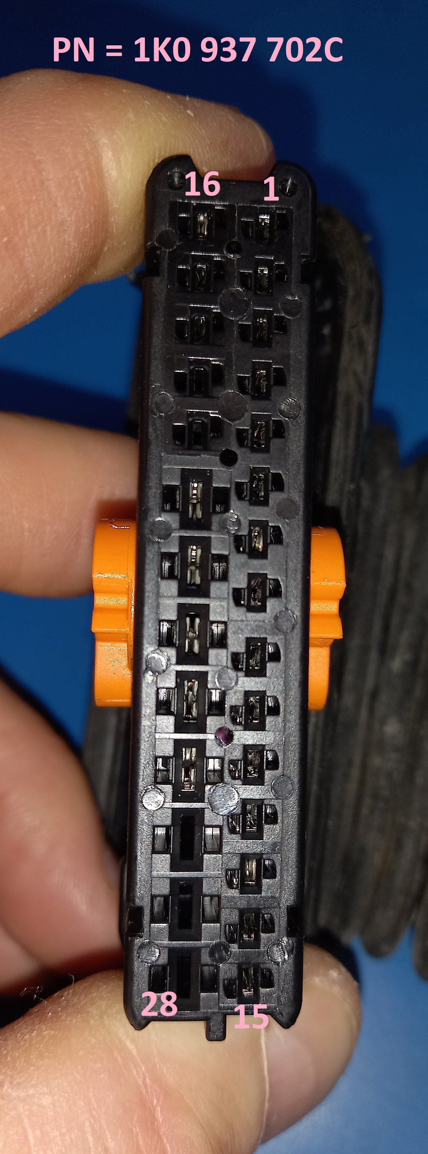

This is the pinout of the 28-way loom connector, viewed on the mating face

thank you this is what i was thinking just wanted to check is there a way to depin these connectors as i will need to depin pin 5 as its has a broken wire deep in the socket like somebody had yanked the wire out of the connector. 😞

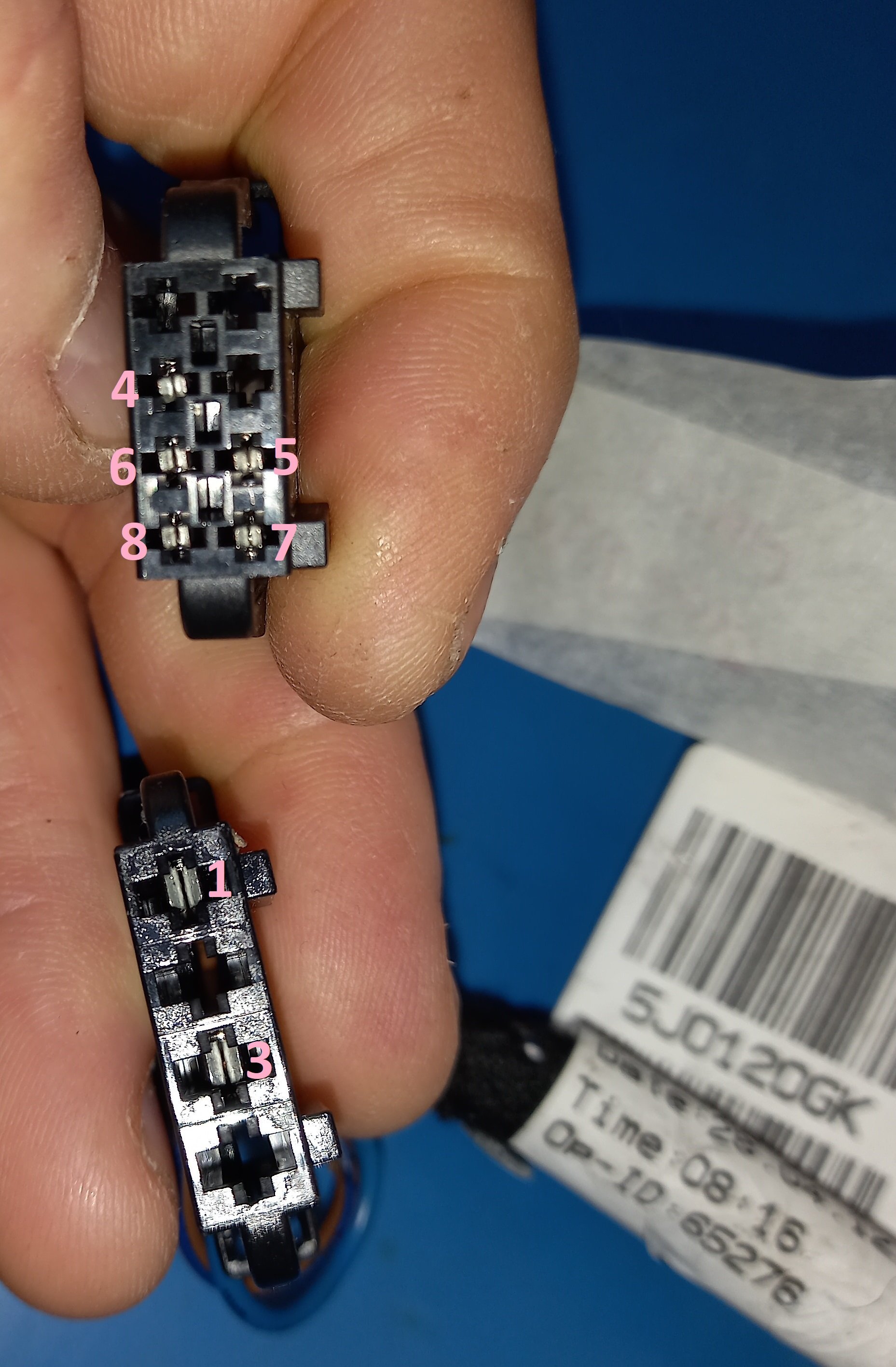

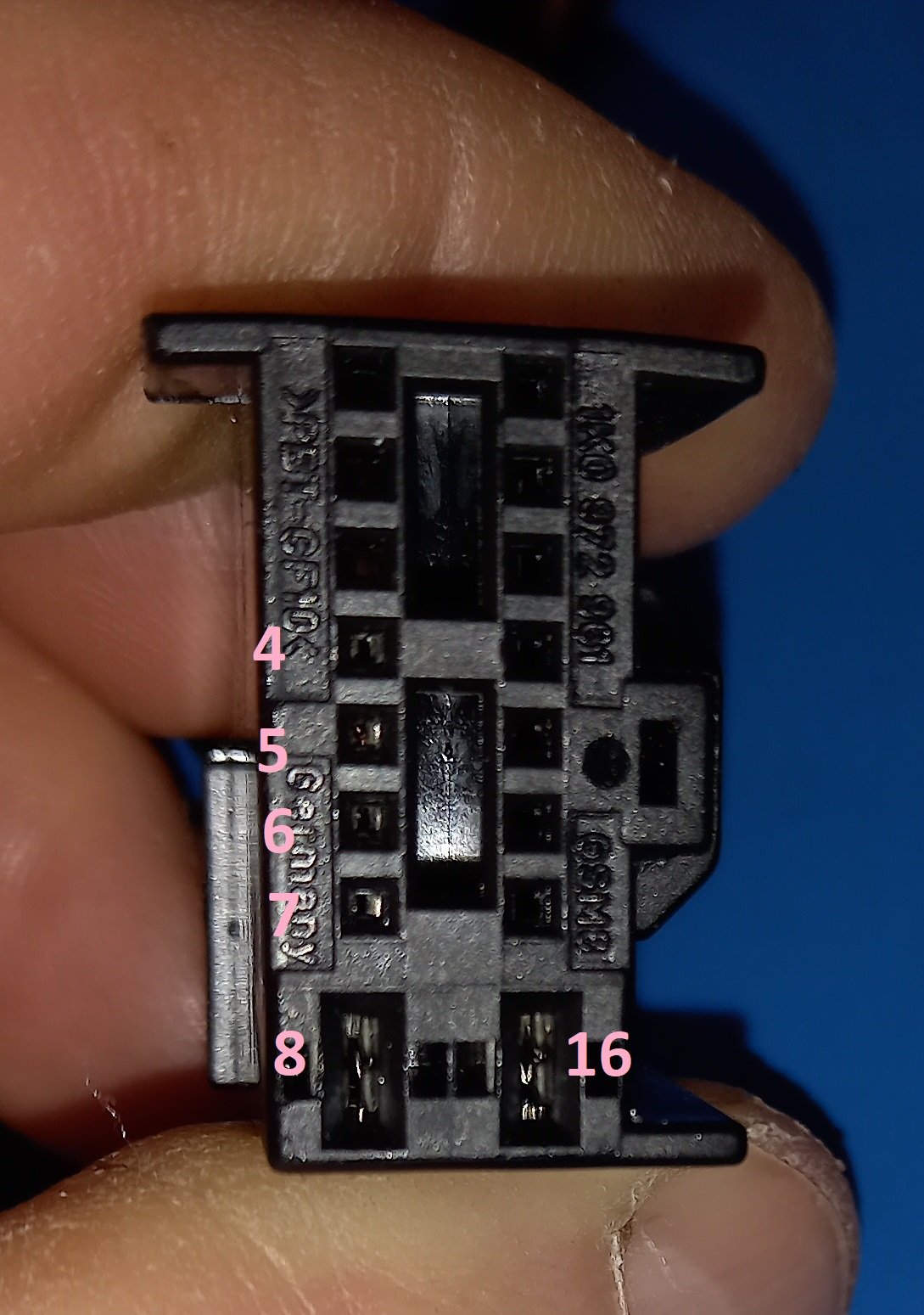

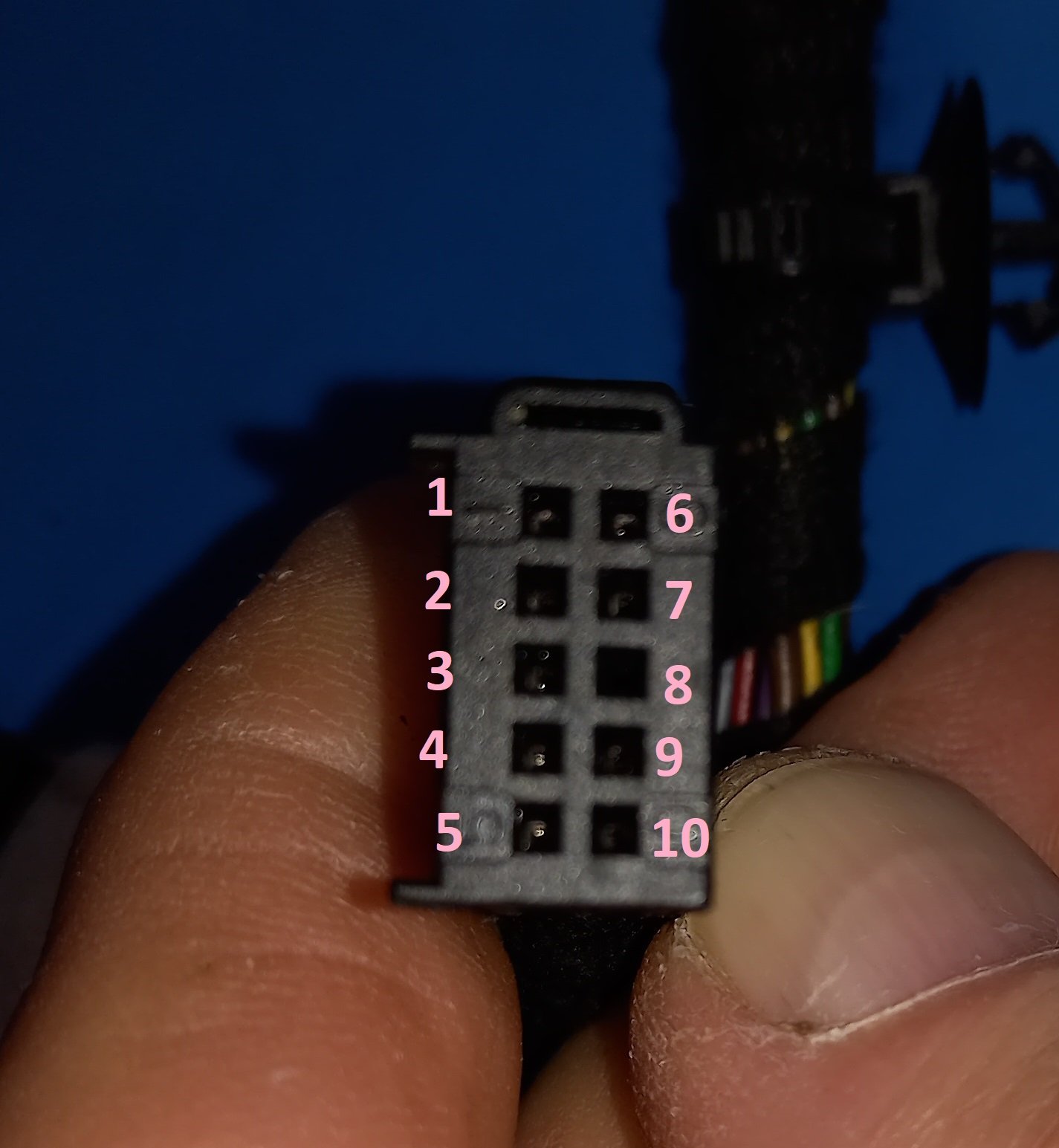

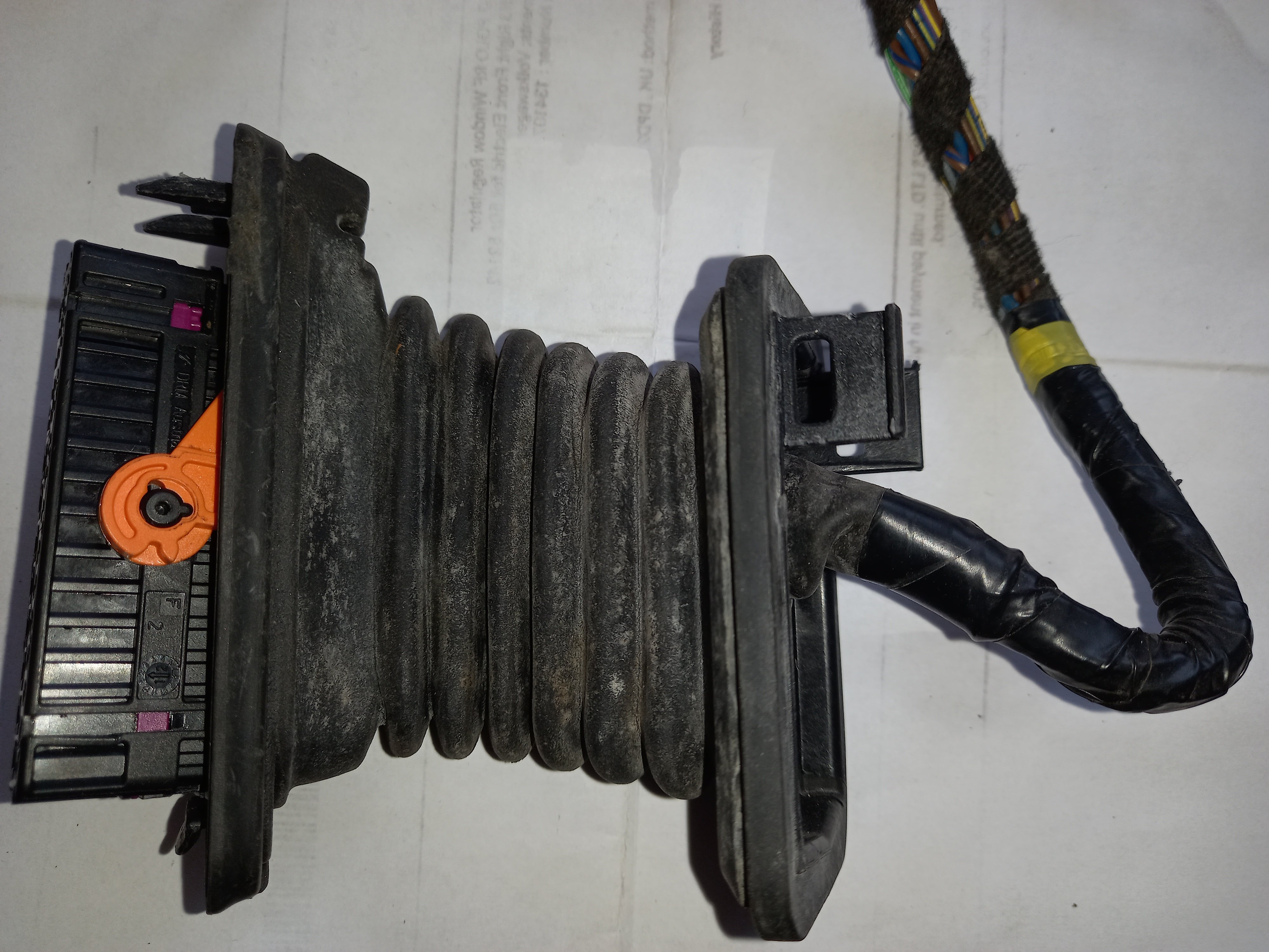

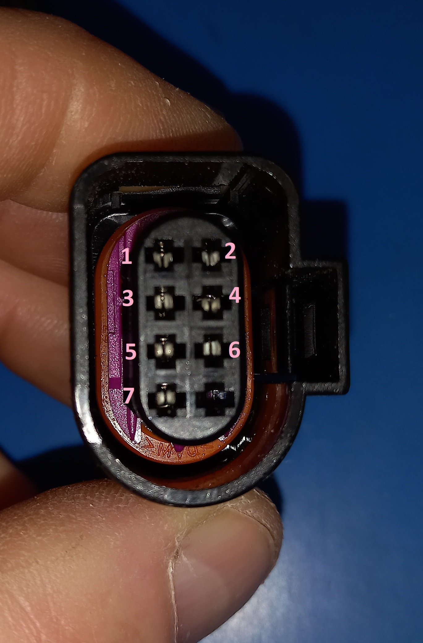

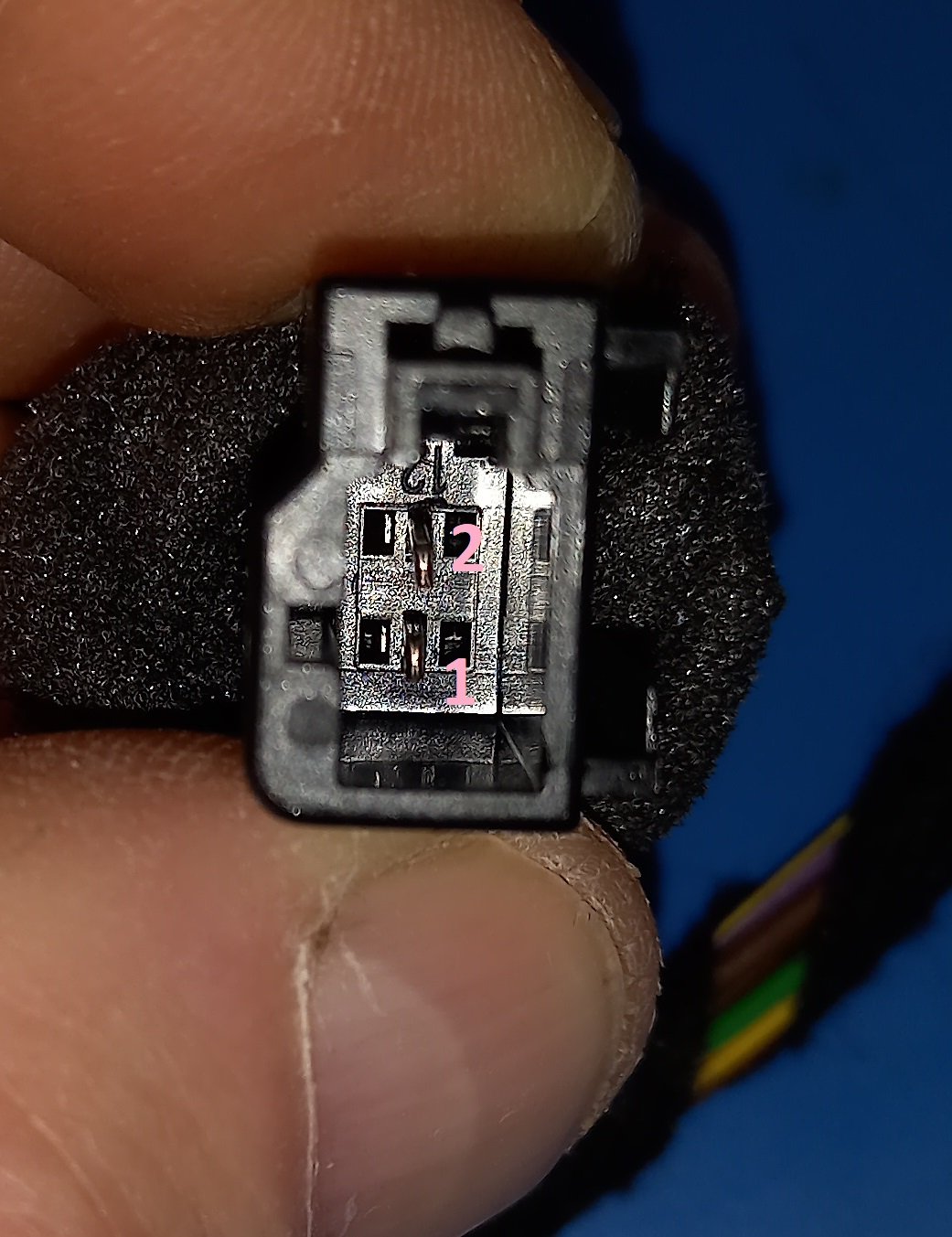

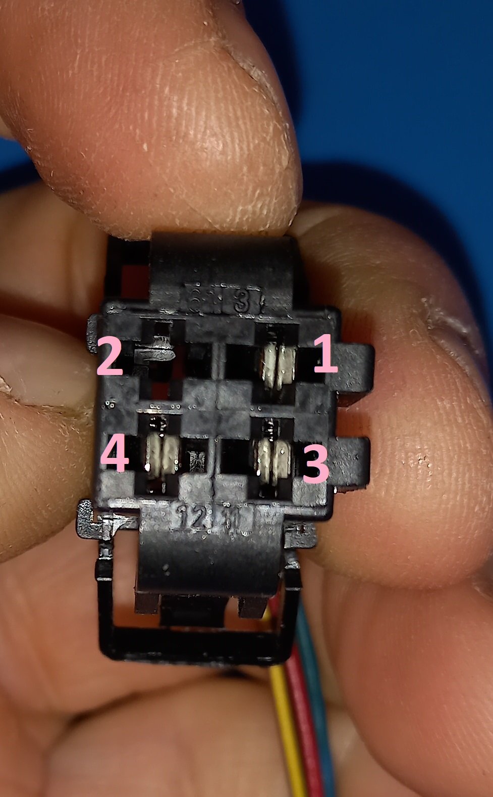

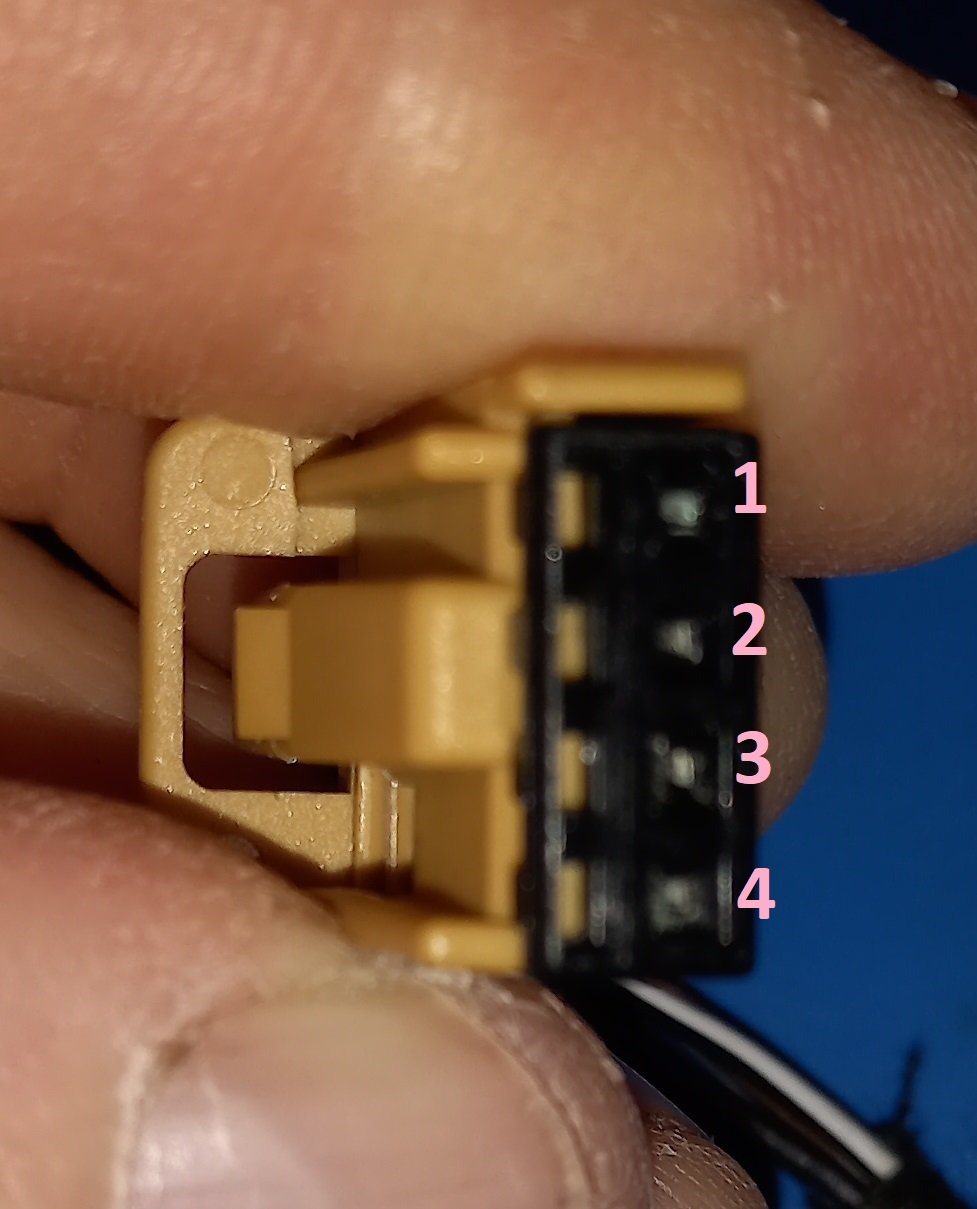

Not sure if it'll let me upload all the other pics at once, but here's my attempt:
They could do with labels saying what they are, which I'll add and try to harmonise with the written info when I get round to the proper how-to .
Be aware that if trying to buzz out with a multimeter, you're very likely to need a short piece of thin wire to poke into each connector 'pin' to ensure good contact with the multimeter probe, most of the orifices won't let a probe tip far enough in.
Yes, there's a purple plastic part that needs to slide one way to unlock all the pins, then you'll probably need a pin removal tool of some sort, not sure exactly which type suits, but generally a pair of stiff steel wires just the right distance apart to defeat the locking features of the crimp inserts.

The loom from which these photos and wiring tables was generated was part number  5J0971120GK (made in late April 2012); if yours is a different part number the tables shouldn't be relied on 100%.
