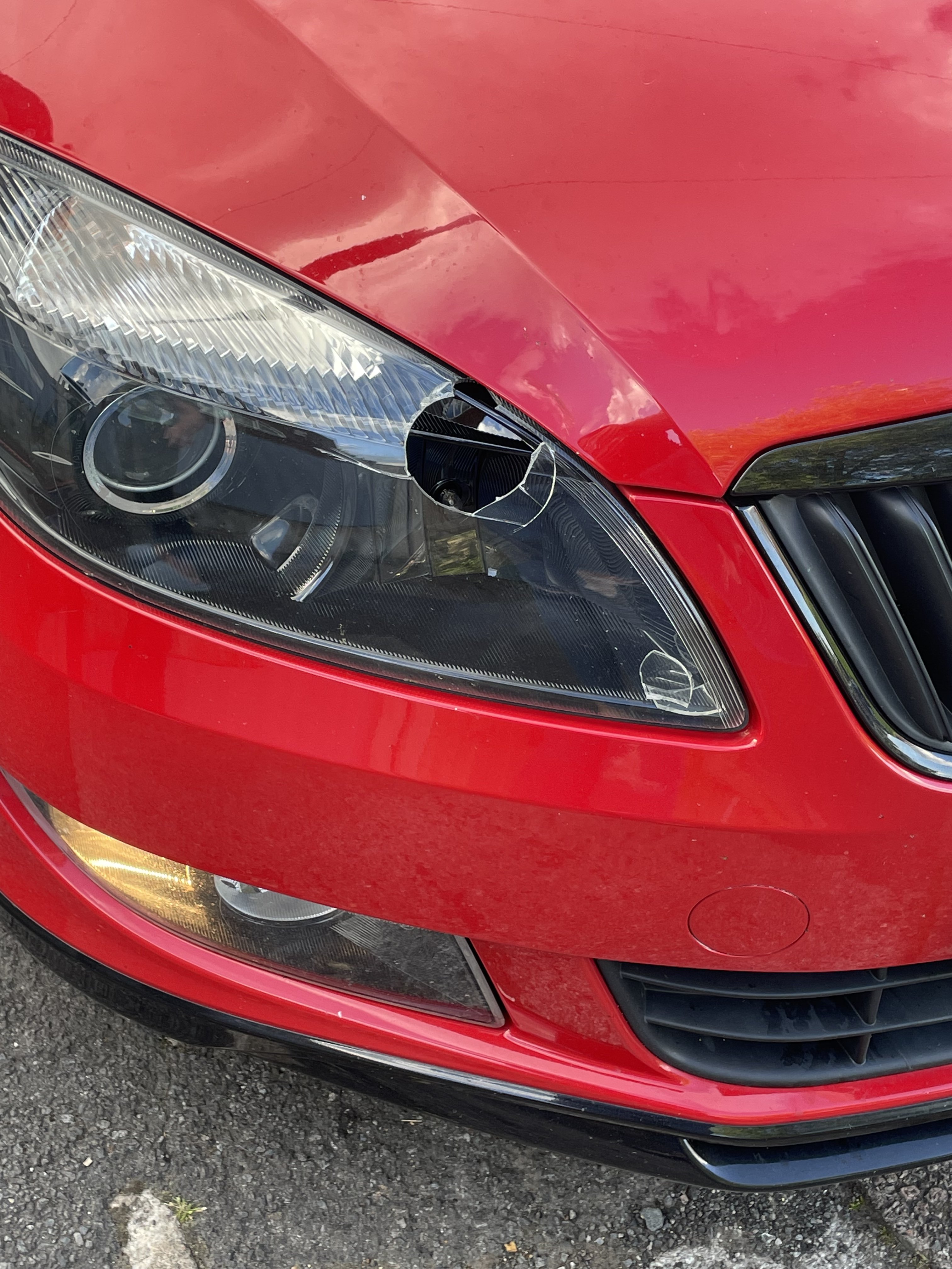

Something has smashed my headlight and I’m struggling to find a matching one
Would a Skoda fabia estate headlight fit on a fabia hatchback ?

I’m trying to find the same one as there is nothing wrong with the passenger side.

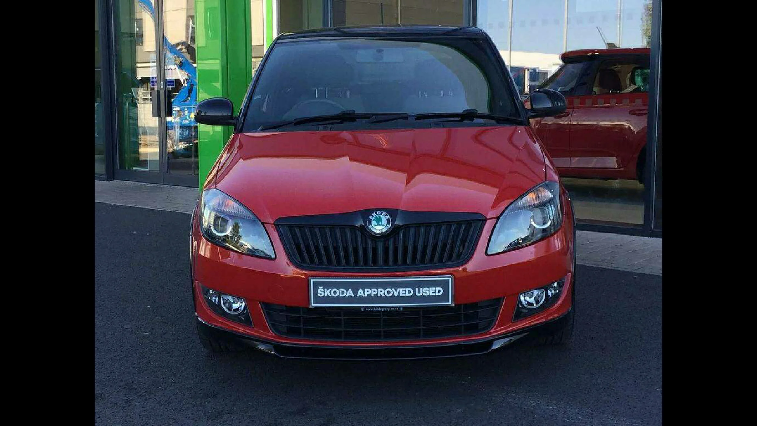

So is that clear glass and not Black Pack?
Monte owners might be along.  I take it that is the same as a Mk2 Fabia vRS clear glass, pre Face Lift.
Someone will know exactly which for your 2013 Monte.
A vRS Unit used will have Dummy Sidelight bulb in blue in it.

When I needed a passenger "black pack" headlight, ebay had one (and only 1) used one for £130 and he wouldn't go any lower, so I got a brand new one from autodoc. The discount changes day to day but I think I got 30% off.
£130 all in and just be patient for a couple of weeks.
FWIW I couldn't find a part number as it was on a sticker, and not embossed in the plastic, and the sticker was badly worn to the point of it just being a white space!
That ebay listing above is a steal!
PS The front end of a Fabia is exactly the same, changes from the back doors.
