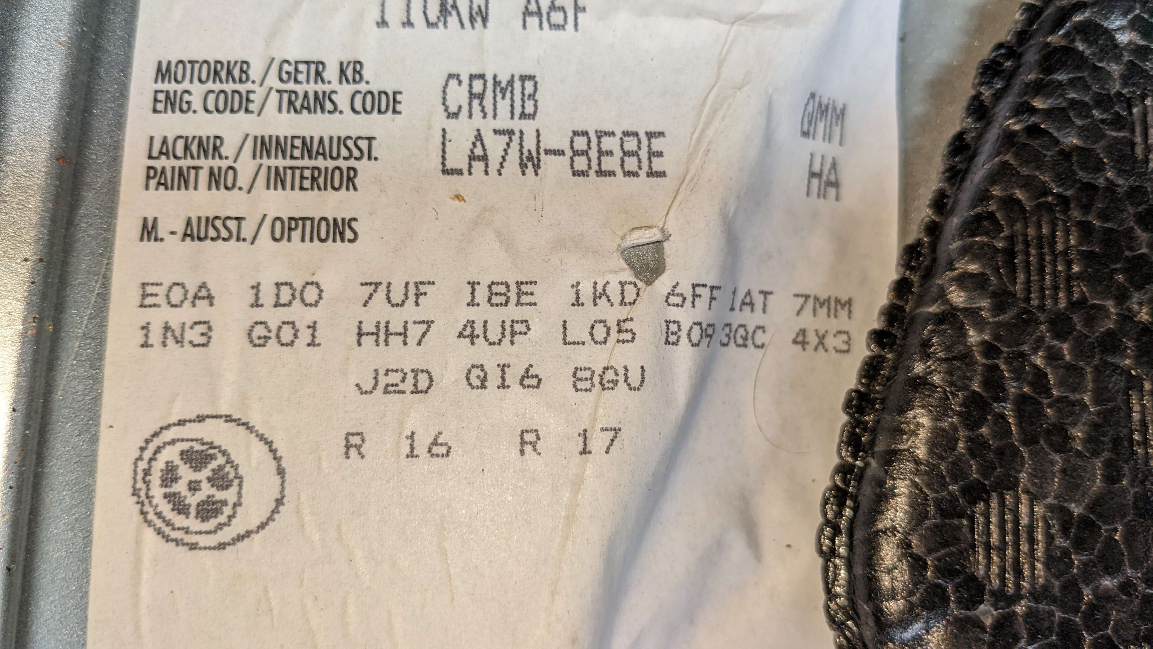

There is a paper sticker under the boot liner and should also be in the owners handbook that lists all the equipment codes for that car. One of those codes is for the electrics/harness needed for a tow bar if fitted. Im sure someone will come along with exact code shortly.

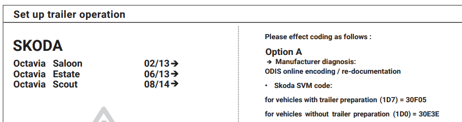

Quick search pulled up this from another thread.
"There will be a PR code for towbar prep on the sticker on the boot floor.
I think 1D0 is no towbar prep, 1D7 is towbar prep." and from a PDF from PJ Jones trailers i found this further confirming the coding:-)
My car has a Westfalia towbar (that I've never used lol) and my VCDS confirms that it's all been coded. Here is my boot sticker too. The coding can be done with VCDS or ODIS or OBD 11 i expect
It tells the car it has a trailer control module and also the ABS module is recoded to adjust the bias to the braking. If a DSG car then this also prevents the Eco mode from "Coasting" with the trailer hitched. (DSG coasting is where the gearbox is out of gear but not really  in neutral and a mere dab of the accelerator or brake put the autobox straight in gear again)

Factory trailer prep only adds the wiring loom to the rear quarter. As @PetrolDavesays. Once the module is added that's when coding is required to tell the car system to behave differently when trailer is attached, i.e it turns off the rear parking sensors.
