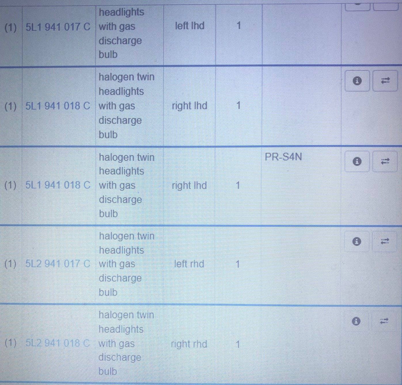

my right light has 5L2 941 016B 10s.
the left has 5L1 941 017C 12s.
       The left one appears to be Left Hand Drive.
Can anybody out there confirm that for me please ?
The garage are correct.
The 5L1 vs 5L2 is the LHD/RHD thing. I imagine someone needed a replacement and bought a more available, cheaper version from abroad 🤔
Exactly what I thought..
    Thanks.
Do you have that for xenon lights ?
That link is for the Xenon lights in the description it says "Gas Discharge lamp"
You can see the 5L1 is for LHD & 5L2 for RHD
Ah yes , I see what you mean.
