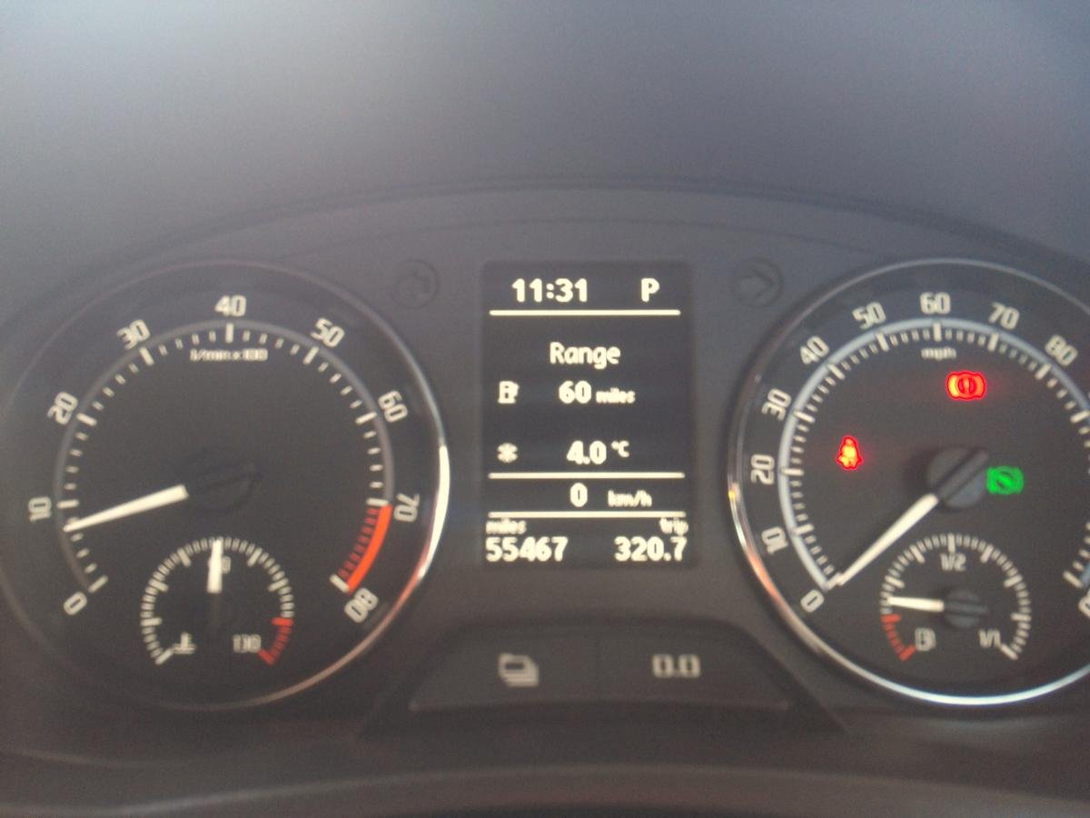

Is the outside temperature indication working?
Mine was when the picture was taken and there was 10 litres of petrol in container in the boot.
