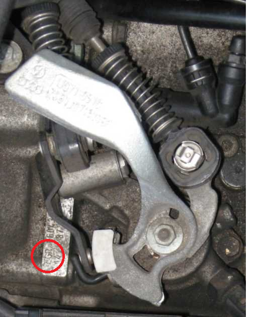

You do not say what year your car is ? but for a 2011 1Z5 with CCZA the drive gearbox codes listed are:- KPV, LQZ, LTL, MMA, MSY, NJL, NLR & PBH all 02ED series gearboxes
If you want to physically check which gearbox is fitted look at the stamped code by the shifter lever.
