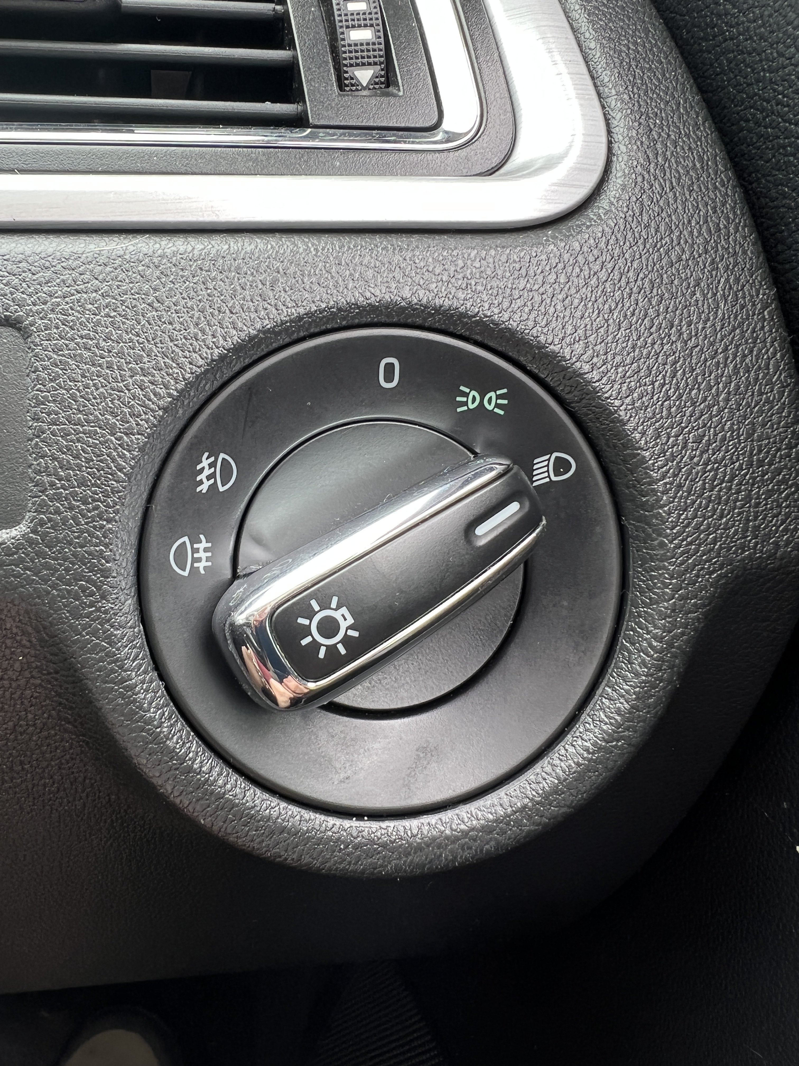

Okay will try replacing them next. The holders do look fine for the number plate. I have maybe noticed something. On the light switch itself when I turn the lights on only the sidelight light illumination comes on the actual switch. I noticed when the fuse went yesterday the actual light on the bit you turned came on. How should the lights on the switch work? I will put a photo up to show you. F6A52709-D967-4FEE-BBAC-30D88947330D.thumb.jpeg.828844b90cec6ee5bf6e4b9d2677f7c4.jpeg
I’m wrong they do illuminate just very dull. Well replaced the number plate bulbs and checked cables I can see and housing and all looked fine but still blowing fuse. So I guess the last thing the fuse covers is switch illumination. So I guess try a new switch and if that doesn’t work then garage? Any idea on cheapest place to buy the switch? The only ones I can find with the code 5JA941531F is used on eBay.

Yes, the headlight marking on the switch hardly lights up at all.

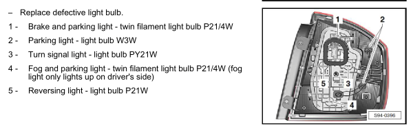

Don't forget the rear sidelights as parts of your checks.
Three bulbs in each rear cluster are part of the sidelight circuit

I didn’t think of the rear ones. As I’m taking it off I’ll just replace all the bulbs. Reading that diagram. I’ll need 2x p21/4w and 2x w3w bulbs.

I didn’t think of the rear ones. As I’m taking it off I’ll just replace all the bulbs. Reading that diagram. I’ll need 2x p21/4w and 2x w3w bulbs for each side
