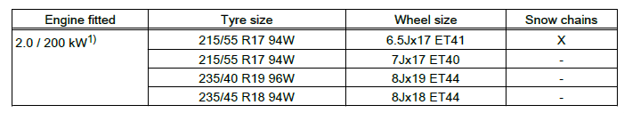

Had a look at the forum, but can;t see. What is the correct load and speed rating for 235/45/18 fitted to a 280 estate?
Think 98W?
Edited by coppertop
additional wording
This is all the information I can find, someone else should confirm the values, but look correct to me
