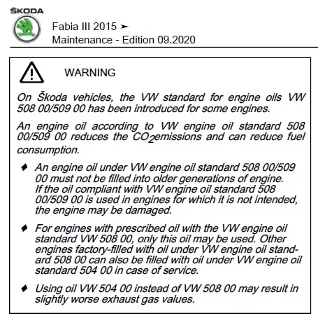

The actual specification for a 2019 1.5 TSI was VW508 00 / 509 00 so 0w 20 FS IV.
But you are fine with the VW 504 00 / 507 00 5w 30 FS III which was the spec previously pre WLTP approvals.

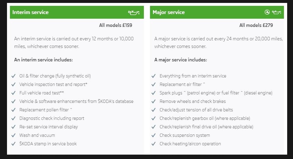

What is a full service?
  They were called Minor, Interim & Major if on a Fixed Service Regime and the 2nd year service was the same as a minor other than the pollen filter. Variable, Major Major)
An Interim Service at 1 year or 2 yeaes was fine and year 2 might be called a Major or Full Service by staff at a dealers it is a Oil & Inspection service now,
year 1 and year 2 and Extended Scope @ 3 years then each 2 sometimes.   It was the 4th Service that was supposed to be a Major.
Things like Brake Fluid, Pollen, Air Filter, Spark Plugs are all charged as extras.

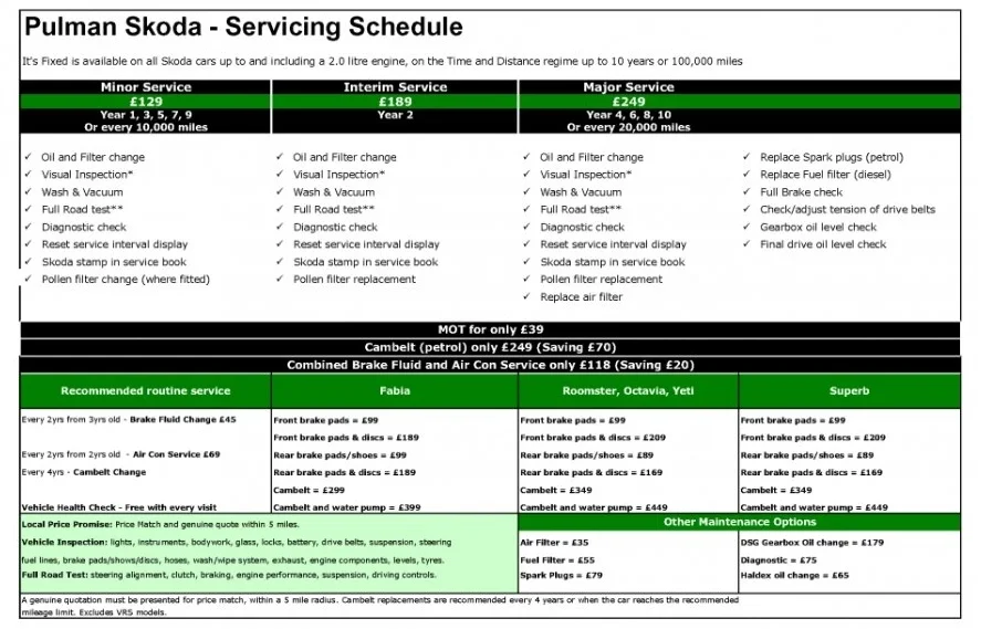

How it used to be when it was Servicing & Maintenance and fixed prices.  Sadly not made clear by every Dealership or Service Department to paying customer.
It still did not guarantee that by paying the higher priced services that the parts were actually changed, they could take the money and decide no Spark Plugs this time or Air Filter that will be in another 2 years but we take the fixed price anyway.
