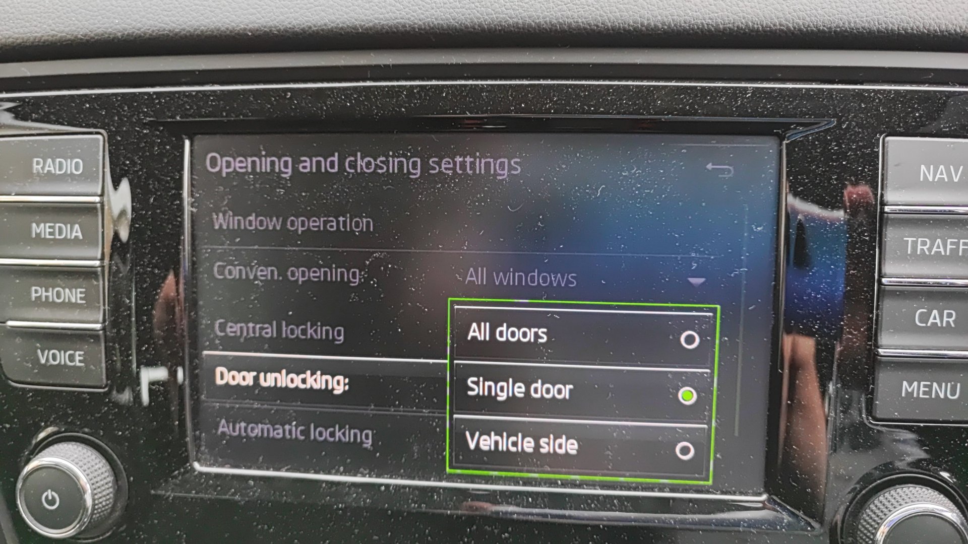

R/h drive Superb estate 2017. Wanted to have drivers door and rear o/s door to unlock on one push on fob (not Kessy) but never does this even though programmed. This is one of a few options on how the doors unlock and shown as “side” . Have to double push and then rear door opens, just inconvenient, anyone know why seeing as rear door solenoid is working.
I thought that only ever opened the driver door only, never the whole side of the car.
It’s on page 66 of the user manual …. Individual settings > doors on a vehicle side gives access to both doors on driver side and fuel filler flap, strange that rear door on that side works perfectly on a double press, but not on a single press.
Good find, I have always seem to have it one door only (single)
3 choices I can think of
Coding wrong (maybe here is where answer is)
Manual wrong
Rear door fault (but yes opens with double press)
Ok found it, my bad memory.
